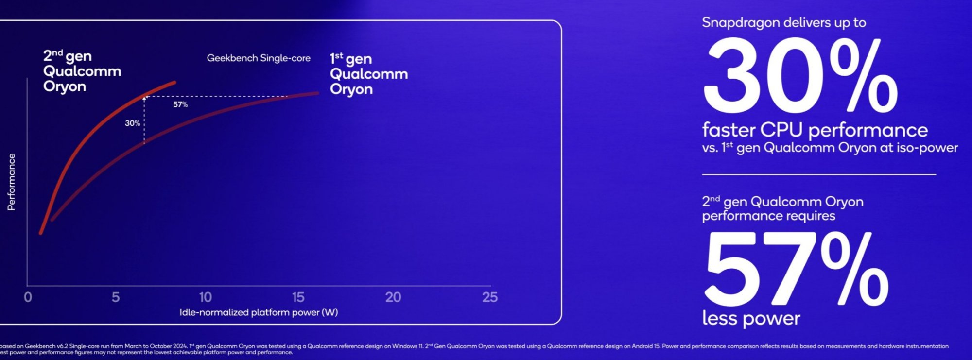

Qualcomm is advertising the Oryon CPU in 8 Elite as 2nd gen. (X Elite has 1st gen Oryon CPU).
During the announcement event, they said that "The 2nd generation Oryon CPU is redesigned from the ground-up for mobile".
There is roughly 2x efficiency uplift from 1st Gen Oryon CPU (X Elite) -> 2nd gen Oryon CPU (8 Elite).
The process node upgrade N4P -> N3E alone cannot explain this huge uplift. It suggests that they made design changes too.

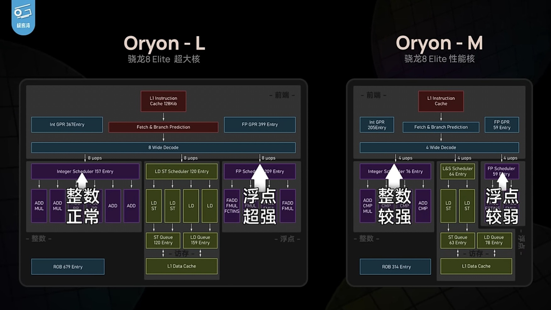

Indeed, Geekerwan found exactly that;
Compared to Oryon (X Elite), Oryon-L (8 Elite) has several microarchitectural differences;
SoCX Elite8 Elite
P-coreOryonOryon-L
L1i192 KB128 KB
ROB entries650679
INT scheduler entries120157
FP scheduler entries192209
These numbers are taken from Geekerwan'a video. Highly recommended to watch (it has English subtitles).

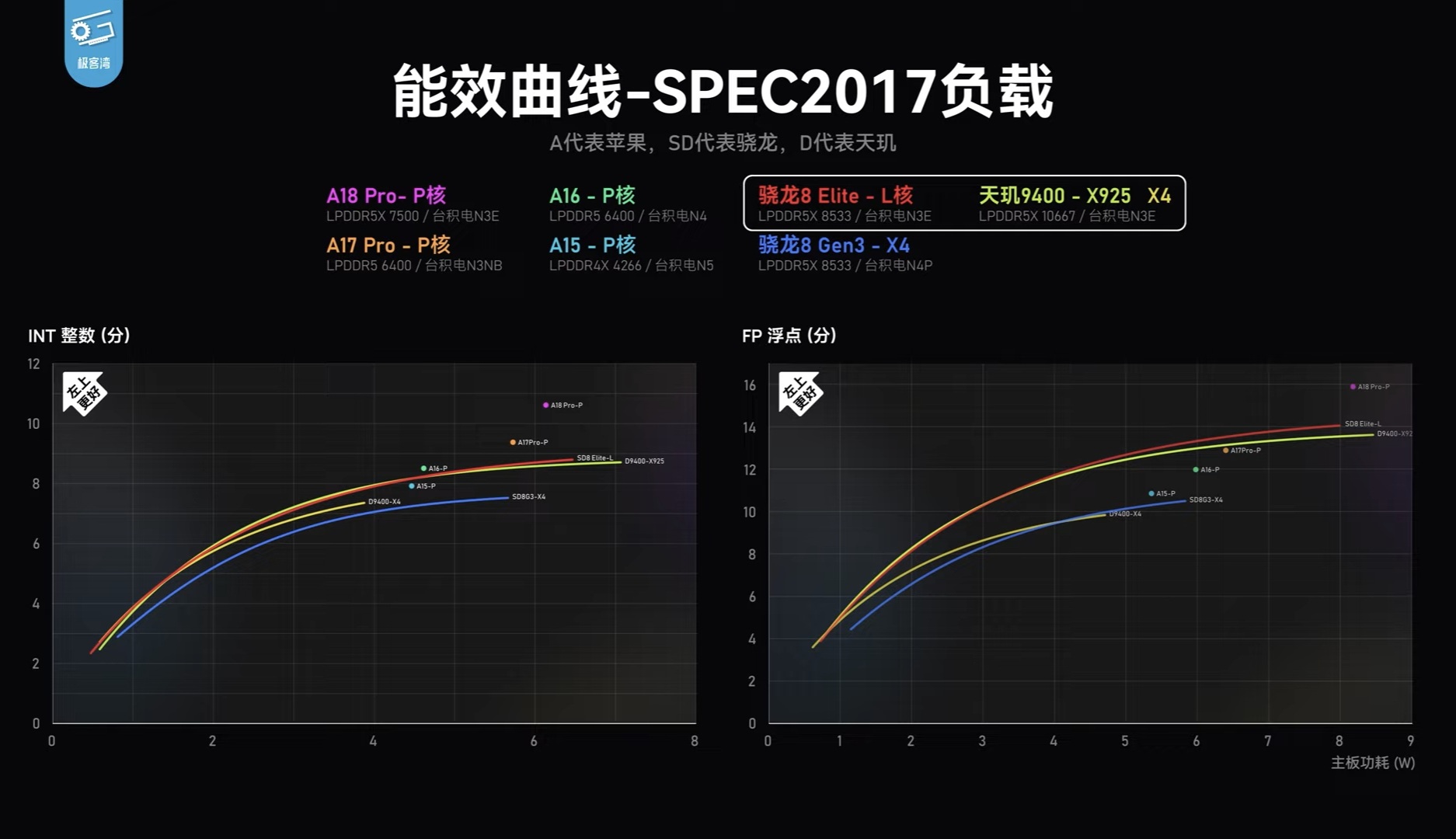

If anyone has specINT for the SD8G4 L-core from a reputable source like Geekerwan (not some QC marketing shill) please post it. I'm especially interested to se how that sub-bench stacks up against the M4.
From the Geekerwan video I referenced;
P-core SPEC INT/FP comparison
Efficiency wise in SPEC2017INT, the 8 Elite is between Apple A15 and A16. In FP, the 8 Elite is between A17 Pro and A18 Pro.

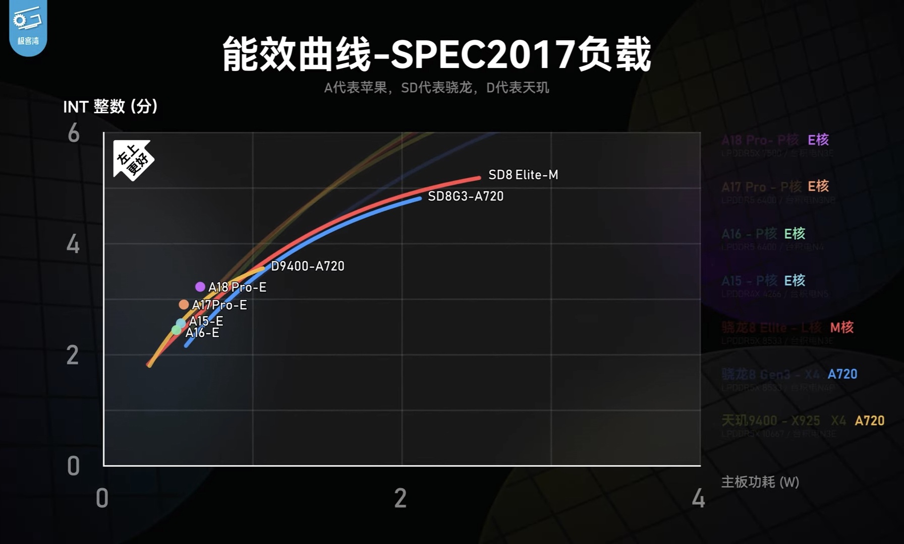

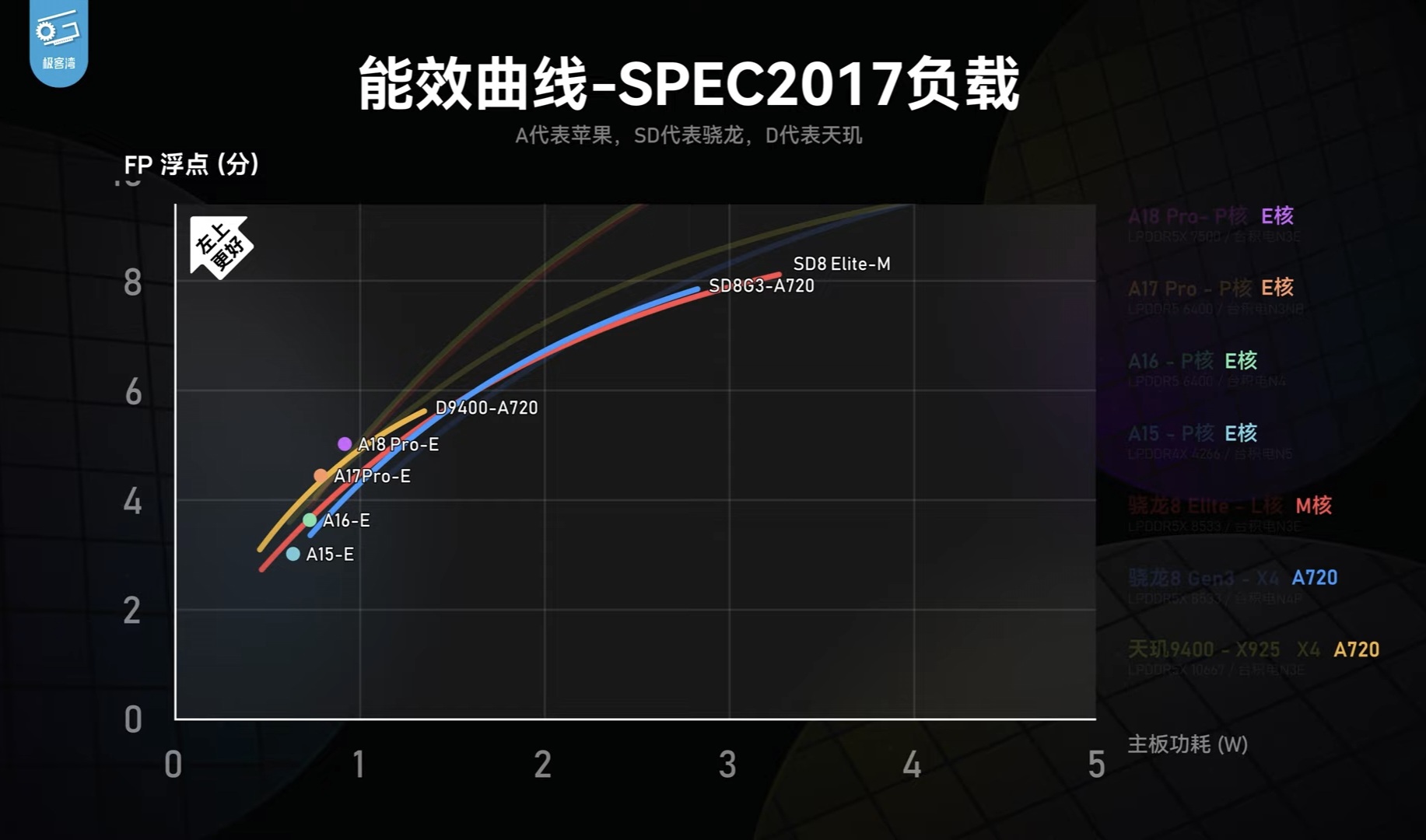

E-core SPEC INT/FP comparison;
It is clear why Qualcomm is advertising the Oryon-M cores as "performance cores" in the marketing materials. Unlike the efficiency cores of A18 Pro (A18-E 2.2 GHz) or Dimensity 9400 (2.4 GHz Cortex A720), the Oryon-M core scales upto higher clock speeds, higher performance, and higher power consumption levels.
At iso-power vs the A18-E, Oryon-M is quite close in terms of efficiency, particularly in FP.

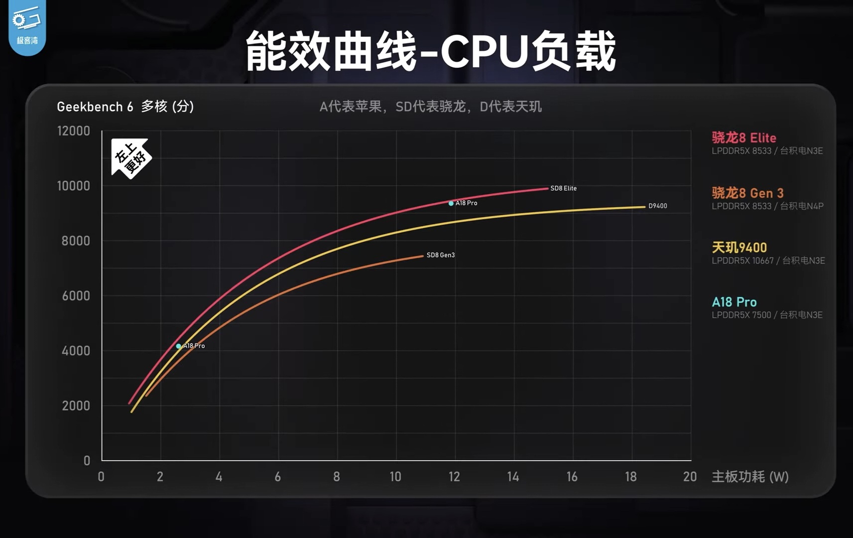

Geekbench 6 Multi-core;
The 8 Elite's efficiency is bit better than A18 Pro at the low power point, and equal at the high power point.

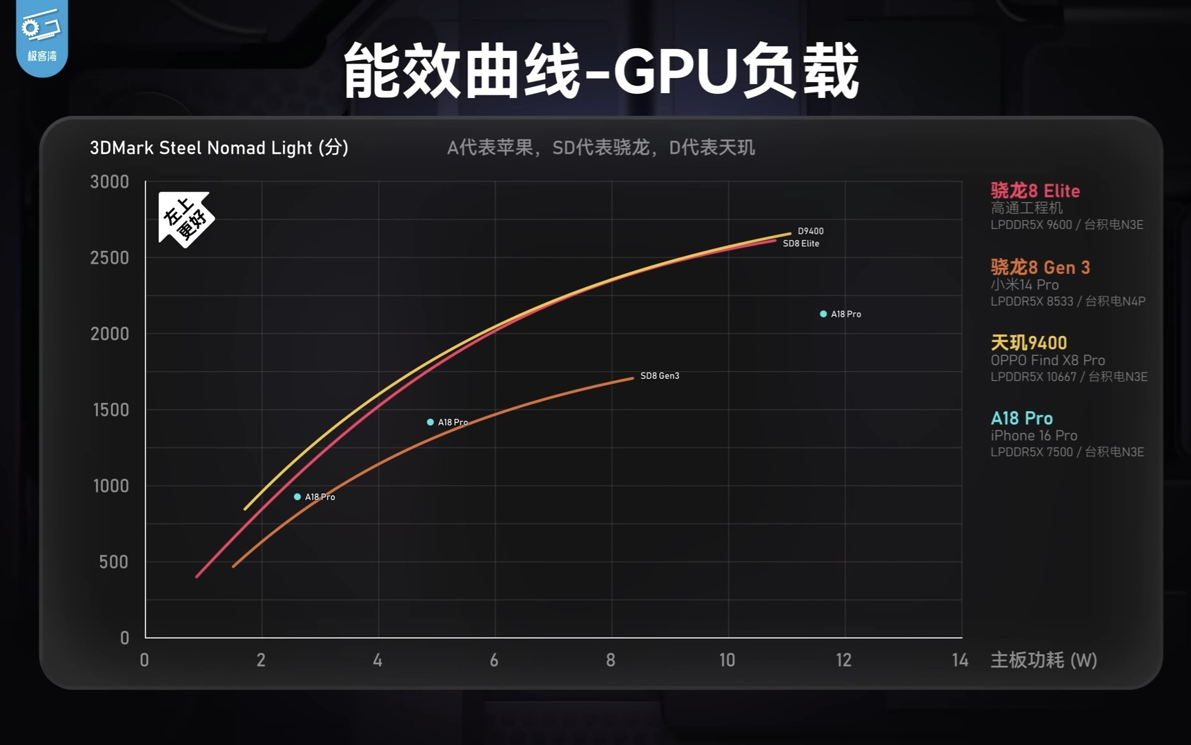

GPU efficiency (3D Mark Steel Nomad Light);
Right. Not caught up yet. Though if they implement a good SME unit they will make up a lot of ground.
That's impressive, compared to everything non-Apple.
I don't think I would characterize the M as "close" to the A18 E-core. However, the O-M core can apparently ~double performance at a cost of quadrupling power. I don't think anyone knows what Apple's E core can do if you feed it 4x more power, but it's academic as we don't have that option, AFAIK.
This lines up perfectly with the other data.
Unfortunately, this doesn't really tell us much - we already know the QC GPU has more basic crunch than the A18. What would be really interesting is a cross-platform benchmark that is optimized for both Android and iOS, that displays the same quality/level of detail on both platforms (unlike most major games, which do more work on iOS), that uses the GPU like a major game title would. I'd also like to see some GPU compute benchmarks.
Oops. Crap. Aside from the minor spelling error, I left out what subtest I was interested in. It's the compiler test. Very curious to know how that compares to the A18pro.

SPEC2017 doesn't use SME. It's Geekbench 6.3 that uses SME.
8 EliteA18 ProA18
Advantage
SPEC2017 INT8.910.8~20%
SPEC 2017 FP14.016.0~15%
Geekbench 6.3 ST32003600~12%
There is a disparity - the gap between 8 Elite and A18 Pro is larger in SPEC2017 than in Geekbench 6.3, when it should be the other way around! After all, A18 Pro has SME whereas 8 Elite does not, and Geekbench 6.3 does utilise SME. So shouldn't A18 Pro beat 8 Elite by a larger margin in Geekbench 6.3 ?
The following information comes from a Qualcomm engineer:
"Geekerwan's using NDK binaries on SPEC for Android which will have an inherent handicap vs iOS shared runtime libraries
it's fine given that this represents the userspace experiences between the OS', however if you would really want to look at just µarch you'd deploy glibc+jemalloc binaries on Android get get somewhat of a similar allocator behavior to what iOS does in which case the competitive performance differences here are going to be fundamentally smaller
Geekbench difference is smaller because of the way it's built counteracts some of these differences at the moment, and actually if you run 6.2 (non-SME) that's probably as close as you can reasonable get for a 1:1 µarch comparison"
This is Steel Nomad Light, a more modern, more complex and compute-heavy benchmark than Wildlife Extreme or GFXBench Aztec Ruins.
Also the Snapdragon 8 Elite upgrades to a new GPU architecture: Adreno 8 series. It should be an improvement over previous generations in that regard.
Of course. I didn't say spec would go faster. GB is a significant figure of merit, for better and for worse, and they'll do better on that with SME.
There is a disparity - the gap between 8 Elite and A18 Pro is larger in SPEC2017 than in Geekbench 6.3[...]
Yes, it was well known that SXE (and now SD8) underperform on spec. The explanation you provided is quite interesting.
My understanding, which is not nearly as good here as for CPU, is that that is still relatively low-complexity compared to what high-end games may do, much less GPGPU stuff.
As far as I can tell Steel Nomad Light is the equivalent to Steel Nomad, just rendered at 1440P instead of 4K. They designed the test to not be CPU limited (where Apple would have a clear advantage). If anything I think the test is GPU memory bandwidth sensitive (I get better scores upping my vram speeds on Windows than upping my GPU clock).
