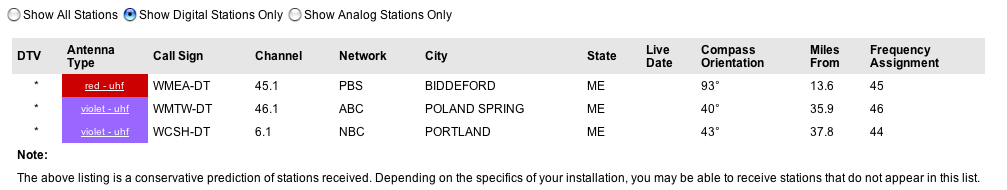

There are NO digital channels broadcasting OTA in my area.... none. So I don't see how a pair of bunny ears are gonna help me. Is antennaweb.org really accurate?
antennaweb.org said you had NBC and ABC digital channels at the zip you provided....
Hmmm.... I didn't see any.... I actually typed in my entire address to get a better pinpoint report. I'll look up the straight zip code and see what happens.
EDIT: Looks like I need a huge antenna to get NBC and ABC. I'm just about ready to give up on it all together.
