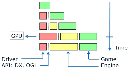

The whole closer to the Metal thing means that the driver itself is more simple. It is easier to write this drivers and they will perform well. Basically all the need for optimizations with these APIs moves to the 3d engine code. It is not necessarily easier write well performing code it is probably harder but the responsibility for optimizations does not lie with Nvidia/AMD/Intel which means that the part they do will show good results.
This will certainly help the whole driver situation everywhere.
How well engines do their part which they cannot just ignore remains to be seen but any performance issues will likely not be the gpu drivers fault anymore. That will certainly be good for OSX with their not so great drivers and their very infrequent updates.
The last two rows are the current situations. Second to last is with higher abstraction APIs OpenGL, DirectX11, and the last with closer to metal APIs. red = driver, yellow = engine, green = application code
The Image is from here.
