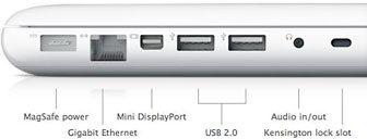

Ok my Mac is old like me and does not have USB port it has a display port I will probably by a new model next year but wanted to make this work to impress the wife and maybe myself
mortlocli
macrumors 6502a
Feb 23, 2020
686
635
is yours this 2010 macbook?
MacBook "Core 2 Duo" 2.4 13-Inch
Gigabit Ethernet, two USB 2.0 ports, a single audio in/out port, and a Mini DisplayPort that passes an audio as well as a video signal and supports an external display at 2560x1600. It does not have a Firewire port or IR to support a remote.
My oldest iMac (5,1) is 2007 and the other is 2009..as for me - Im 71.

I assume your MacBook is white? Is this correct? This would be a A1342 model. For this Mid 2010 MacBook, there are two usb2 ports to the right of the display port. This is where you would insert a flash drive with an os on it. If the above work flow was not successful.
