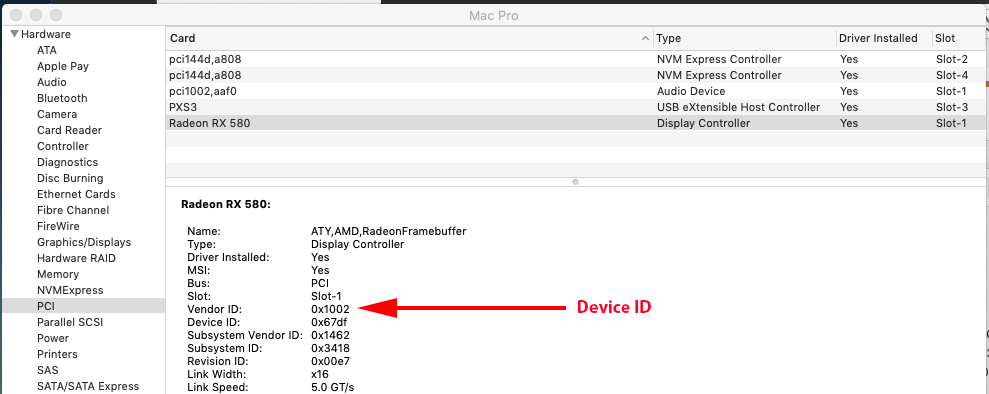

3. Go to "About This Mac " System Report / Graphics Displays /
Find your R9 280X and look for " Device ID WRITE this number down.in your notebook.
EXAMPLE : This is the Device ID for my MSI Armor RX580 8gb.
