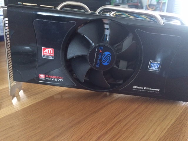

Hi 666sheep
my card looks like the attached pictures.
i tried the rom i found somewhere here on one of the eralier posts :)
flashed it with the original rom, but gray screen and kerne panic --> hard reeboot.
so i tried pipomolo42 way and created a custom rom --> same thing, gray screen
I'm running 10.6.4 by the way and did nothing expect the flashing of the rom (as i understood i do not to need to do any OS X modifications such a separate driver installation)
thanks for further help
Roger

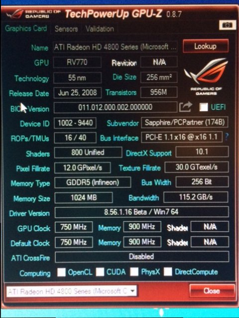

Hello. Yeah, i am posting to a dead thread, but... I flashed my Sapphire Radeon HD 4870 1GB with P/N 102-B50702-10-AT and SKU# 21133-04 . EFI bootscreen works on my Mac Pro 1.1 but when i try to boot to any OS X (installation USB or pre-installed system restored) i get a white screen and "missing bluetooth controller transport" error if boot verbose. I have 2x6 pin power connectors (1 from 2 molex and 1 from 1 SATA). What's wrong? Its the only card in my town that is compatible with MP.
I saw messages above where people asked to help with the same card, but sheep666 refused.
I need to know if the problem is with wrong EFI or with power cables.
Here is the original rom and the one modified with the script from the guide.
UPD: checked with a good power supply unit, the same problem. Please help.
