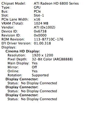

I don't see anything special in that screen..?
btw, about my last post, here is an explanation from rominator:
"The 6870 cards aren't working due to any EFI in BIOS.
They are working due to changes in APple's ATI drivers, which are now functioning as if they have an "ATY_Init" built in.
They are setting their own keys, with or without EFI."
I thought the fact that it was displaying EFI info was significant, but I guess I am wrong?

Ok I had no idea this was possible till I accidentally rebooted into osx with the card still plugged in. I am very, very excited. Do we know how effective the drivers available for this card are compared the windows ones?
Also i installed the drivers listed on a the previous page. Am i supposed to lose an input?

So what are the capabilities of this card with these drivers?
I've been getting ~30fps in TF2 at full settings, this seems like crap to me.

I think you are somewhat confused.
Anyone monkey on the planet could put a 6870 in a Mac Pro and have it work in OSX. This has been true since April when the 10.6.6 image for iMac came out.
It looks like you actually flashed the card's ROM, which is a very different thing than installing drivers.
If you connect a DVI on lower port you should now see a boot screen.
Apple & ATI decided to make the drivers work.
Netkas modded the iMac ROM and figured out how to make it work with existing ROMs.
It looks like you have flashed the card with Netkas' ROM...don't know why else you would see a this screen.
Whoops it looks like I got a little too excited and carried away. I used the goths link for the drivers. There were two installers. The first was definitely the kept installer. I guess the ati graphics update was the flasher? I can't find any specific evidence but a few archives I can open, so I assume they are the binary images.
Anyways I still can't boot the card by itself so I guess it didn't work anyways.

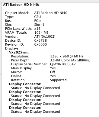

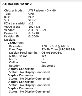

HELP ! XFX 6870 not working properly in MP 1.1
I tried getting these drivers from the previous page that others mentioned, but the link is dead.
My card is also showing up as an ATI Radeon HD N140. Here is a pic of my system profiler.
