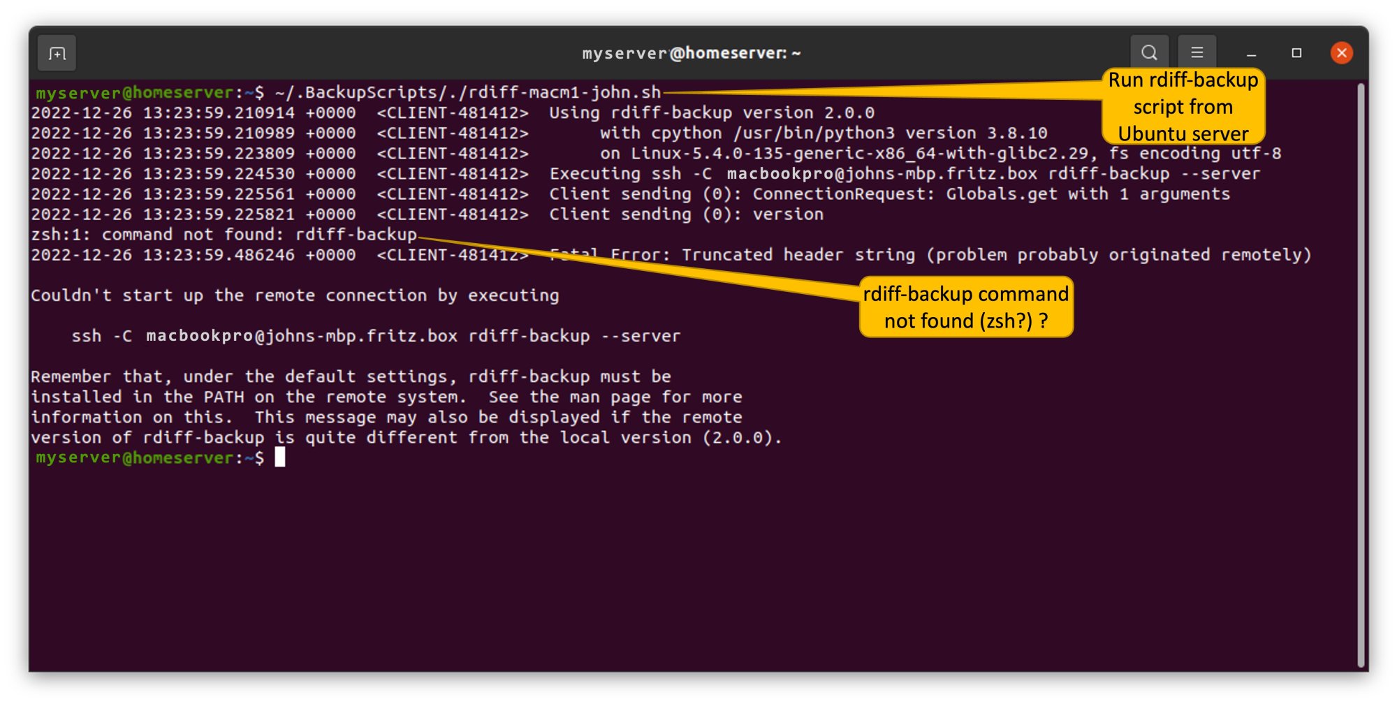

I was using rdiff-backup to backup files from my Mac Book Pro 2011 (running High Sierra OS) to my Ububtu server (20.04.5 LTS)...
This was working sucessfully, until I replaced the Mac Book Pro 2011 with a Mac Book Pro M1 (running Ventura OS).
When I run my backup script, I now get the error "zsh:1: command not found: rdiff-backup"
On the old Mac Book Pro 2011, I had to add the following line to ~/.bashrc...
PATH=/usr/local/bin:$PATH
It seems the new Mac M1 uses zsh now instead of bash and I am not sure whether I need to do something similar ?

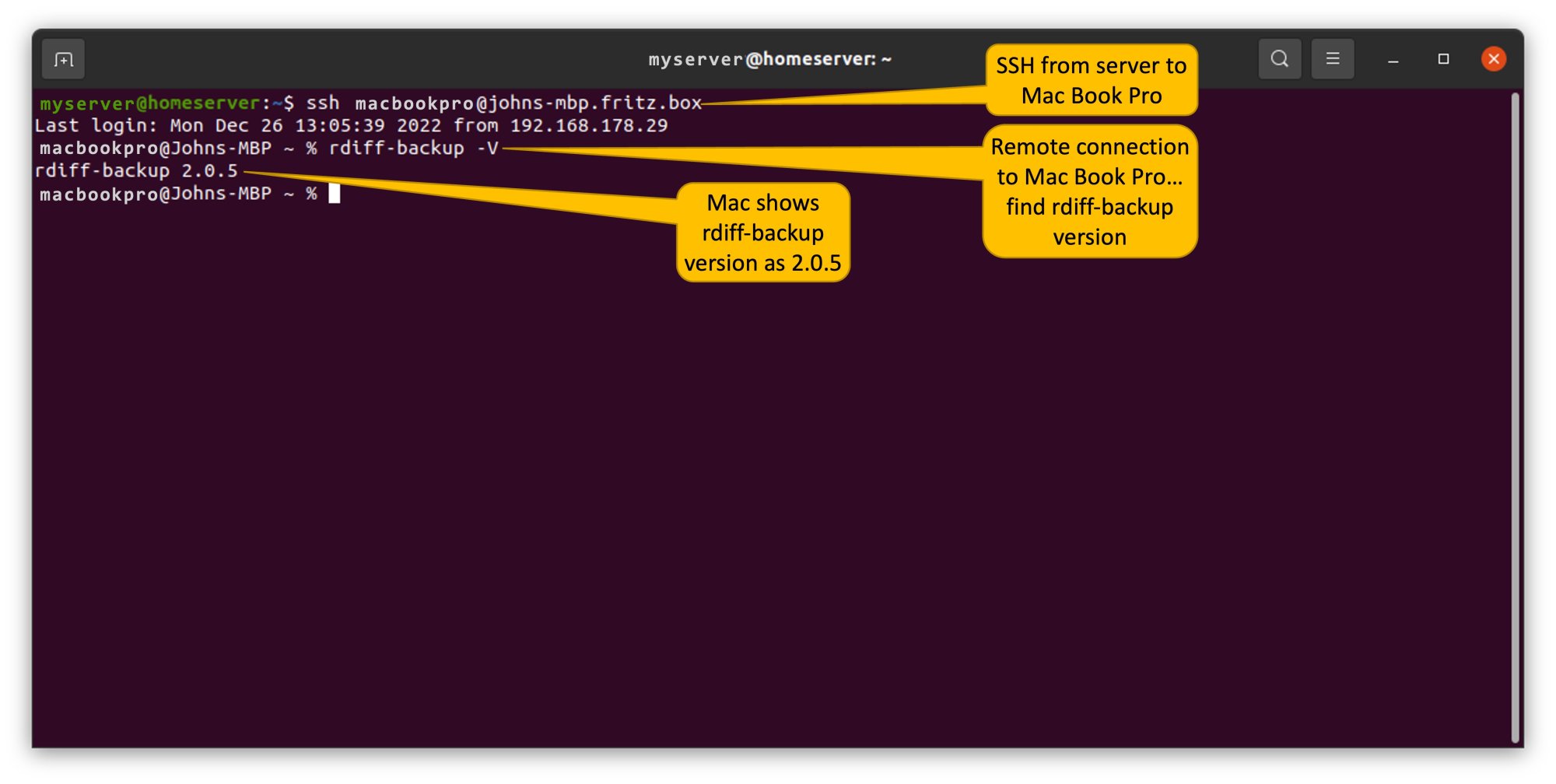

What I cant understand is when I SSH from Ubuntu server to the Mac, the rdiff-backup command is found (here it reports the version as 2.0.5)...
Yet when I run the backup script from Ubuntu server (which I assume effectively does the same thing) the rdiff-backup command cannot be found...
The Mac has rdiff-backup version 2.0.5 which I installed using Mac ports, the Ubuntu server has rdiff-backup version 2.0.0.
Below is the script (rdiff-macm1-john.sh) I run from Ubuntu server...

rdiff-backup -v9 --print-statistics \
    --exclude-special-files \
    --exclude ignorecase:'**.ini' \
    --exclude ignorecase:'**.DS_Store' \
    --exclude ignorecase:'**\$RECYCLE.BIN' \
    --exclude ignorecase:'**.AppleDouble' \
    --exclude ignorecase:'**.localized' \
    --exclude /Users/macbookpro/Documents/Microsoft\ User\ Data \
    --exclude /Users/macbookpro/Documents/Parallels \
    --exclude /Users/macbookpro/Downloads/svn \
    --include /Users/macbookpro/Desktop \
    --include /Users/macbookpro/Documents \
    --include /Users/macbookpro/Downloads \
    --include /Users/macbookpro/Movies \
    --include /Users/macbookpro/Music \
    --include /Users/macbookpro/Pictures \
    --exclude '**' macbookpro@johns-mbp.fritz.box::/Users/macbookpro \
    /media/storage/Backup/Mac/macbookpro

Clearly, rdiff-backup is not in the PATH when being executed in the SSH environment when the pull happens. Either read the zsh man pages to figure out which file to use to add the command directory to your path or change the command that is executed via SSH to fully specify the path name of the command. You can use the 'which rdiff-backup' in your interactive shell to figure out the path.
Keep in mind that a SSH pull might not be an "interactive" shell so different files are sourced compared to a login shell.

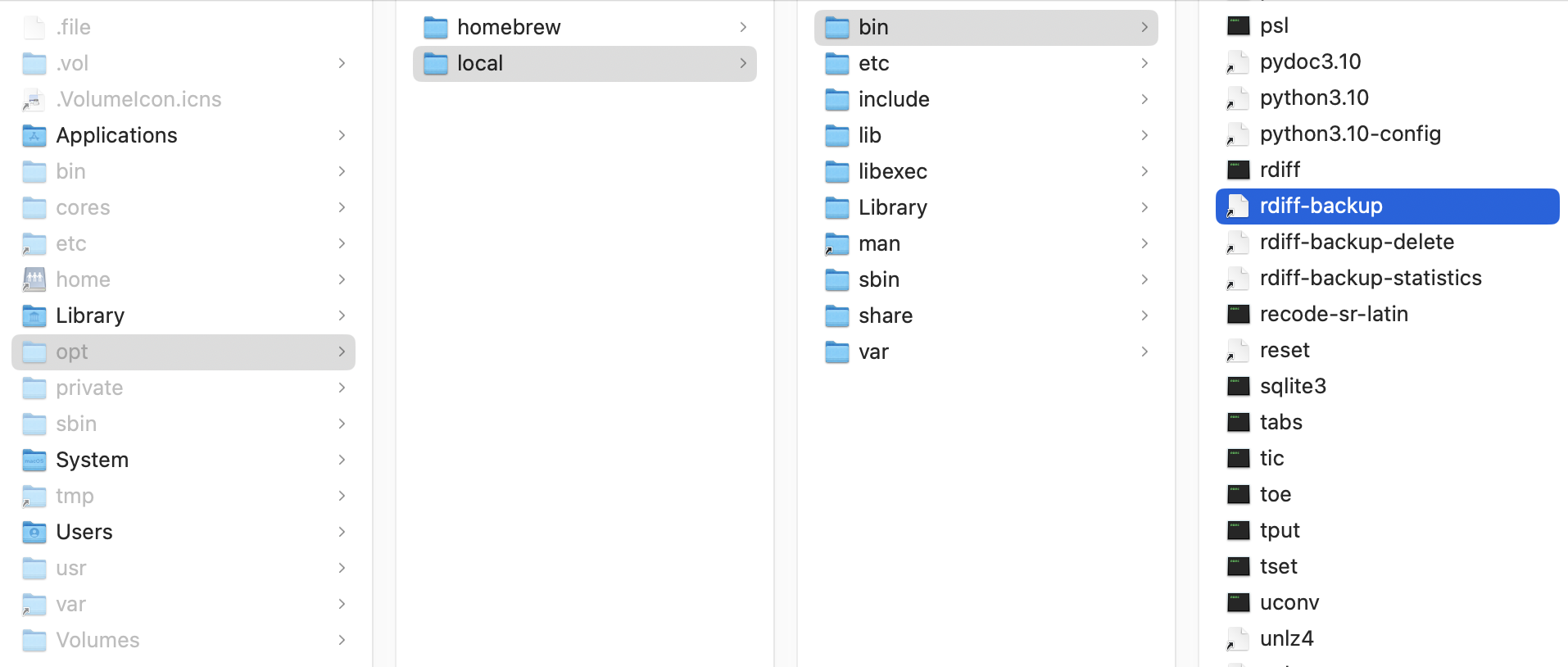

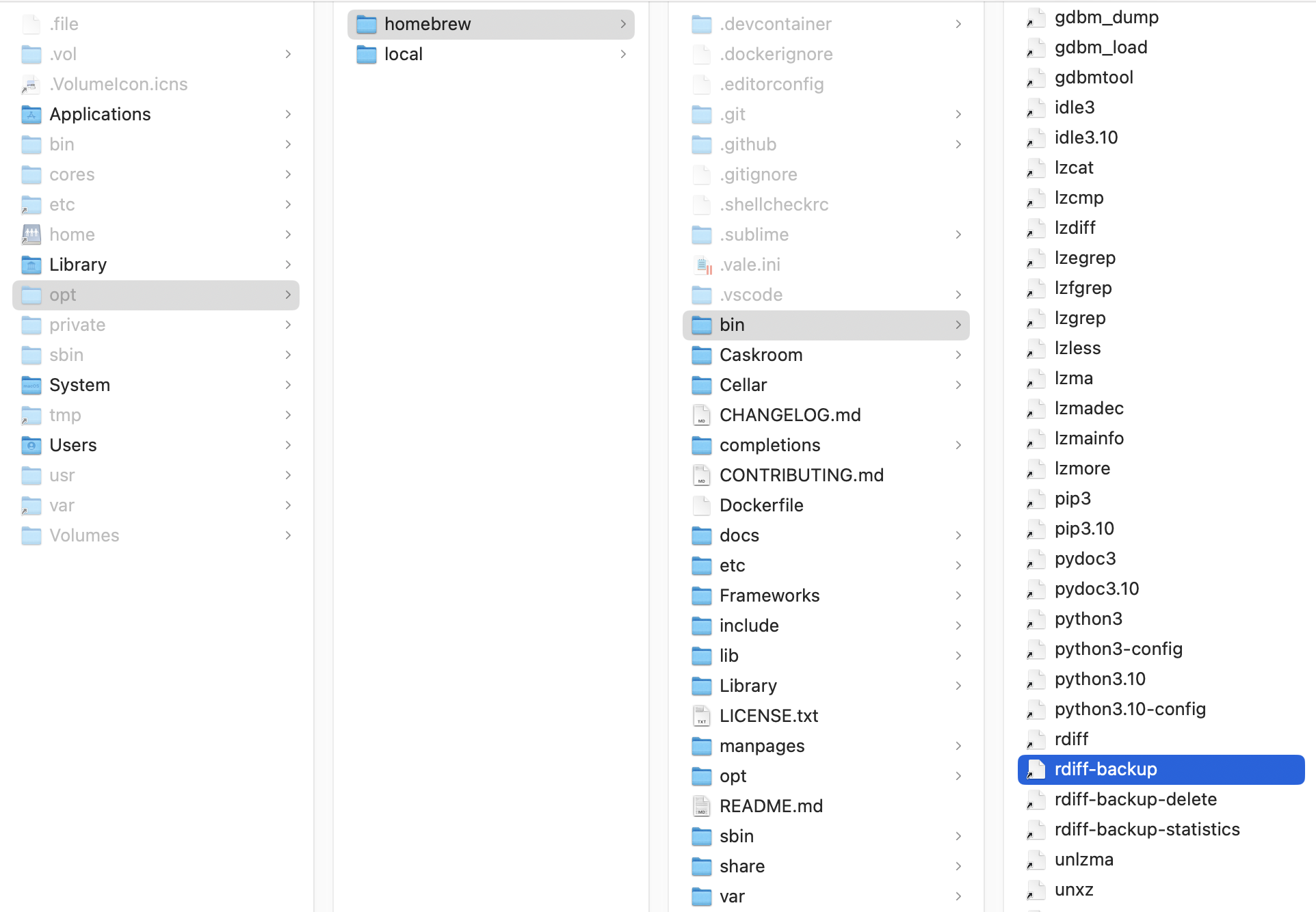

And the Mac Port version of rdiff-backup installed...
PS. I don't like how long it took to install the Mac Ports version of rdiff-backup and all the other packages it installed (makes me nervous). Ideally I would like to remove the Mac Ports version and use the homebrew version, but I dont know how to do this. Though the first step is to get rdiff-backup working from my server !

From the picture it appears that "rdiff-backup" might be a symlink. Maybe to rdiff? That might have something to do with it. Maybe copy the executable that is the target to rdiff-backup manually. Or you've got an architecture/library mismatch. That can cause a Unix "command not found" error.
Thanks mfram, you are correct that the rdiff-backup shown in the screen shot are aliases.
For /opt/local/bin/rdiff-backup the original file is here:
/opt/local/Library/Frameworks/Python.framework/Versions/3.10/bin/rdiff-backup
For /opt/homebrew/bin/rdiff-backup the original file is here:
/opt/homebrew/Cellar/rdiff-backup/2.0.5_2/libexec/rdiff-backup
