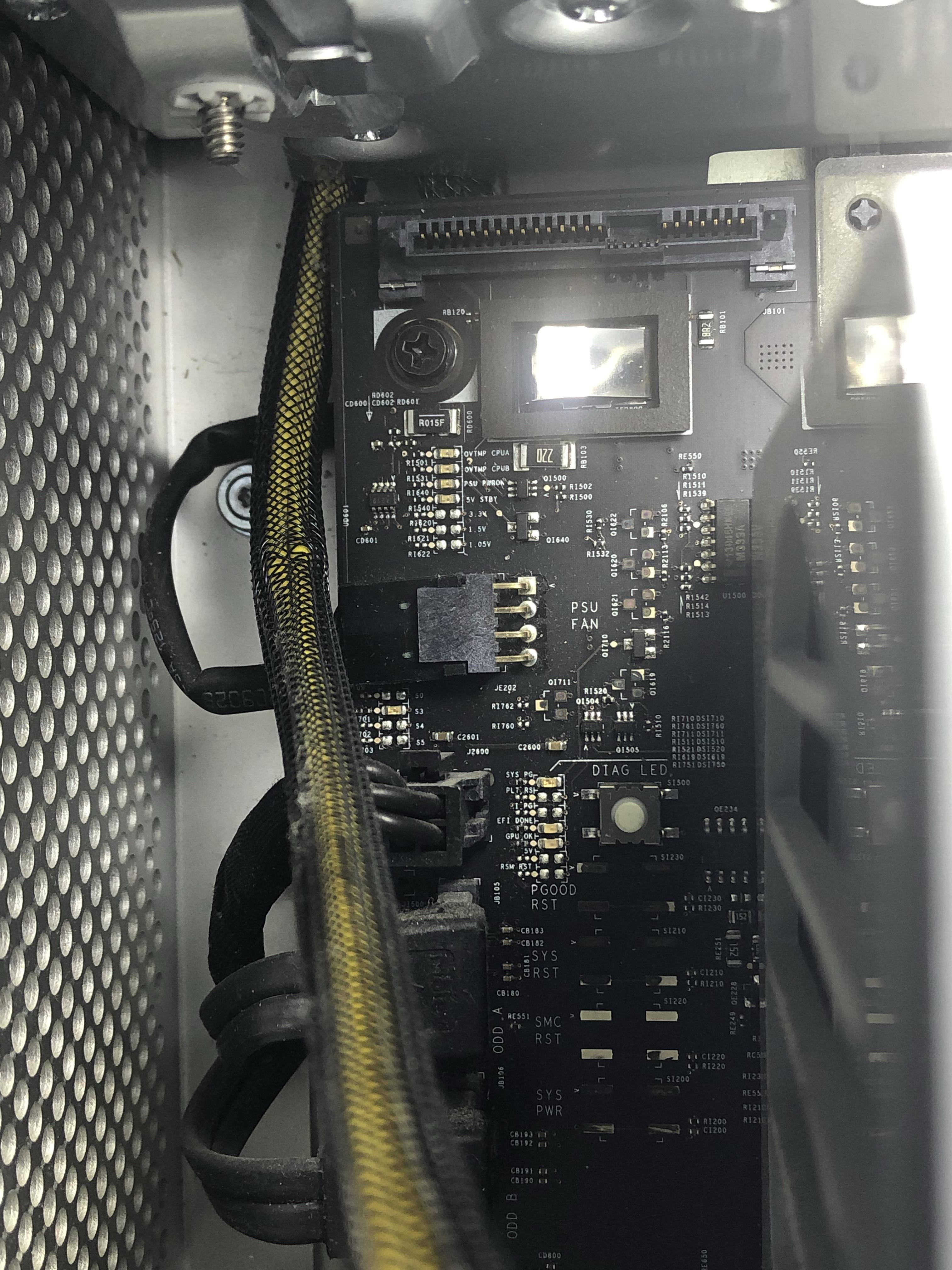

First check if EFI_DONE LED is lit when you press the DIAG button. If the LED is off, you have a brick to repair.
If it's on, then install an AppleOEM GPU and a display that you sure that works.

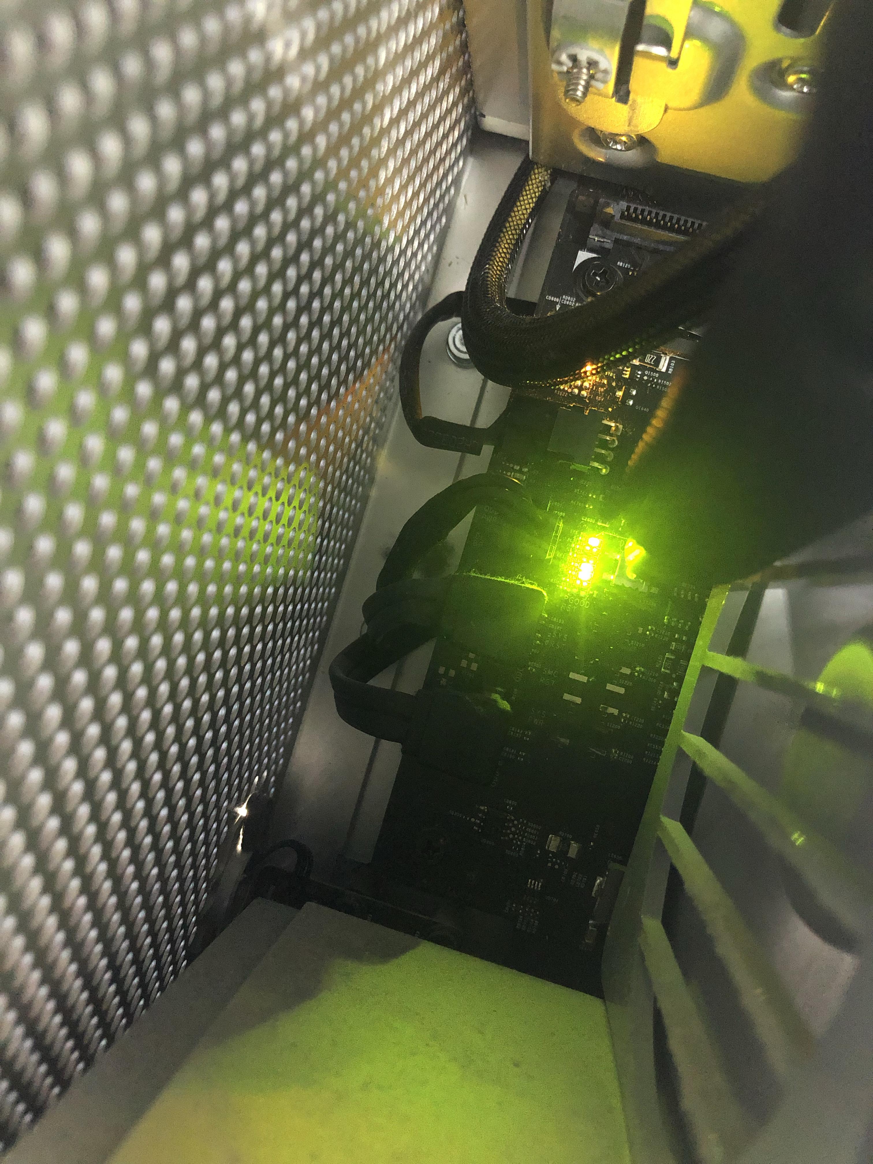

I have attached a photo but cannot find the efi_led?
Efi_done blinked solid for few seconds
GPU_OK blinked twice briefly
Should not blink at all, needs to be a solid lit LED while you press the DIAG button. Anyway, install an Apple OEM GPU and a display that you sure works before anything else and see if you get the black Apple on grey background screen when you power on.

Whilst the depressing the Diag_led button, Efi_done Led comes on for a second or so and turns off and comes back on for a second and then turns off whilst the GPU_OK flashes twice rapidly and then goes off.

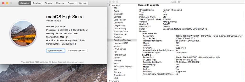

I have managed to get it up and running using the donor Apple OEM GPU 5770 and since it was already time machined to an earlier point, I connected the Vega 56 back and now it seems to be working. I have not run AHT / ASD as yet. I will report back once i get a chance.
In the meantime, I am on Mojave with bootroom 144.0.0.0.0. Is there any diagnostics apart from the one mentioned above that you would recommend running?
