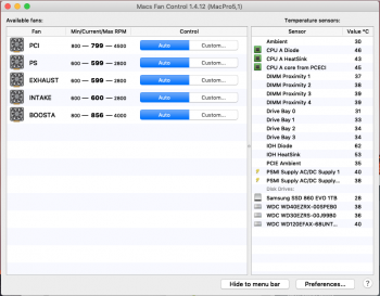

Can someone help me set up Macs Fan Control to lower the temps a bit, especially to help with the HDD temps. During heavy load HDDs can go up to 50C. Temps shown are with side panel removed.

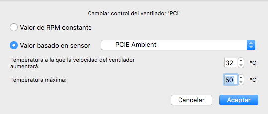

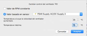

I'd recommend the following:
-remove PCI slot covers from unused PCI slots and leave it open.

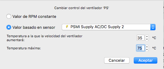

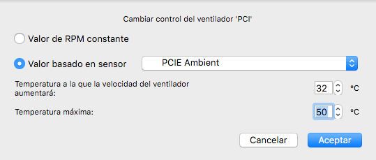

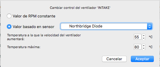

-set the PCI fan depending on PCIE ambient (see screenshot)
-set PSU depending on PSU supply 2 (see screenshot)

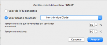

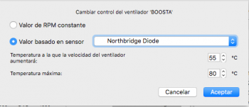

To keep all Temps low in the CPU compartment i'd recommend:

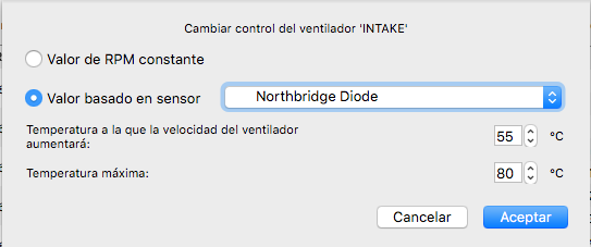

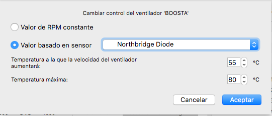

-Intake and Boost A fan depending on NB diode (see screenshot)

All fan setups are a bit personal as well, e.g. I prefer low Temps.
You could test this setup and tweak it to your taste and workload, finding a balance between low Temps and fan noise...
Thanks a lot, really appreciate it. I've moved the warmer drive to slot 1, put the side panel back on, and made the changes you recommended. Can't move the GPU, all slots occupied. I wonder if I could turn the 2 fans on the RX580 on to create more air flow but I guess it would just blow hot air at the drives.
For the intake, 55C seems a bit high, at the moment my CPU A Diode is 46C. What made you choose 55C?
The Intake and Boost fan are controlled by NorthBridge Diode not CPU diode 😉
