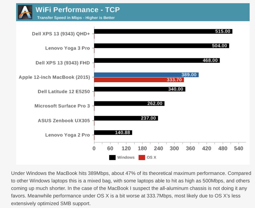

I looked up my MBP speed test and looks like this is around the average speed to expect.
I don’t see any WiFi speed test for the iPad mini 5 but it looks to be common to be around 50% the theoretical rate. Hard to say if getting a router would make the efficient speeds faster.

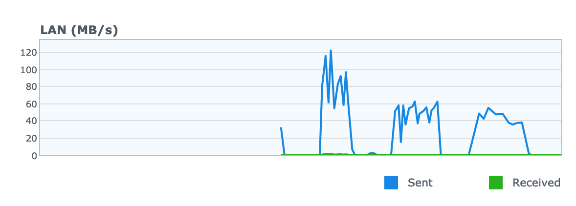

Long story short, there is nothing wrong with my router. I am getting 40-50 MB/s now depending on the file size.
The first 3 transfers are downloading a 4.2 GB file to the ipad. The first transfer is before turning off a nearby wifi and after moving the router to face me. The 2nd is with cabinet door closed and the 3rd is with the cabinet opened. The average time was around 1 minute and 35 seconds for a 4.2 GB file or around ~44 MB/s The last test I did was moving a 772 MB file over to the ipad, which took about 15 seconds or around ~ 51 MB/s.
The 2nd wireless was interfearing with my router and the direction of the antenna matters, among other things. I actually did get another router to test but the the results were around the same, so no benefit from MU-MIMO or from higher spec router on the 5 Ghz band.
So, just like article I found, the actual wifi performance is around 47% of what the ipad is rated at. In the iPad mini 5 case it's 866 Mbps rated so 433 Mbps or around 54 MB/s is what your going to average out at. You can look at the transfer rate and see that it maxed out at 80 MB/s and even hit over 60 MB/s at some times but sometimes you got really low transfer rates .
I did all this testing because I wanted to see how fast I could transfer files to the iPad, since there was no USB 3 support. The lighting cable averaged about 30 MB/s so the answer is you can get 40-50 MB/s using wifi and a NAS.
