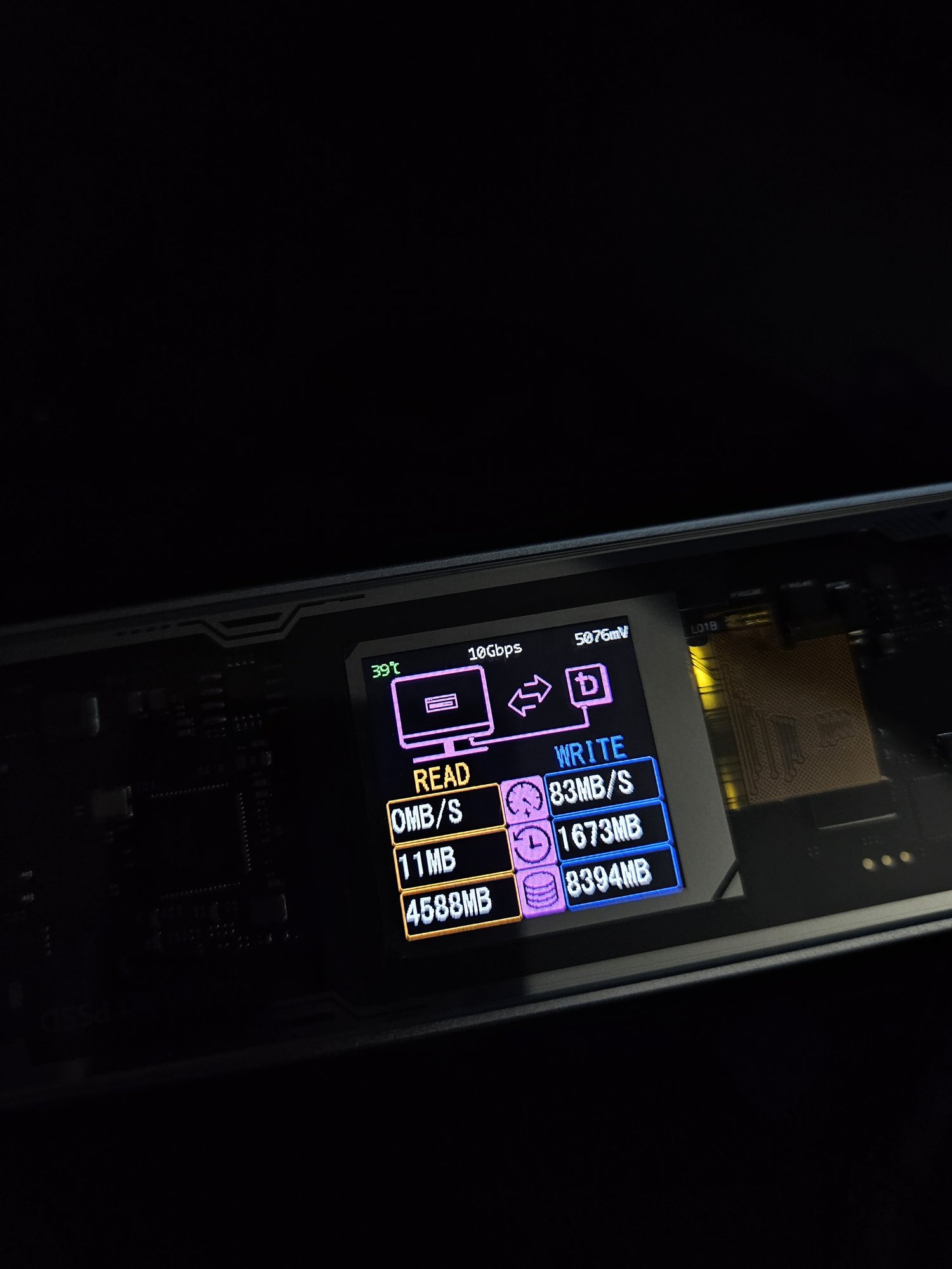

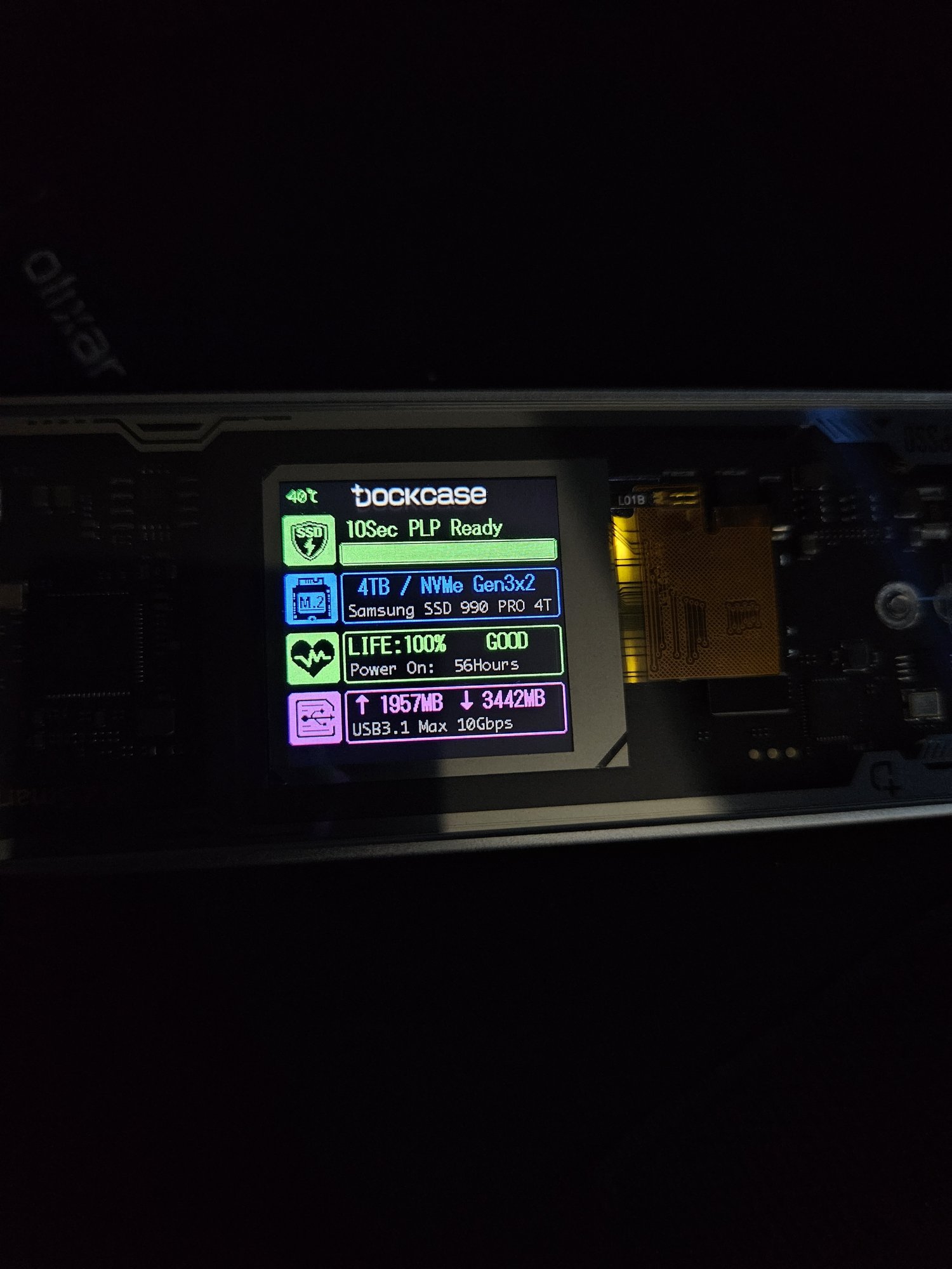

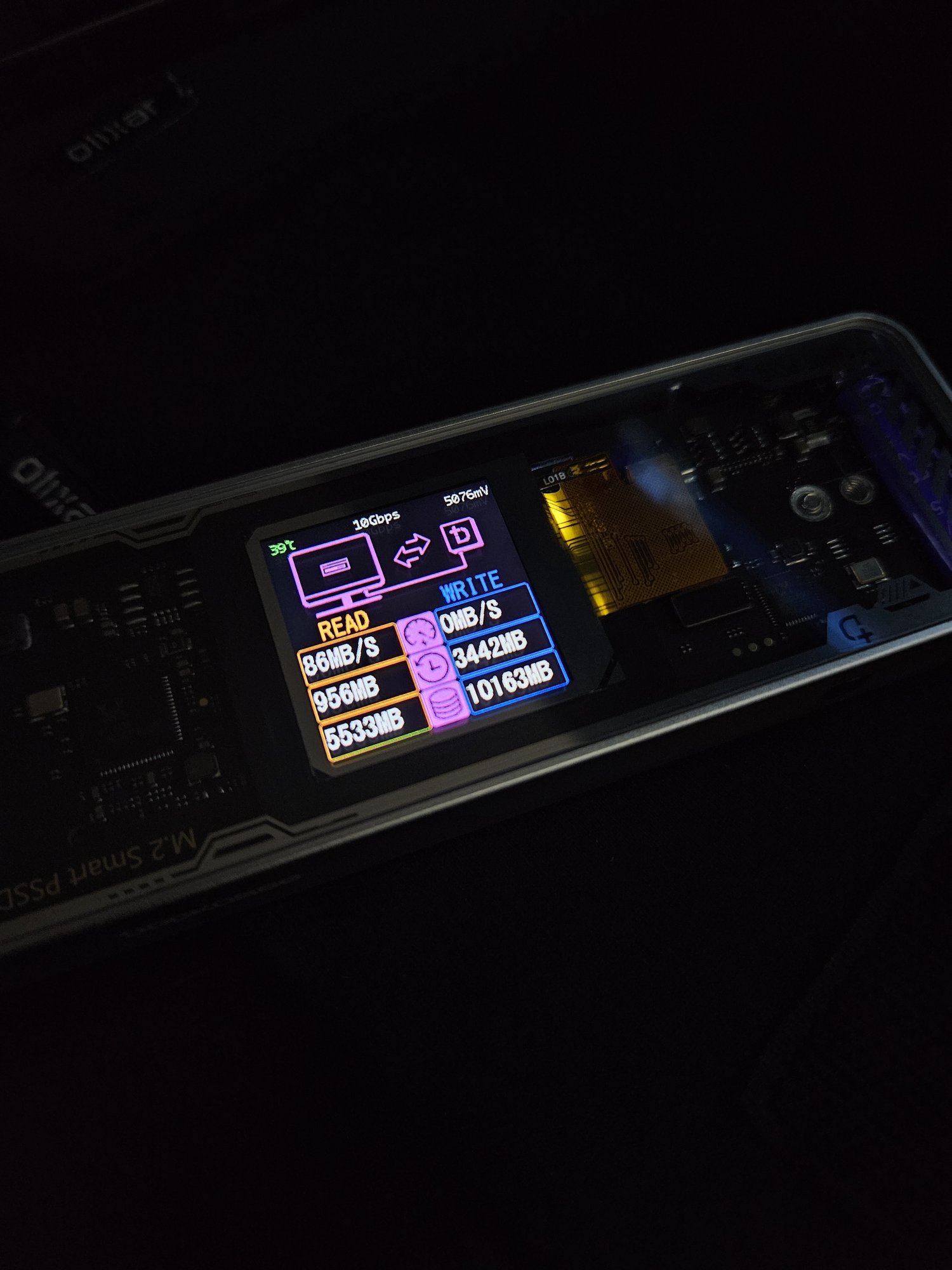

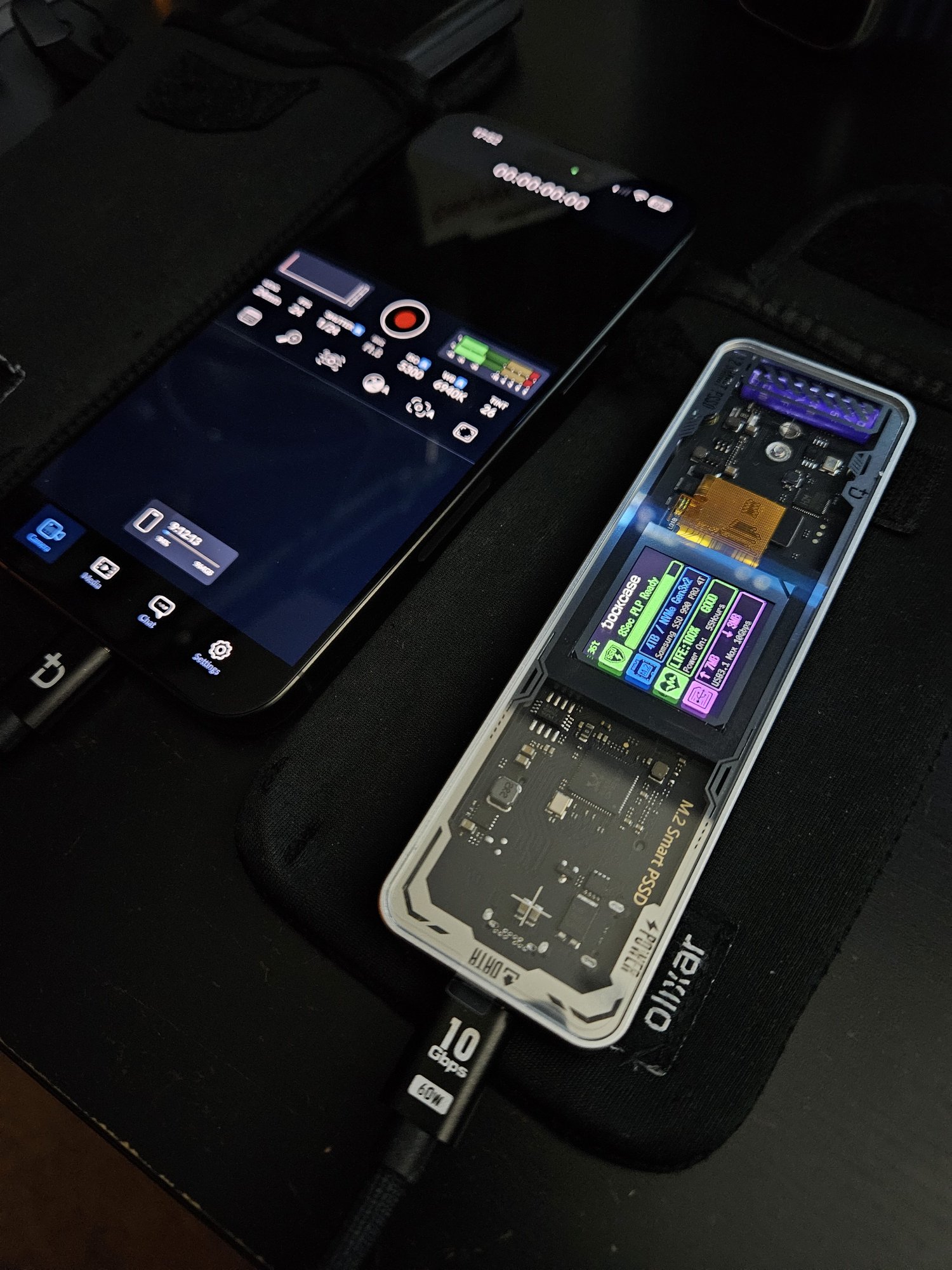

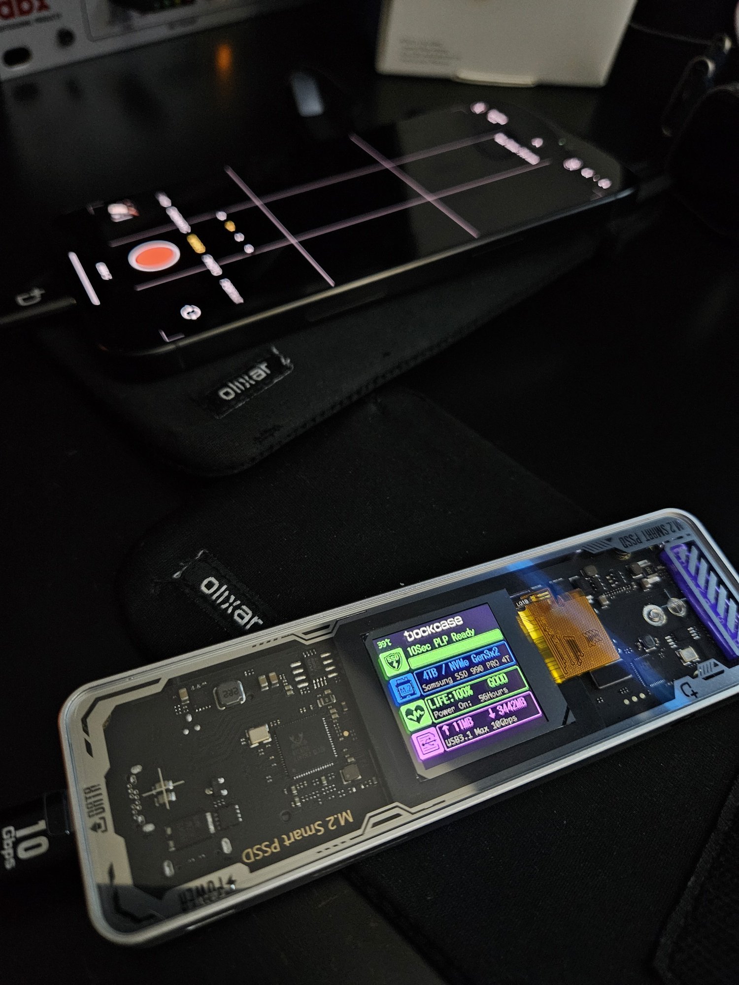

im using a samsung 990 pro 4tb gen 4 ssd. ive two - one formatted exfat and the other apfs for the apple universe. enclosed in dockcase enclosures.
ive seen some people online state the gen 4 ssds wont be recognized by iphone and this is just not true.
