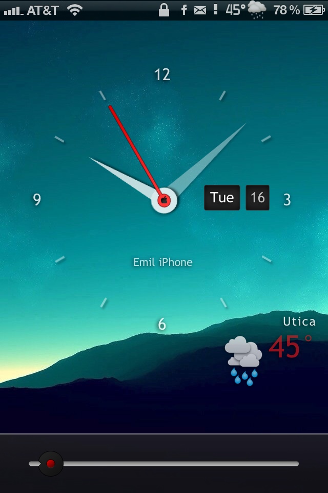

this is me...
What did you use iFile for exactly?
Sorry to ask these questions - I'm just trying to make sure there's no bugs in the code and that the problem resides on the Cydia/host end.
after installing the lockscreen, opened ifile to , analock HD.theme, and edited the analock.js file, added my local yahoo weather code, changed the numbers from roman to normal 3,9,12 etc, and added the text in center,, did a respring and its all good like you see it now
