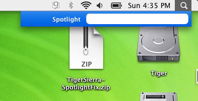

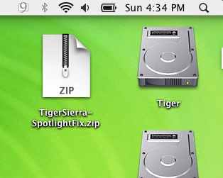

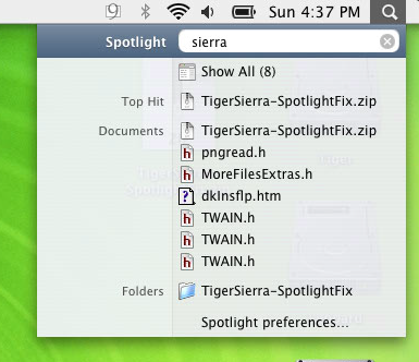

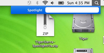

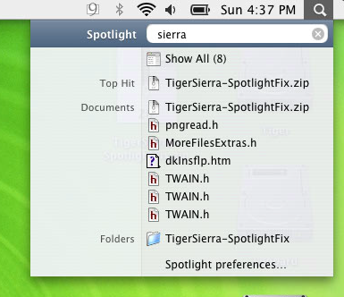

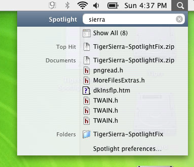

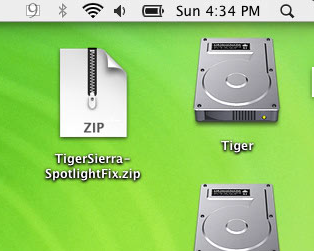

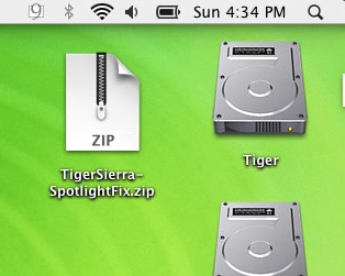

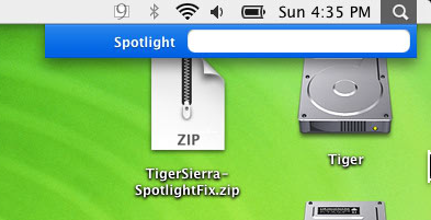

The issue with the spotlight icon was that the "Normal" (non-clicked) Blue theme icon file has an extension of ".tif" instead of ".tiff" and the images for the Graphite theme were actually the original blue files.
I've re-rendered the icon (and corner rounded-edge) to look a bit more consistent with LeopardRebirth (which uses PDF instead of the TIFF format for this icon).
Download the attached TigerSierra-SpotlightFix.zip file, which contains four .tiff files, copy them into /System/Library/CoreServices/Search.bundle/Contents/Resources/ replacing the existing. I found that Finder didn't allow this copy even after authenticating, so you may need to use "sudo cp" in Terminal.app to put them into place.
Screen grabs of the spotlight fix attached in both Blue and Graphite colour themes:
  • TigerSierra-SpotlightFix.zip
Great, thanks for fixing this! I'll edit my original post saying to use this file.

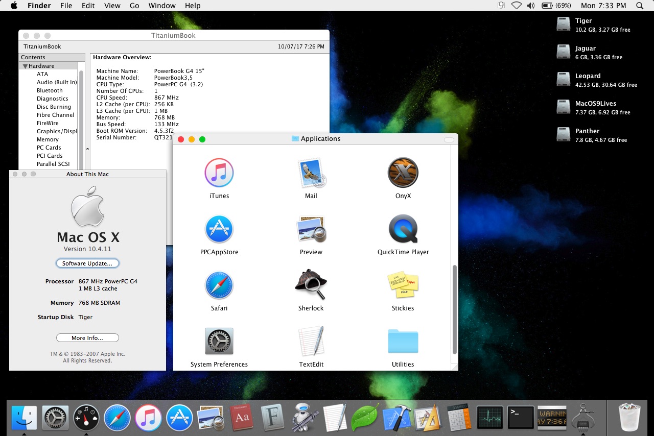

Although I lurk around about once a month here nowadays, I'm still doing work on this theme, mainly because I hate leaving things unfinished . My rants about insecure lads needing to be "first" from late last year aside, I've shared my recent updates with AmazingHenry (which constitute a nearly completed theme), and hopefully he will issue an update soon. I've corrected a lot of the resource color issues from the original theme, and changed a whole slew of other resources I left out of the original theme. Thanks to AphoticD for catching and fixing my Spotlight theming glitch and his icon packs, and thanks to Zappaesque for mentioning MacGizmo, RapidOStart, Imagine Boot X, and his WaitingForWindowServer tweak. Cool stuff, mates. Here are some recent screenshots from my 667 Mhz TiBook VGA (including AphoticD's fix):
I have a few things left to do, like fix inactive window resources, slim down the progress bars (thanks to SST and his modified Extras.rsrc for the clues. I'll use my own assets with proper masks and transparency, thank you, so no need for you to worry), text box shaping, and other very minor things, and this thing will be done as best as it can be.
