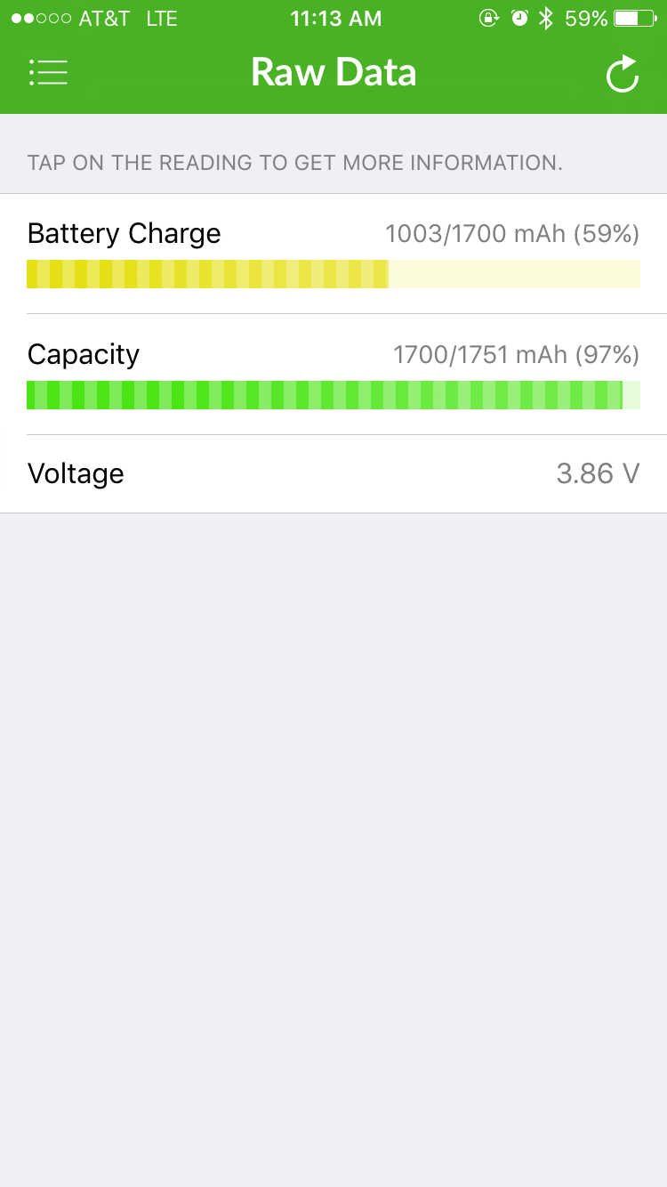

here's one from an iOS app. not sure how accurate the iOS ones are.
This isn't nearly as accurate as Coconut battery because of iOS 10 limitations. But if you are constantly at 2 bars of signal strength, it doesnt shock me your battery life is horrible. Anything under 4 bars will drastically effect battery life.

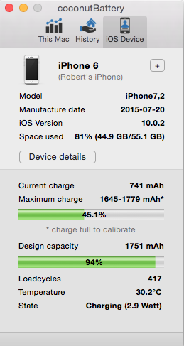

[doublepost=1475775969][/doublepost]here's the results with coconut.

OK, i did not put the AW on AP mode when i got home. it stayed on it's charger. my iPhone's battery was still decreasing faster than my normal usage. Had to charge it before i left work and again around 7pm or it would have died in the next 10-15mins of usage. before bed, I charged it to 100% and left the iPhone OFF the charger, i woke up to 97%. nothing running in the background and the AW still on it's charger. I will test it again tonight with the AW ON AP mode and the iPhone still off the charger.
I'll much take a 3% drop for roughly 7hrs. it's a totally different animal when my iPhone is being used. I've only had an AW for a couple of weeks now, all this time i was thinking it's normal behavior.
so last night, I went home and un-paired and re-paired my watch. i charged my iPhone 100% and left it off the charger. I also charged the watch to 100% and put it in airplane mode. I woke up to both at 97% this morning. we'll see how it does during the day. I guess we can confirm, at idle both are fine.
