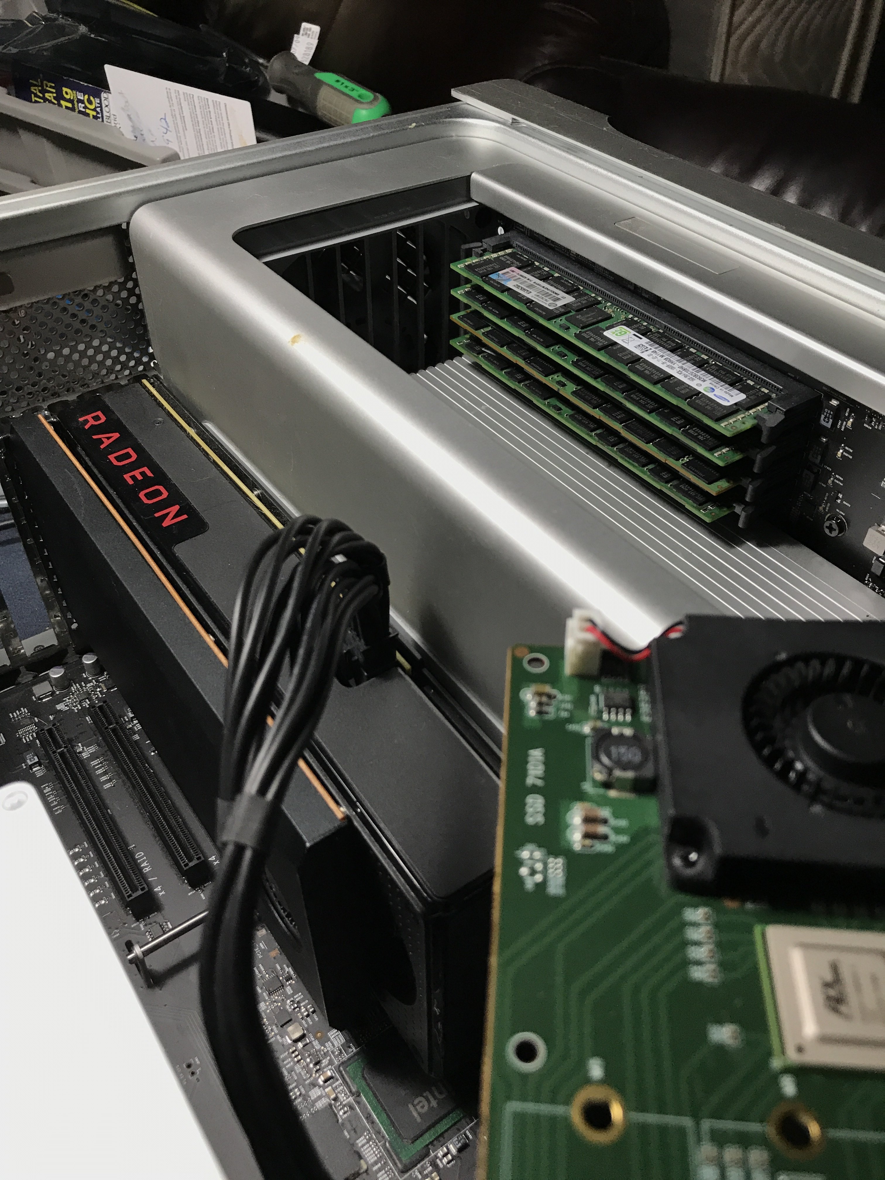

Generally speaking, keeping the side off has greatest effect on components with passive cooling, such a RAM and PCIe SSD’s.
It also lowers the noise generated from the rear of the cMP and the airflow through the chassis. While the video card may be pulling in warm air bellowing up from below, any loss in cooling will be minimized.
With the Mac Pro on its side, about 3.5 feet off the floor, on a standing desk with the side panel removed, I encountered the RAM speed throttling with the side panel removed. In this orientation, heat travels upward from the heat pipe, towards the RAM.
The type of video card cooler will also impact the temps of the pci bay. Cards without a blower type exhaust will act as a space heater for any components vertically positioned above it.
Re-installing the side panel reduced throttling, allowing the RAM to quickly recover rather than slowing down.
I’ll admit, I’ve run my cMP without the side panel for years without worry or concern. Only after upgrading to RDIMMS and encountering a reproducible slow down running benchmarks did the the design of Apple’s wind tunnel design truly make sense.

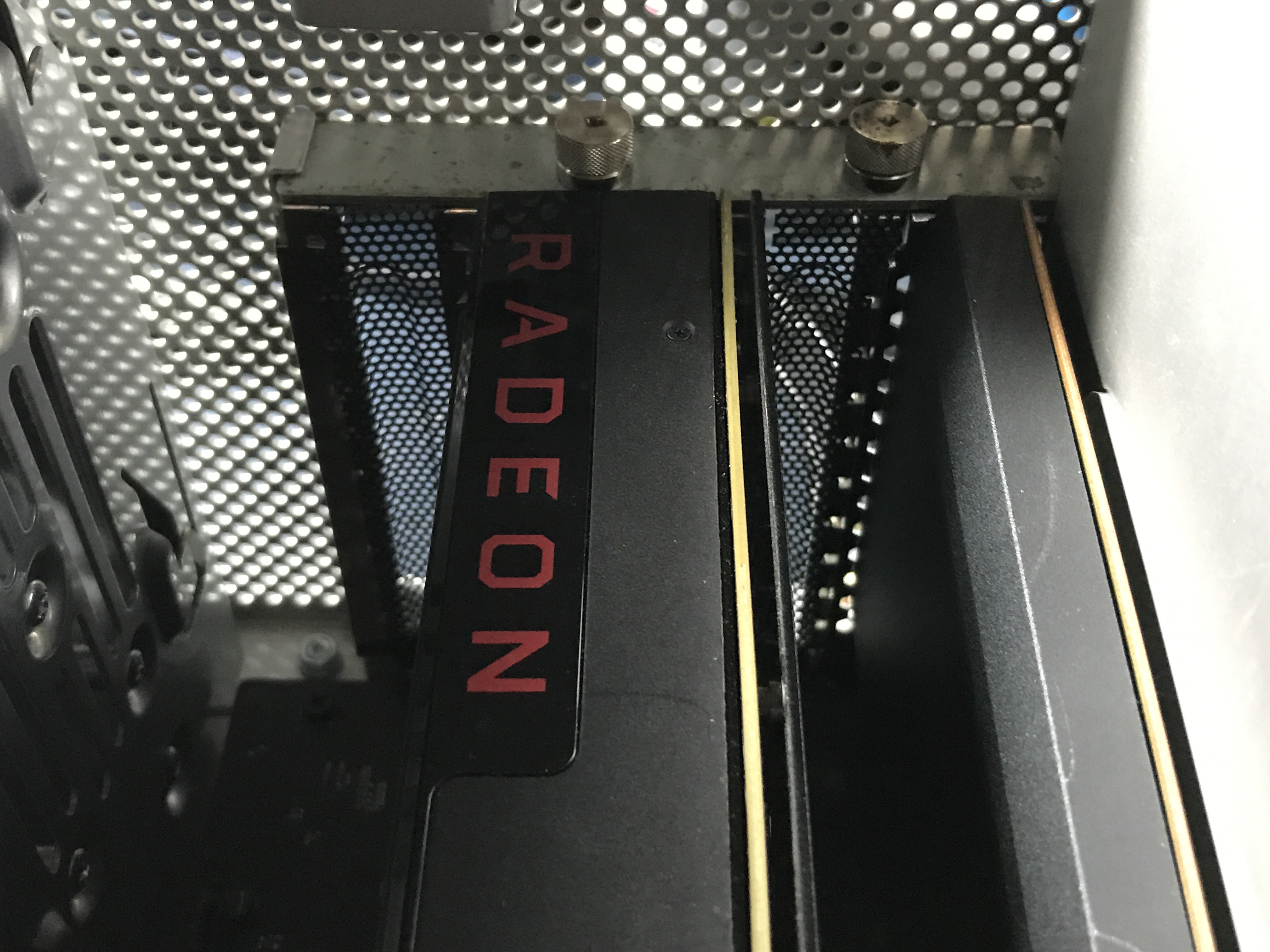

One more thing... On the 'bench' cmp I replaced the traditional PCIe slot covers with a black mesh version from a PC case, allowing for more airflow out of the PCIe bay.
Reactions: handheldgames

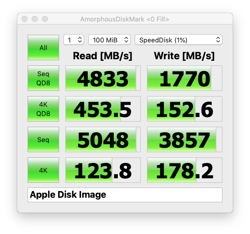

Sharing legacy x58 PC Ramdisk benchmarks from the net. It gives a good idea of what should be possible on our x58 based Mac.
http://fiehnlab.ucdavis.edu/downloads/staff/kind/Collector/Benchmark/RamDisk/ramdisk-benchmarks.pdf
A free copy of Amorpheous Disk Mark may also expose slowdowns encountered in QuickBench.
