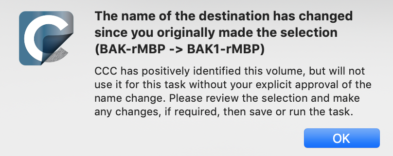

I just tried it with CCC and got this message (see below) - I clicked ok and it is doing an incremental clone - will report back when it is finished - so far it seems ok

that is stange - I changed it in the finder - just clicked on the desktop icon and changed the name - then it shows up in disk utilities too and no duplicate - am on catalina 10.15.5 and apfs (non encrypted)
