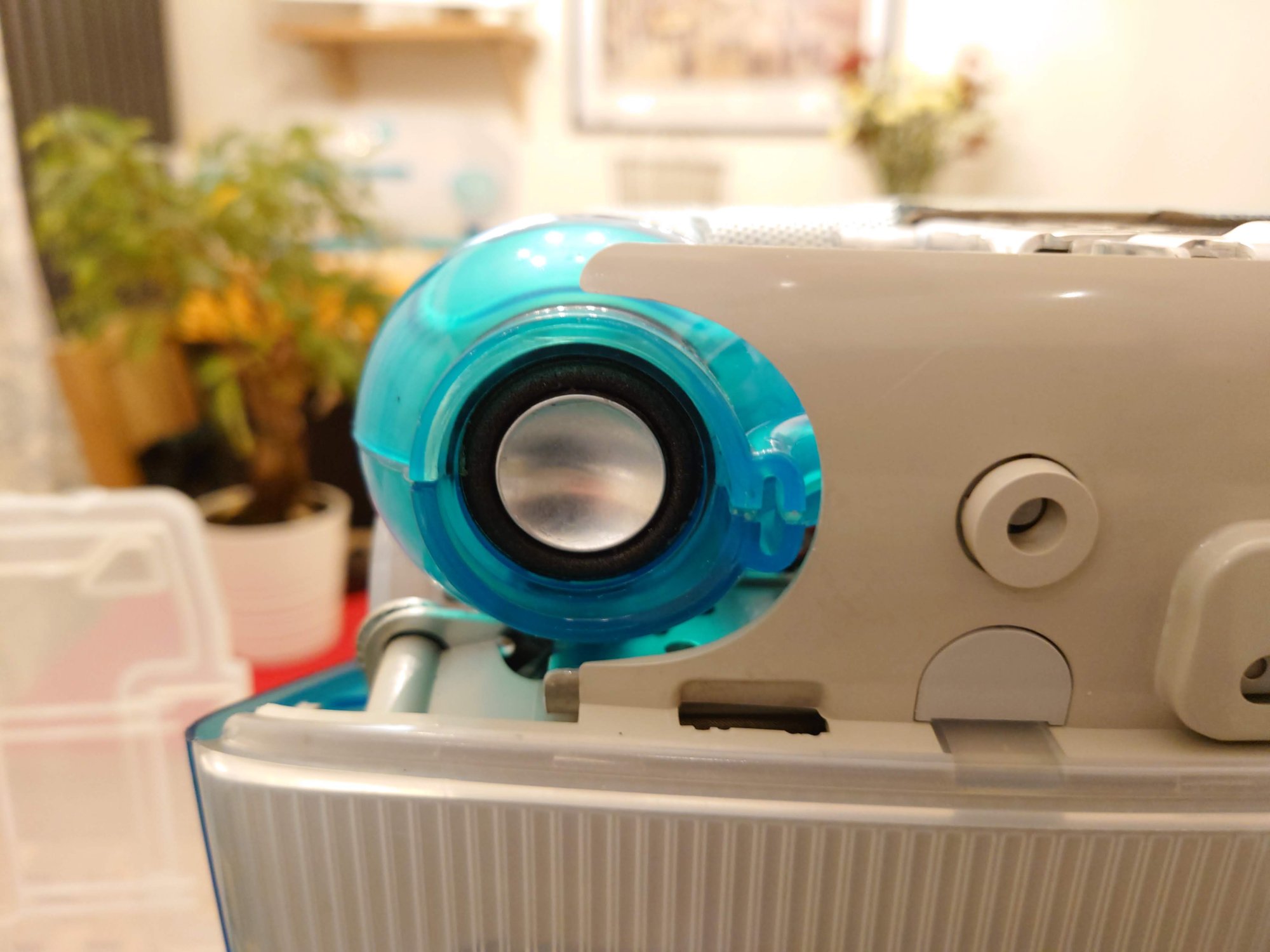

Method:
Disassemble the iMac to this state: https://www.ifixit.com/Teardown/iMac+G3+Model+M5521+Teardown/54877#s119719

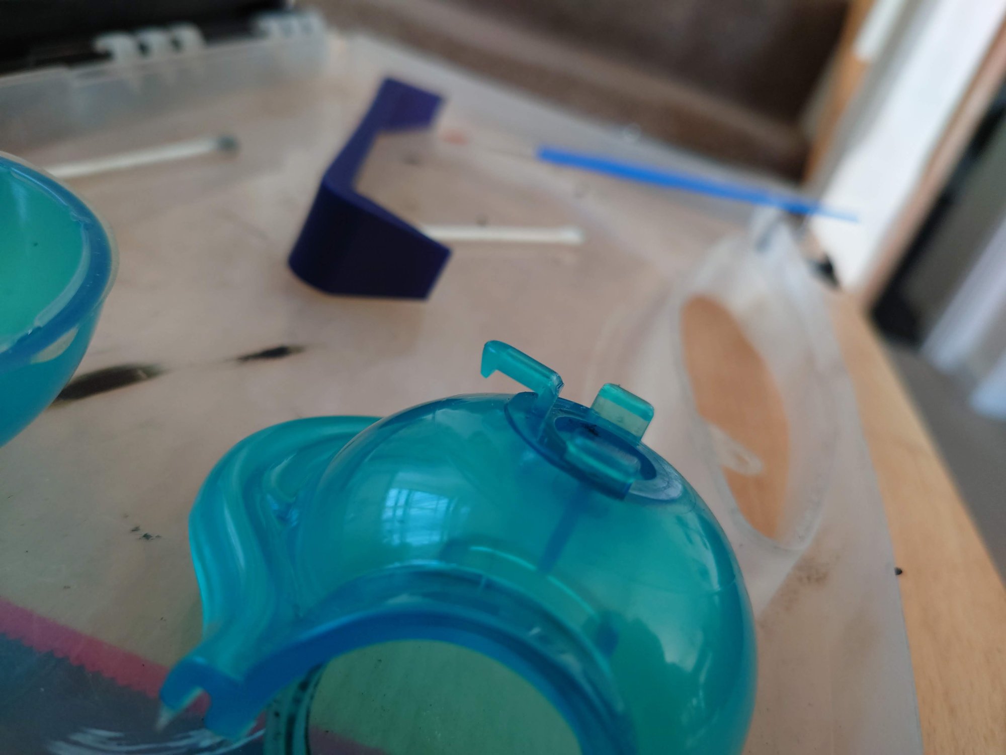

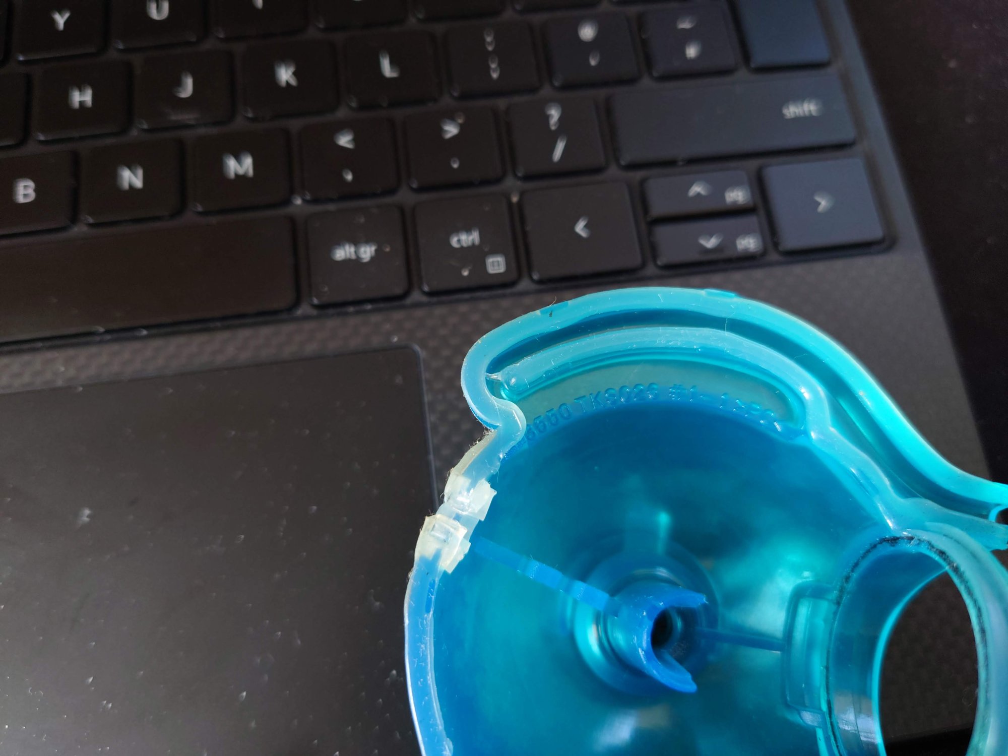

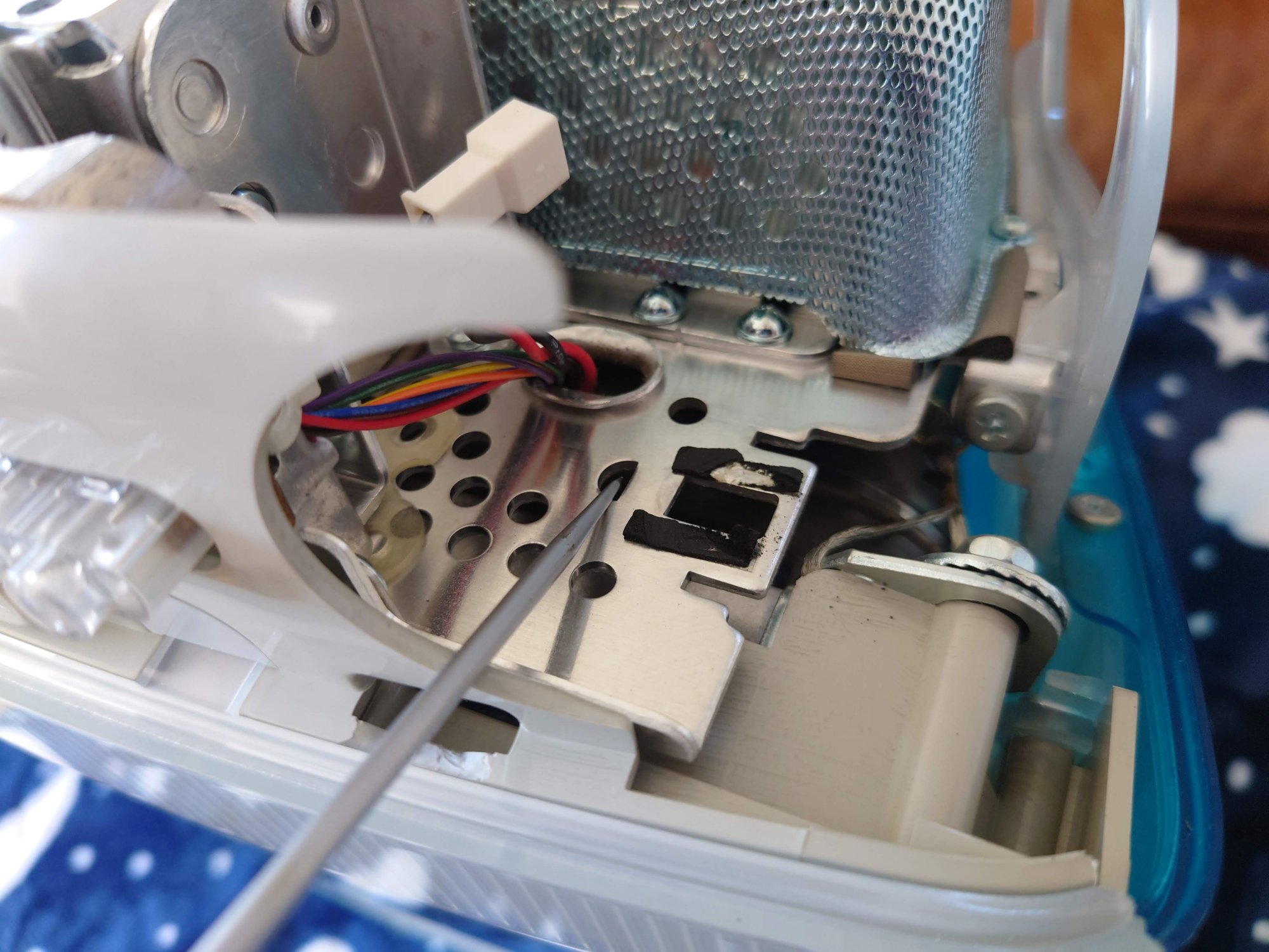

To remove the speakers, many videos have you "grab it and wiggle until it comes loose". You don't need to do that, especially given the plastics on these are now getting brittle.
Instead, take your awl, or a long, thin screwdriver and poke through this retaining clip. There's a gap just large enough to reach through between the speaker unit and the iMac case.
While doing this, wiggle (a little) and pull along the horizontal axis away from the DVD drive. The speakers are also fixed down with a bit of adhesive foam, but the real reason they're hard to remove is the plastic clip.

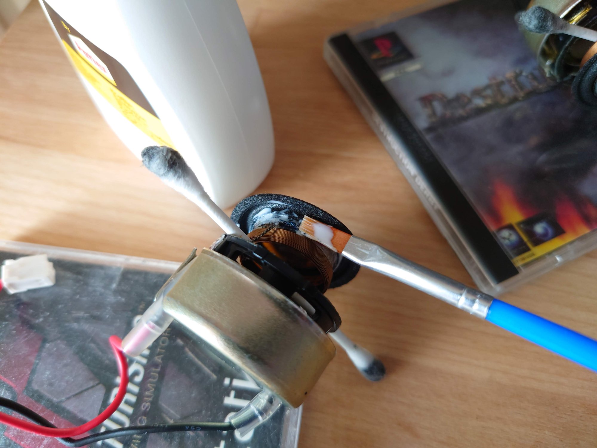

Once the speakers are removed, you can disassemble each further with a philips head screwdriver. The clear silicone can stay, I left mine in place and it sealed the bass unit adequately upon reassembly.

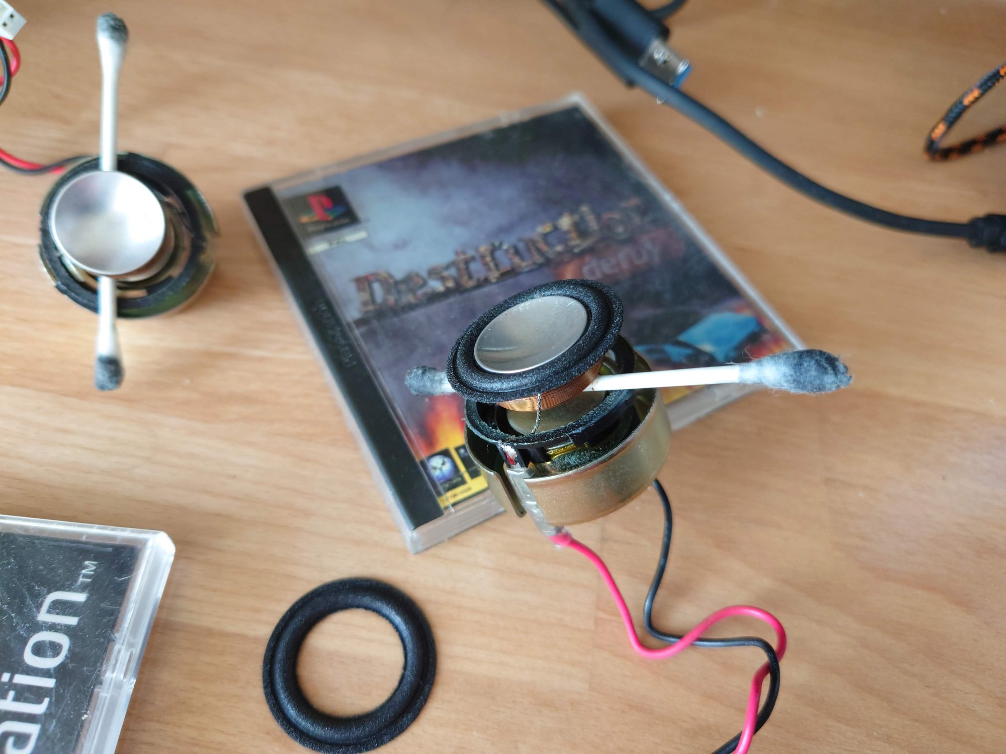

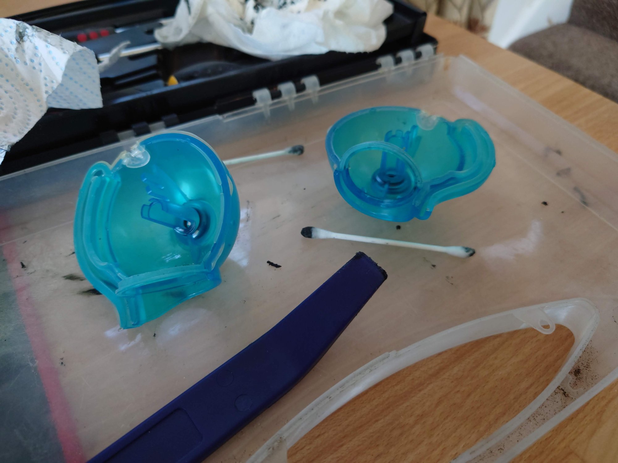

Next you will need to carefully scrape away the vile, rotten, goopy foam from both the speaker and plastic sphere in turn. I used a small screwdriver, plastic scrapting tool, Q-tips and IPA. This took a while; you won't get it perfect, but make it clean enough for the glue to adhere to something solid.

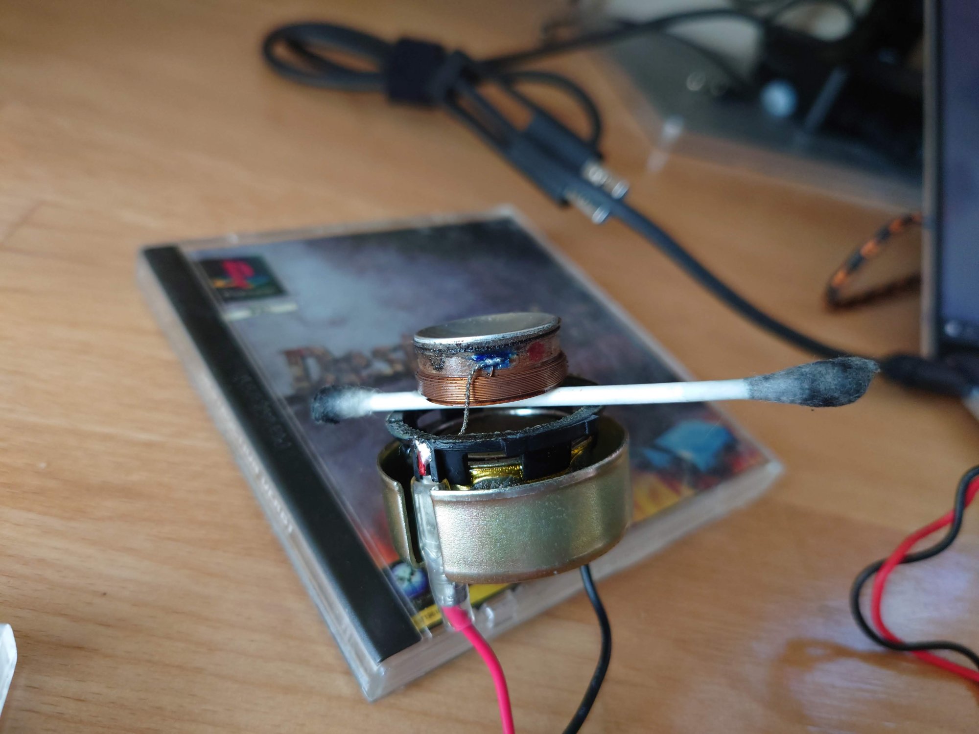

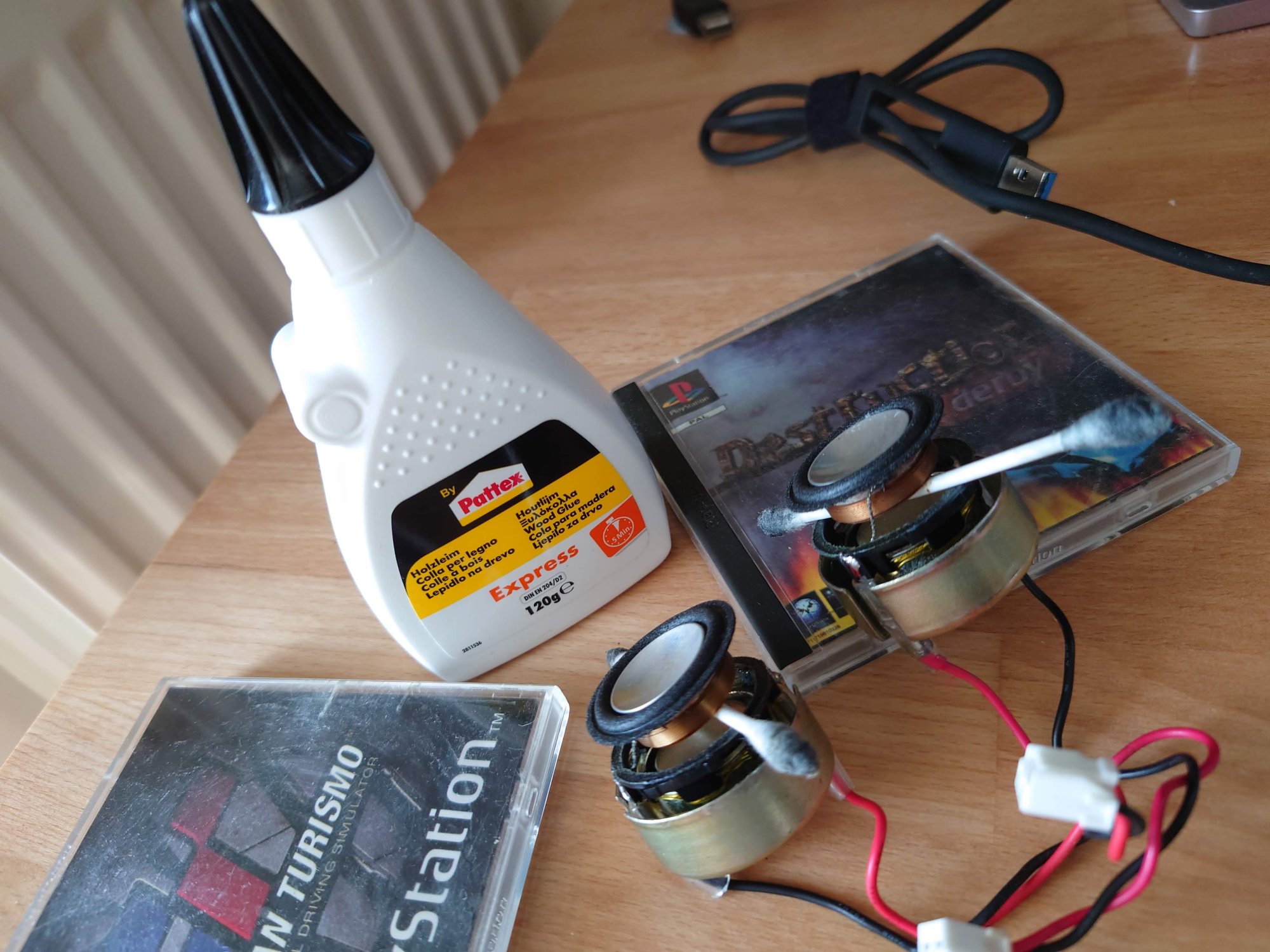

To clean the speakers, I gently levered them away from the magnet - turn a little clockwise and lift. I stuck a Q-tip in there to keep it steady whilst cleaning away the last fo the rotten foam.
Clean all the things. Yuck.

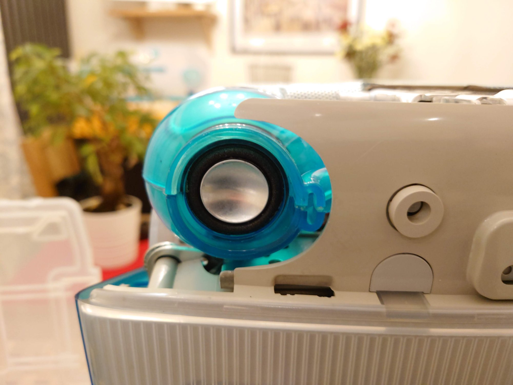

To rebuild the speaker, I left the it in the poked out position used for cleaning. I put a decent layer of PVA on the outside of the inner, and slid the foam over the top. Shockingly, the foam linked above fitted perfectly, with a nice firm seal on the inside of the driver. If you have an iMac likely to need this treatment I'd strongly suggest getting these now, before they are discontinued.
I then, for security, added another decent helping of PVA around the join.
Do this for each speaker. Then let them dry.

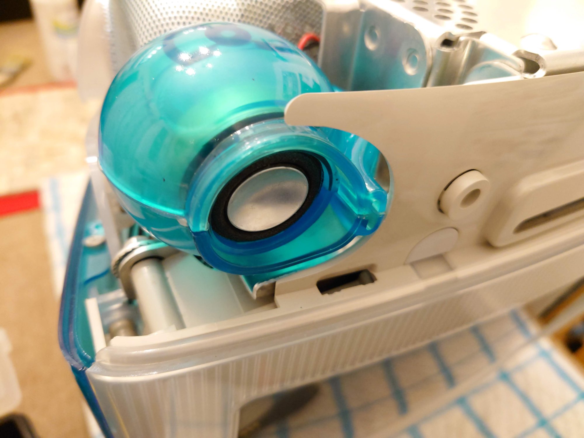

Finally, spread a layer of PVA on the outer plastic rim of the speaker unit, remove your spacer and whilst carefully rotating the speaker unit back into place, glue the outside of the foam down. Sorry, it appears I didn't photograph this part.
Let this dry, and then reassemble the speaker units, being careful to make sure the cables are located in the same place they were when you disassembled them - otherwise your silicone seal won't be complete.
Reassembly is the reverse of disassembly 😉
IMO they sound as good as they ever did. It didn't involve any hacking or destruction and was done in a couple of hours.
Now you're ready to go play Heroes 3 on your fixed iMac.

Hi. Did you fix rattling sound after refoaming speaker? How did you fix that? I have same problem after refoaming speaker
i guess the coil is scratching against the magnet walls. you have to align it really well as the gap is tiny. I know people are folding a paper sheet and putting it into the gap as they are gluing back the replacement to help maintain an even distance to the walls.
you have to take it out again of course that in itself thinking about it could be difficult...at least that is what peolpe are doing with big speakers
i tried it before. Removed dust dome and put paper on center then glued foam. No luck
I used T7000 glue for refoaming. I assume that glue isn't for refoaming. Should i use PVA/Wood glue for next time?
Side note: I cannot throw away speakers. They sound amazing for its size. Replacement ones cost a lot. Cheaper sound horrible, distorted, thin and absolutely zero bass. I need some advice for repairing them. Thanks
doh! i didn't remember the way it was done. of course you took off the dome...thanks for reminding me.
i can attest that replacement ones didn't have the "magic" as refoamed ones so for me it was worth the trouble.
it just shows that there is some handcraft to be mastered. i also lost some volume capabilities after refoaming but at low volumes it still has the quality i was used to.
