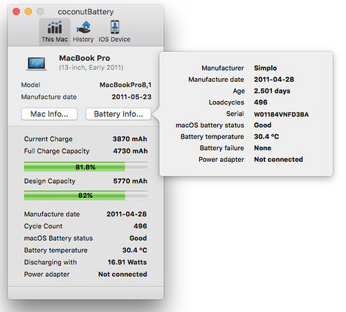

First, download the free "Coconut Battery" app that gives you info on battery health.
Post a screenshot here.

OK, coconut shows this:

You've lost about 20% of the capacity. Those readings may not seem too bad, but consider that my iPhone 6s returned a reading of 89% capacity, but my battery would not come close to making it through a day. After a new battery, a day was easy to achieve. I think capacity is one thing, but it's as though there's another health factor at play that we don't get readings from. I think age is the key, and an almost 7 year old battery probably can't hold that charge like it used to. It sure seems like it's due for replacement.
I respectfully disagree with what Darmok wrote in reply 6 above.
82% of original capacity is still "good enough" for now.
No need to replace it yet unless you feel like spending the money.
The only downside to keeping it is it will require more frequent charging.
