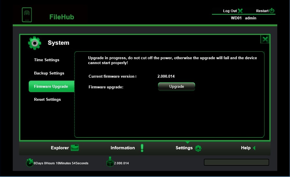

I left the upgrade process to run through for the 5 minutes it stated to run, but it says on the system firmware upgrade page now that I have managed to log on to the setup web page with partly the default setup settings "Upgrade in progress, do not cut off the power, otherwise the upgrade will fail and the device cannot start properly" so confused by that

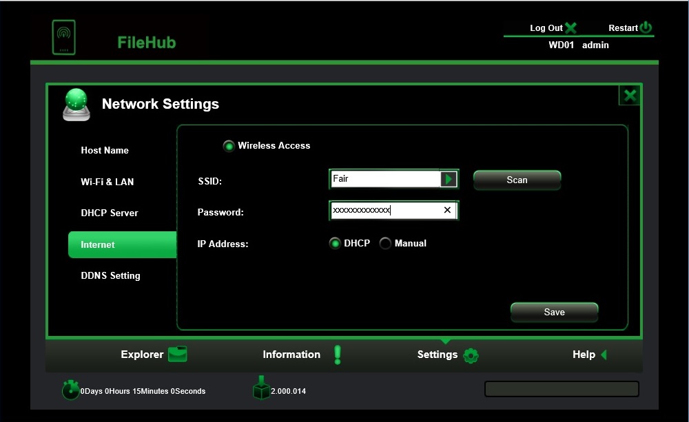

I am still struggling to get the WAN connection to work, no matter what I try it either hangs or refuses to acknowledge a connection although it allows me to select a SSID and type in the wifi password in the settings, or using the wizard, I think I will have to just give up and return it unfortunately.

Did the fw upgrade actually complete for you? Can you send a screenshot of the page for setting up the Internet connection? I don't typically use the Internet function so it was a long time ago that I tested this function and I don't recall the exact steps to make it work, I just know that it did work correctly first time for me.
Thanks for reply, I am sure it completed the update hence my surprise at the statement. I have attached the screen grabs of the pages, the X's being replaced for the password as it is not hidden in the text input. Is there an issue about capital letters on the password or something simple or am I just being pedantic?

Ok, I can't see anything obvious here. I would reset the device as per the system page and set it up again. The password will be case sensitive when configuring the Internet pass through.
Thanks Donka. I have managed to get the Internet connection to work. I did use a pin and reset button on the back of the unit but I am still not convinced it chooses a suitable channel in the wifi settings, anyway I'll keep using and testing it.

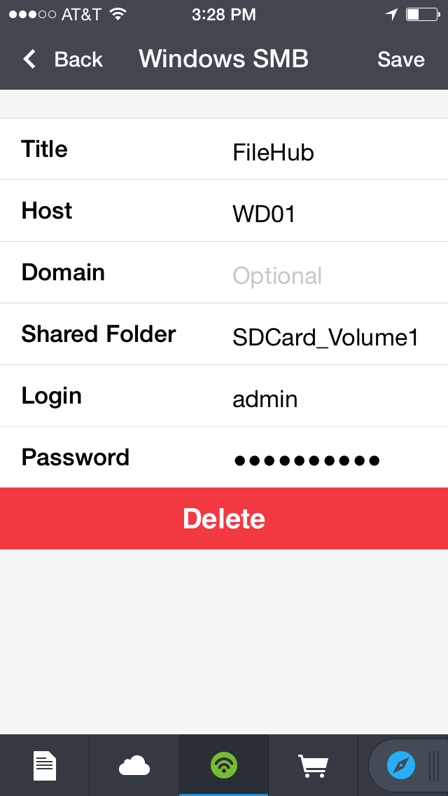

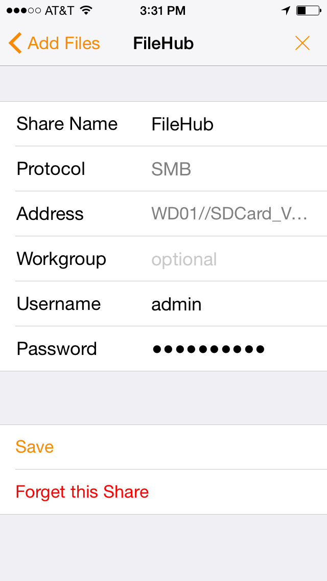

Took me about 20 minutes to figure out how to do this, but here you go... The info you need to use for Infuse and Documents (by Readdle) to see your SD card:
Infuse
Share Name: FileHub (This can actually be anything you want)
Protocol: SMB
Address: WD01/SDCard_Volume1
Workgroup: (Leave blank)
Documents
Title: FileHub (Can be anything though)
Host: WD01
Domain: (Leave blank)
Shared Folder: SDCard_Volume1
On both, your username/password is the same info you use to sign into the router.
Can pretty much adapt this to the other players and set your folders deeper.
