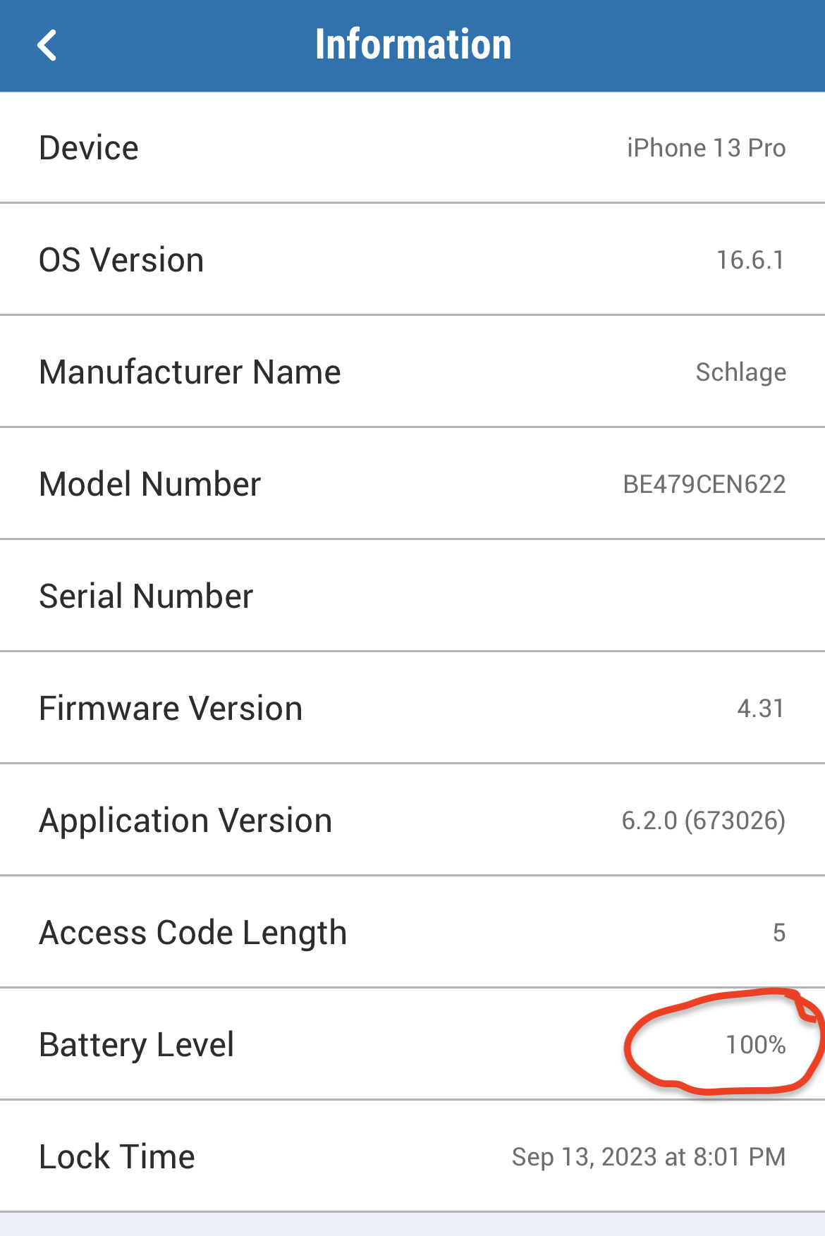

I have a Schlage Sense with batteries I changed well over a year ago. Today it's still showing 100%...
I'd be a little skeptical about whether that's reading correctly.
My 5+ year old Schlage Sense generally gets a bit over 2 years out of a set of batteries; so I'd expect to see something below 100% after over a year.
I've had the lock for several years and been through some battery changes; I've seen the level drop and batteries die. I don't know what would explain this reading stuck at 100 for this long. It will probably reach a threshold and die off quickly.
