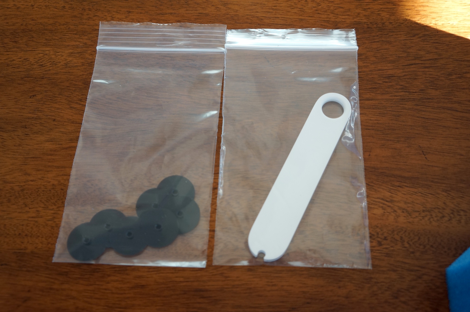

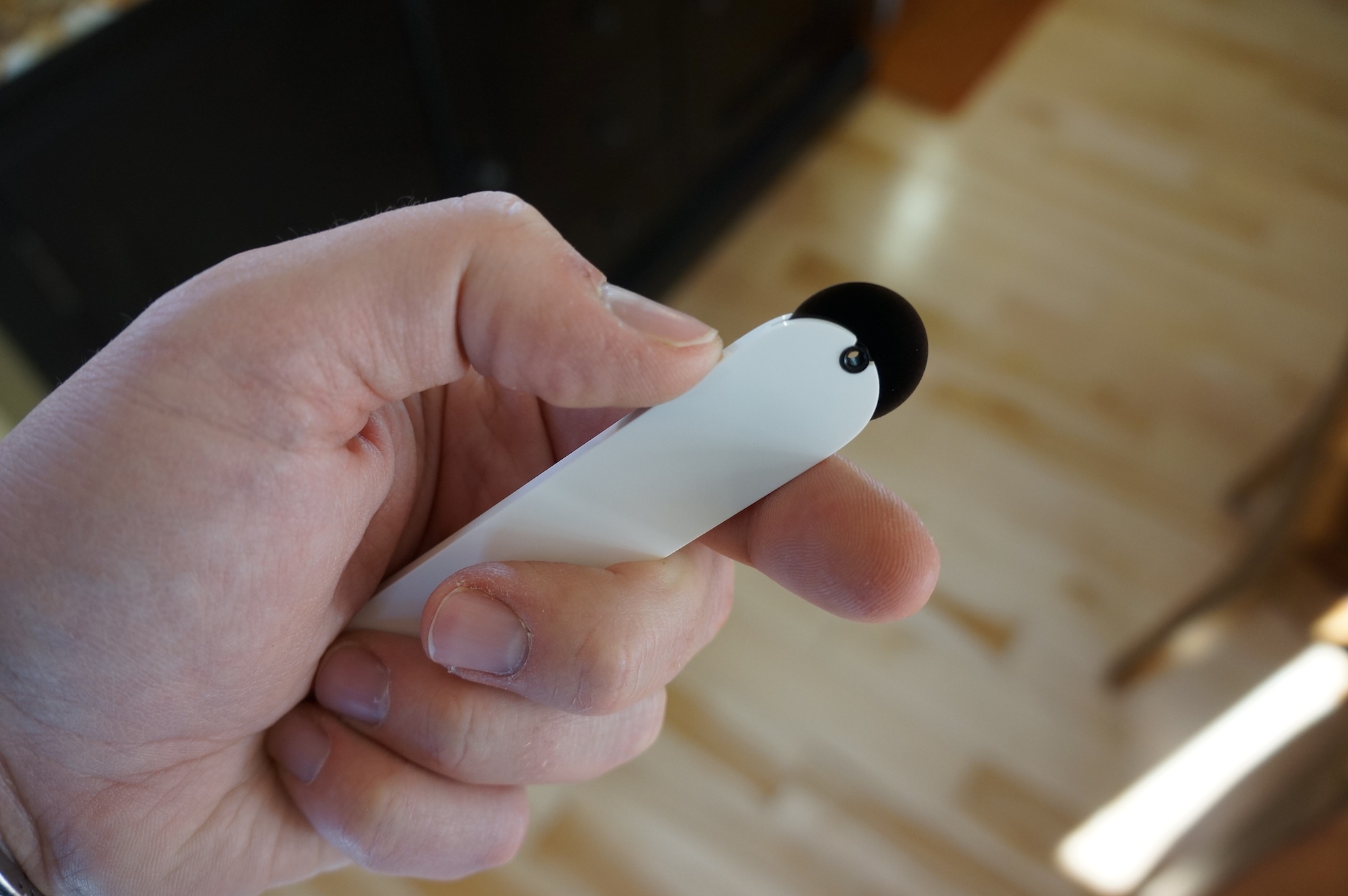

Yes the handle is necessary, the wheels/cutters will wear down after one user, theyre not easily used by hand either.
so yes get the handle and the wheels, it will make the process much easier.

XIII I see waht you mean, the pizza stile cutter is made of handle + wheels... That is totally one other story.. Wheels are useless if not purchased togheter with handle that leads me back to square one..

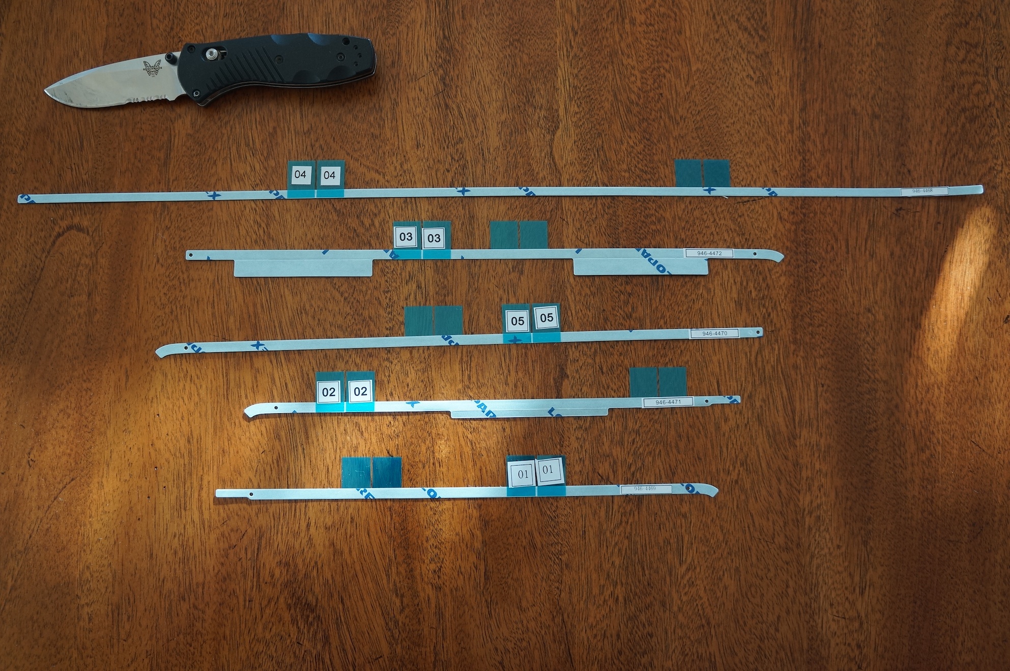

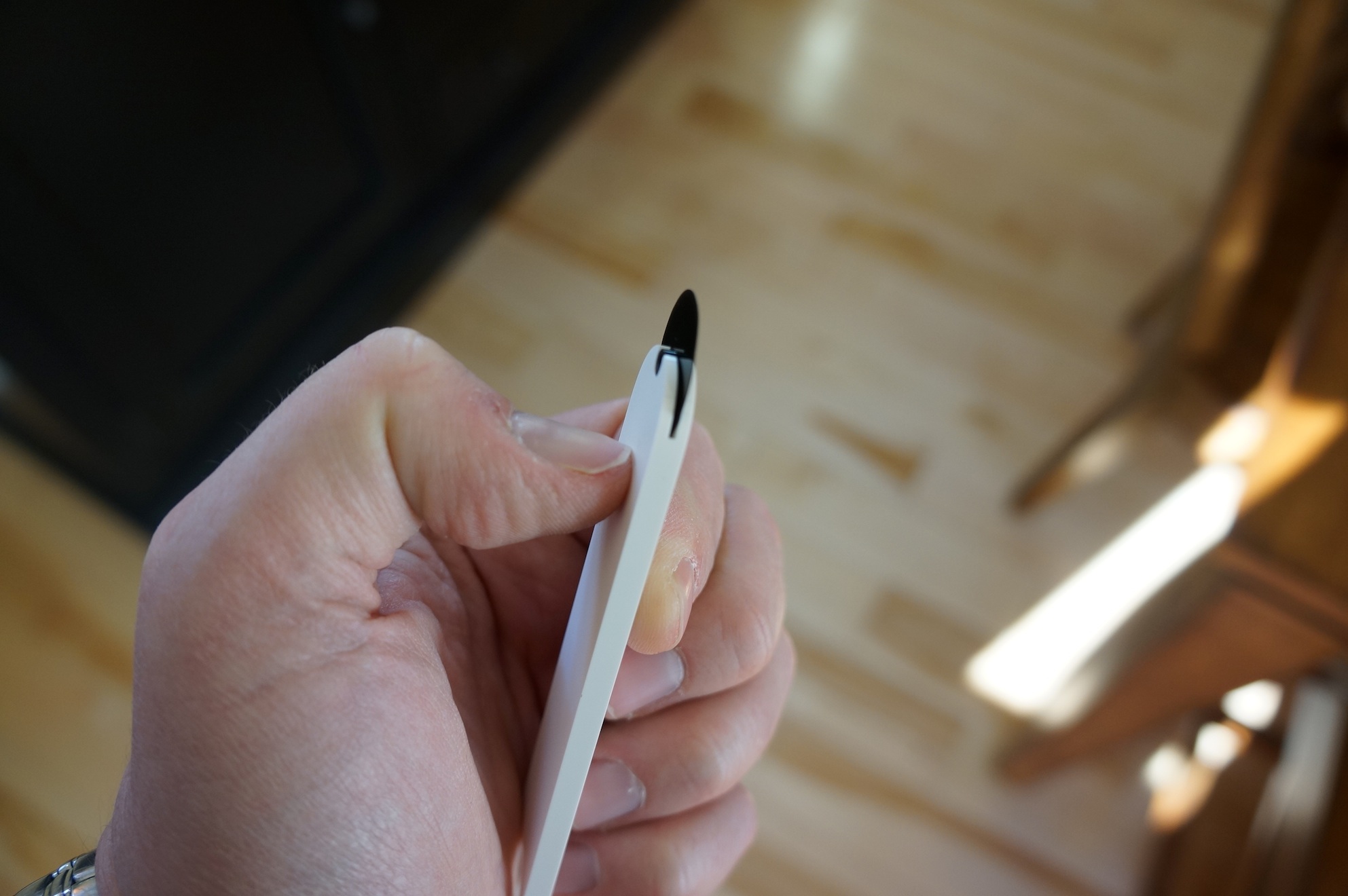

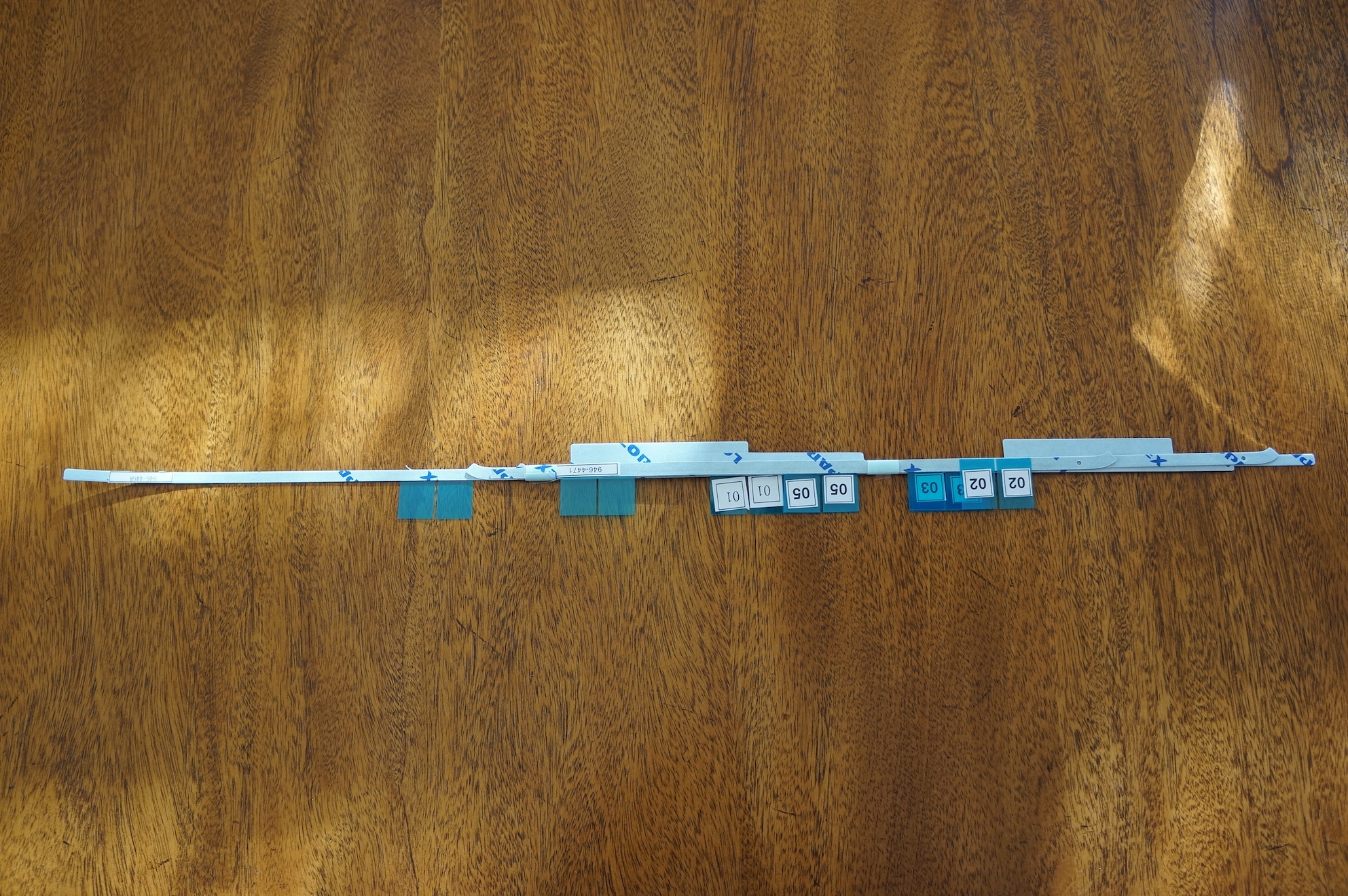

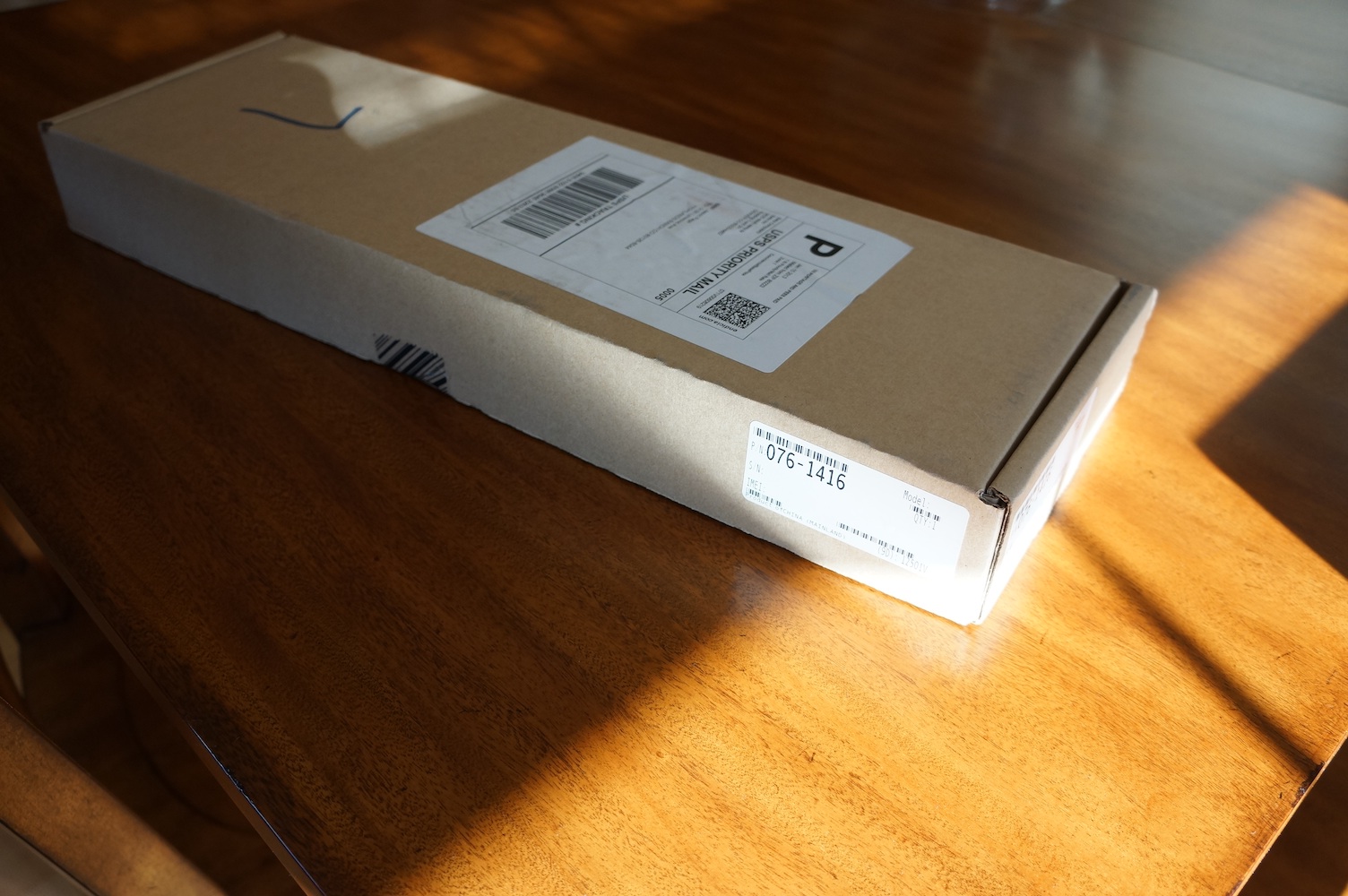

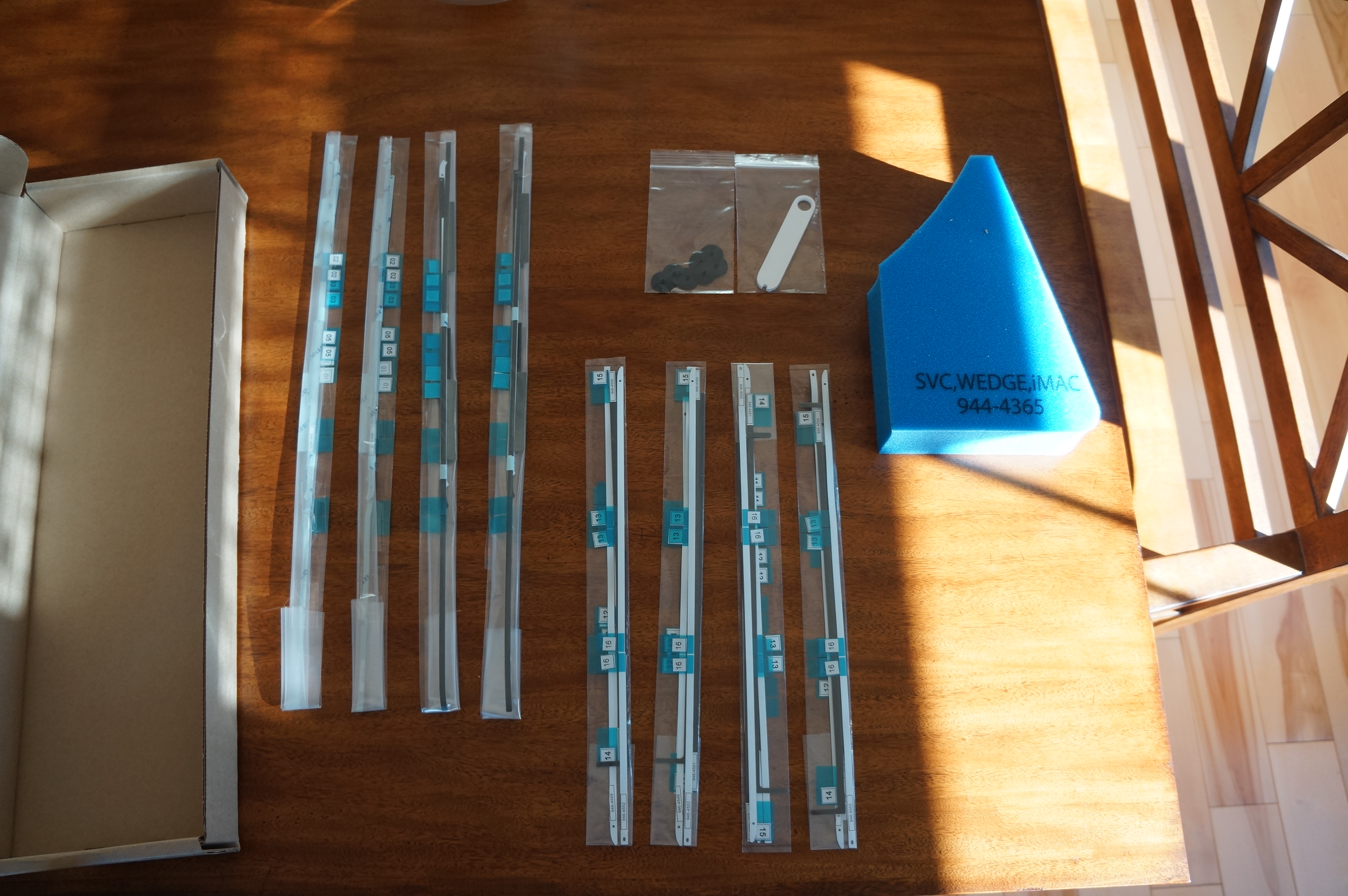

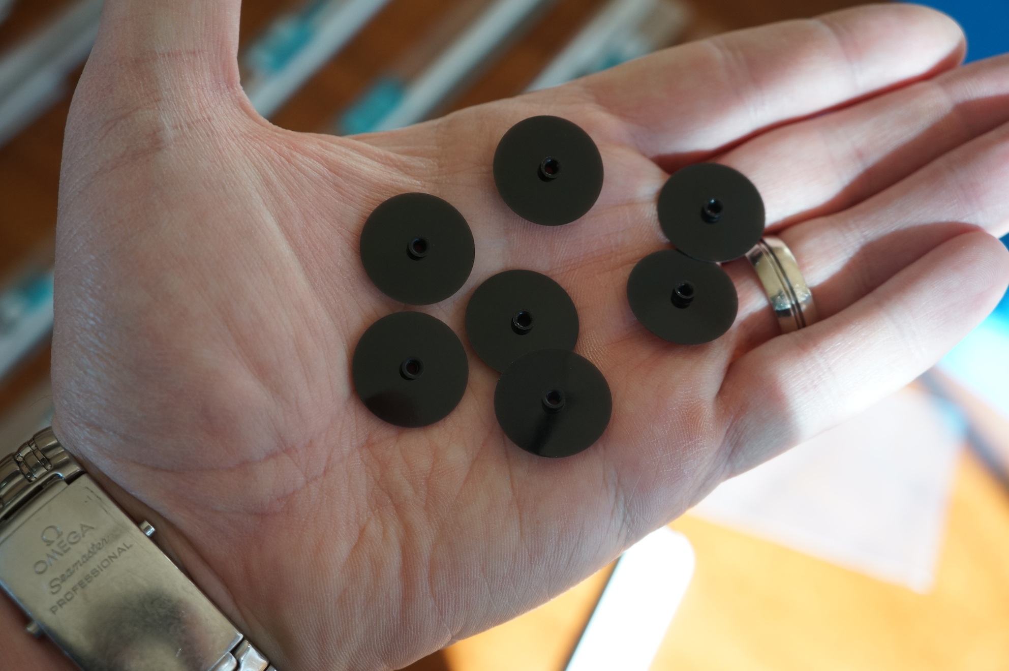

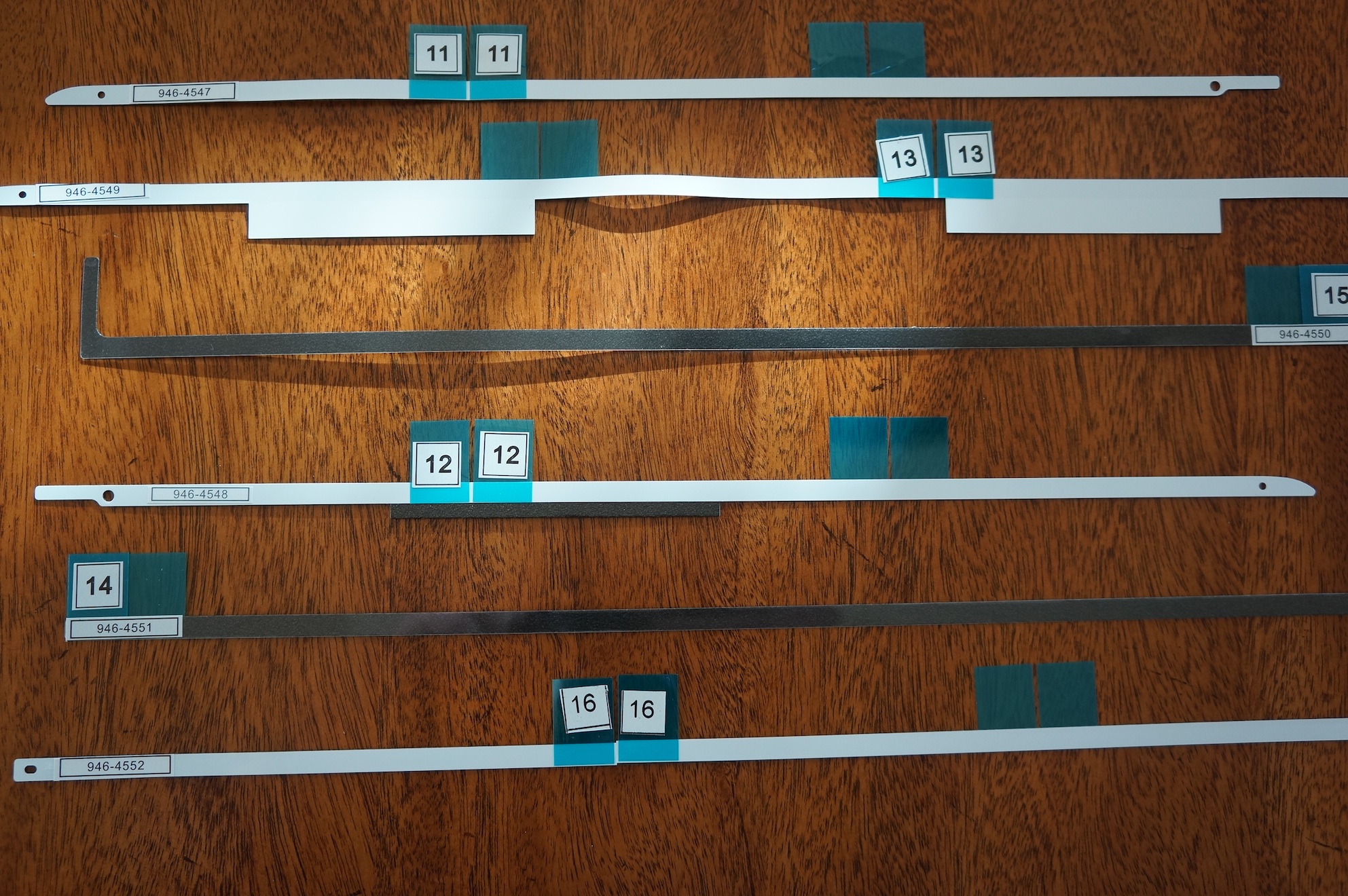

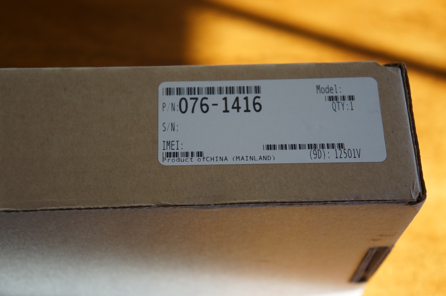

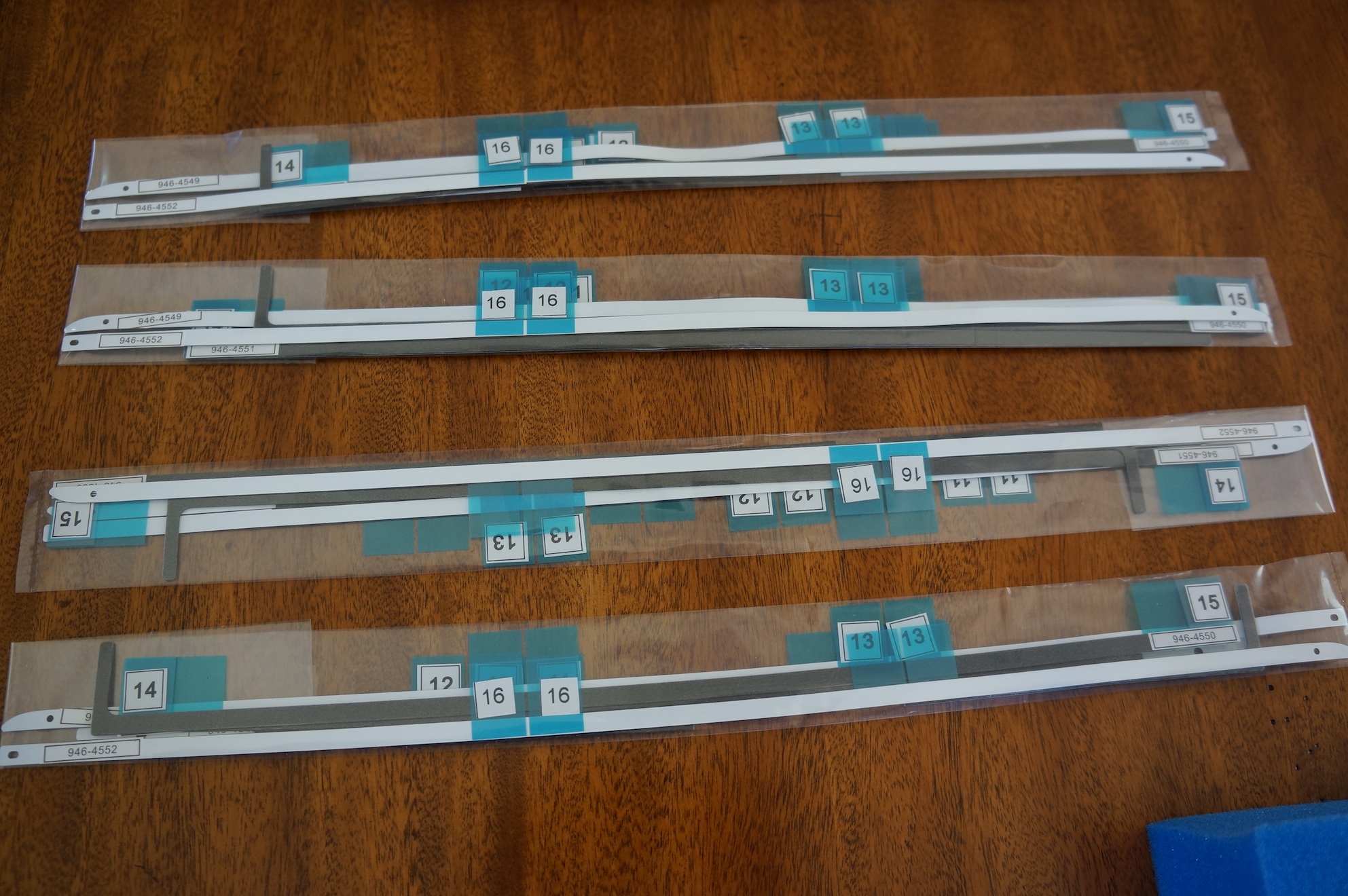

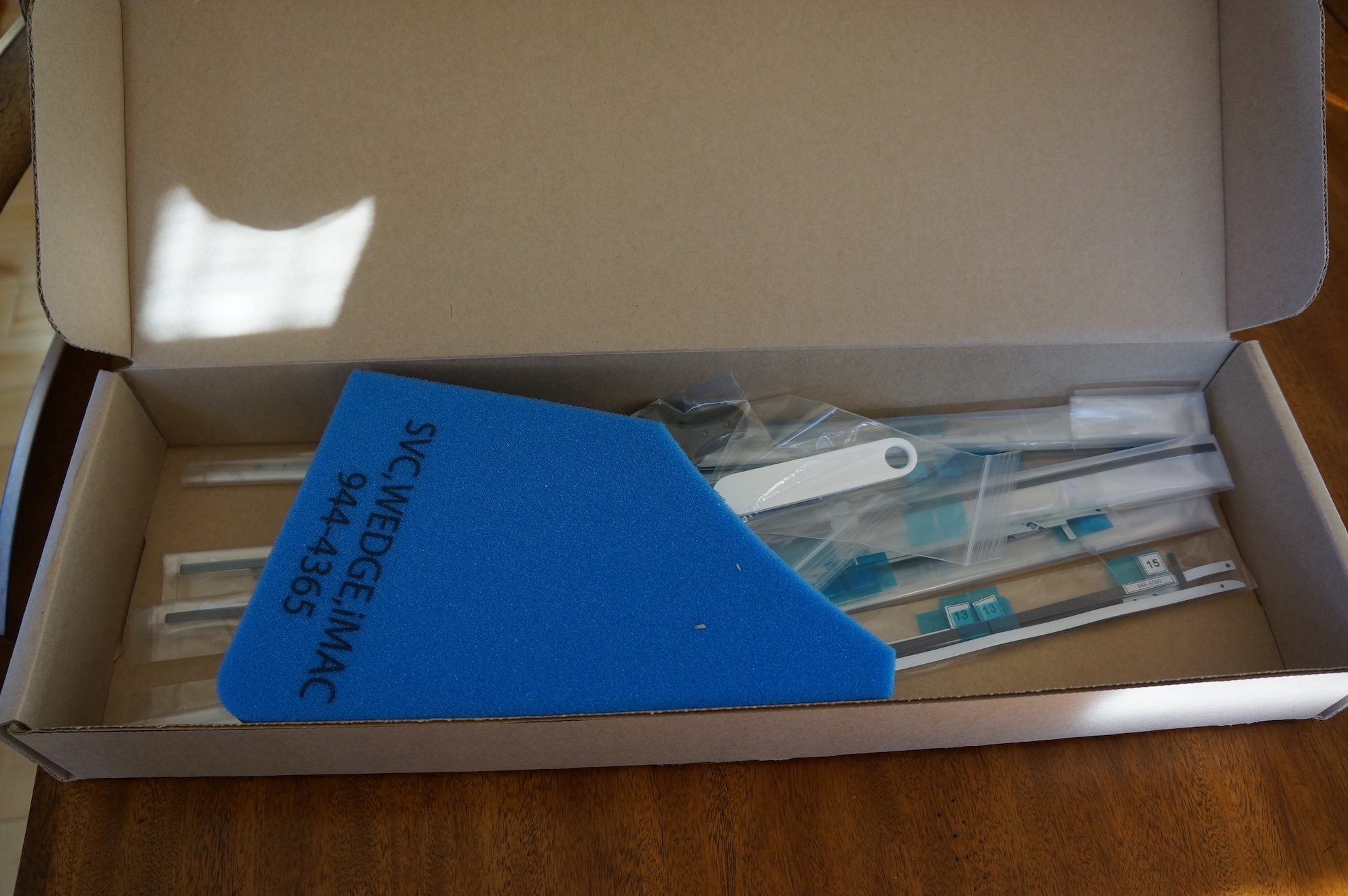

Something showed up early! (It was shipped from down the street, I literally could have driven down there and picked it up locally).
I apologize in advance for the huge photo sizes but since there are part numbers, etc, I figured people might want to see them at near full resolution to get a better idea of what is included.
Here's what $150 shipped gets you;
I believe that these are the 21.5" kits (you only get FOUR with this kit, youch!)
27" kits;
"Pizza Wheel of Death with eight wheels"
Click images for full resolution
It looks like the 21.5" kit in particular might be overkill, there are a LOT of parts here. I imagine that you could cut one set of these strips up and successfully install them on more than one Mac, although perhaps Apple designed it this way as a seal against dust or something.
I will post a thread in the appropriate place (buy/sell forum) for those interested in getting one of the extras from me.

Thanks jmpage2. Can you take a close edge-on photo of the tape? Trying to figure out what off the shelf tape is a good match. I have a few samples of different 3M tape laying around.
So this kit that you ordered from Apple Components has tape for both the 21.5 and 27" iMacs? If I read correctly, there is enough tape to reattach the screen 4 times for the 21.5"?
Jmpage2, could you confirm that the tape is needed on both sides of the iMac, or only has to be applied on one side and the other stick to it?
I don't have the Mac that I ordered yet so I can't answer that other than to say that it's double sided tape, there is no way you put it on the frame and the display.
I will do that when I have my calipers so I can provide the thickness.
Yes, enough materials for four screen reattach for both 21.5 and 27 from what is here. It's extremely overpriced but this is the "real deal" as they say.
27" kits;
[/COLOR]It looks like the 21.5" kit in particular might be overkill, there are a LOT of parts here. I imagine that you could cut one set of these strips up and successfully install them on more than one Mac, although perhaps Apple designed it this way as a seal against dust or something.

PDF of the tools Apple uses, as well as part number and procedure for display removal and reapplying adhesive.
The 21" needs 5 strips:
Description - ID Number - Part Number
Top left - 01 - 946-4469
Top right - 02 - 946-4471
Right side - 03 - 946-4472
Bottom - 04 - 946-4468
Left side - 05 - 946-4470
The 27" needs 6 strips:
Top left - 11 - 946-4547
Top right - 12 - 946-4548
Right side - 13 - 946-4549
Bottom right - 14 - 946-4551
Bottom left - 15 - 946-4550
Left side - 16 - 946-4552
