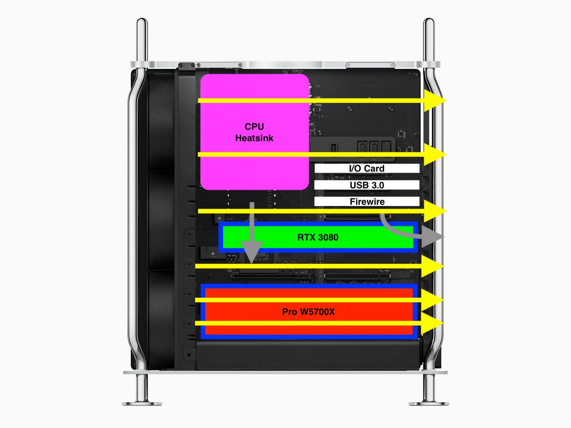

Do you think moving the W5700X to slot 3 and the RTX to slot 1 would help with airflow? Would having the MPX in slot 3 hurt performance in MacOS?

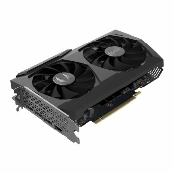

Zotac RTX 3070 is almost a half length card that won’t run hot.
Doing that would limit the cooler supply of air just as much, which I suspect would be even worse.
Having the MPX module in slot 3 shouldn't make any different in MacOS though afaik.
Oh wow I hadn't even thought about other vendor options this early! That could be a lot more suitable. Crazy you could get 2080ti performance out of that little thing.
Yeah, as the other person pointed out, aftermarket would be the best option here.
Nvidia definitely didn't design this card with the Mac pros layout in mind, would've been nice if they did. Why not wait for AMD's offerings?
