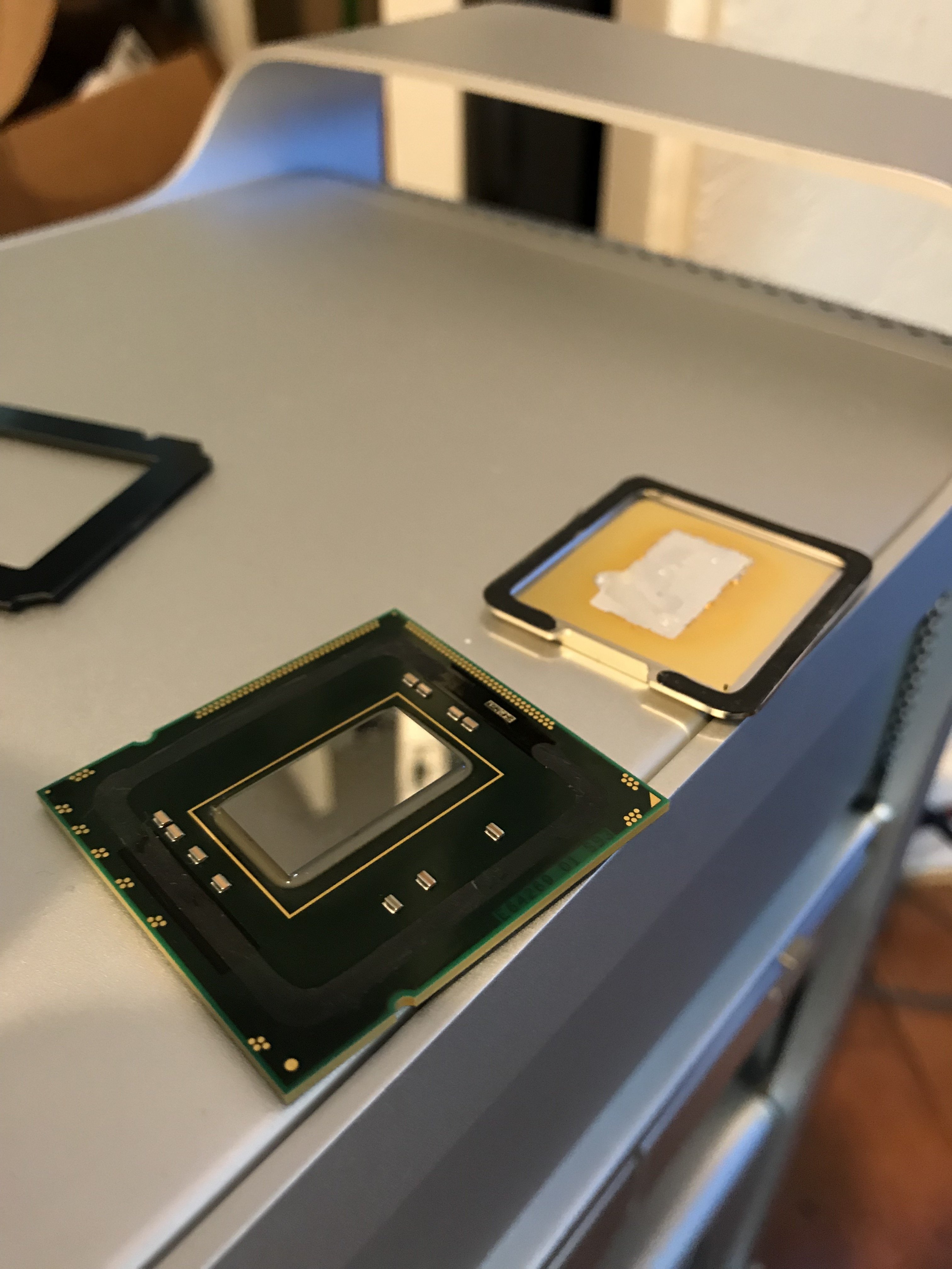

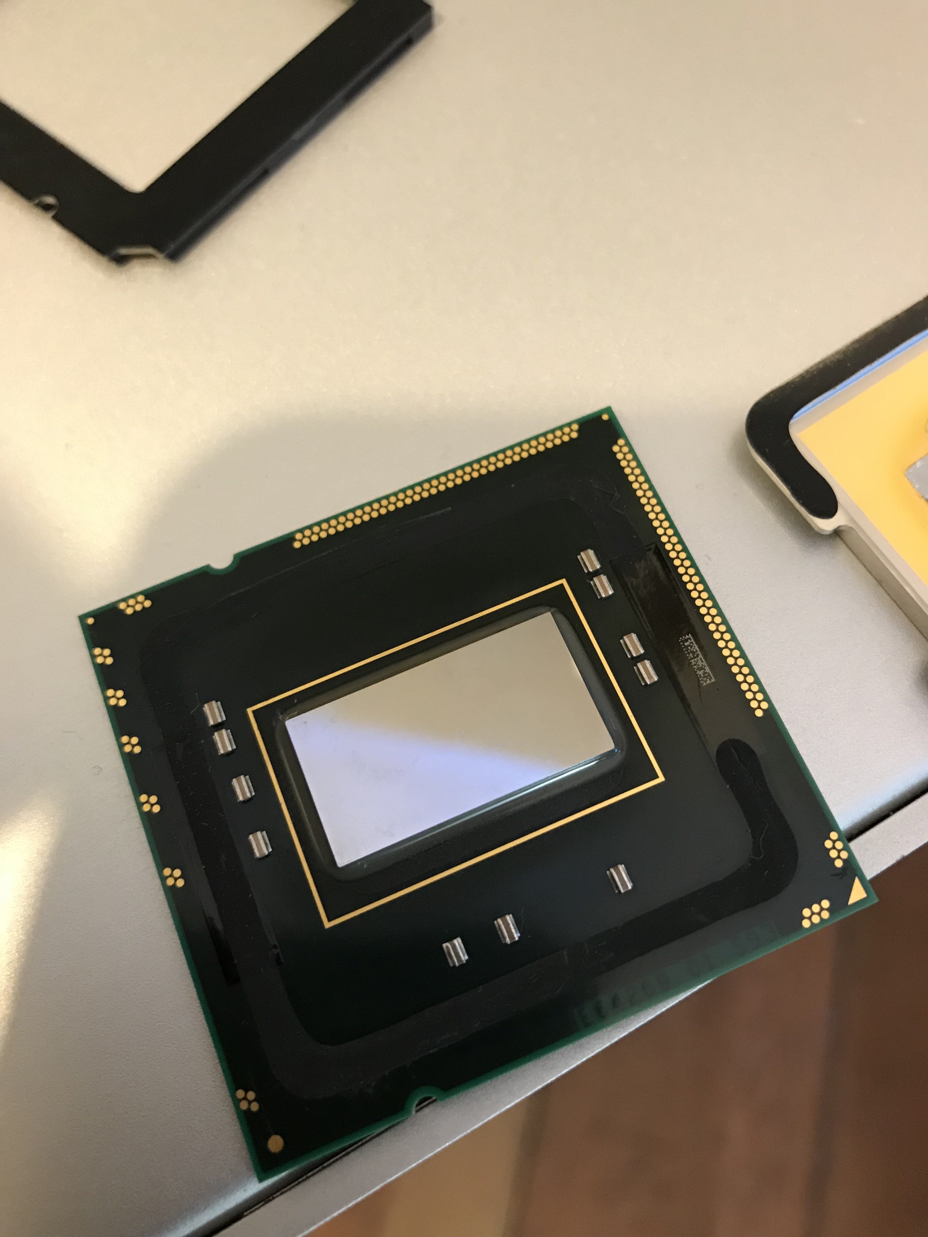

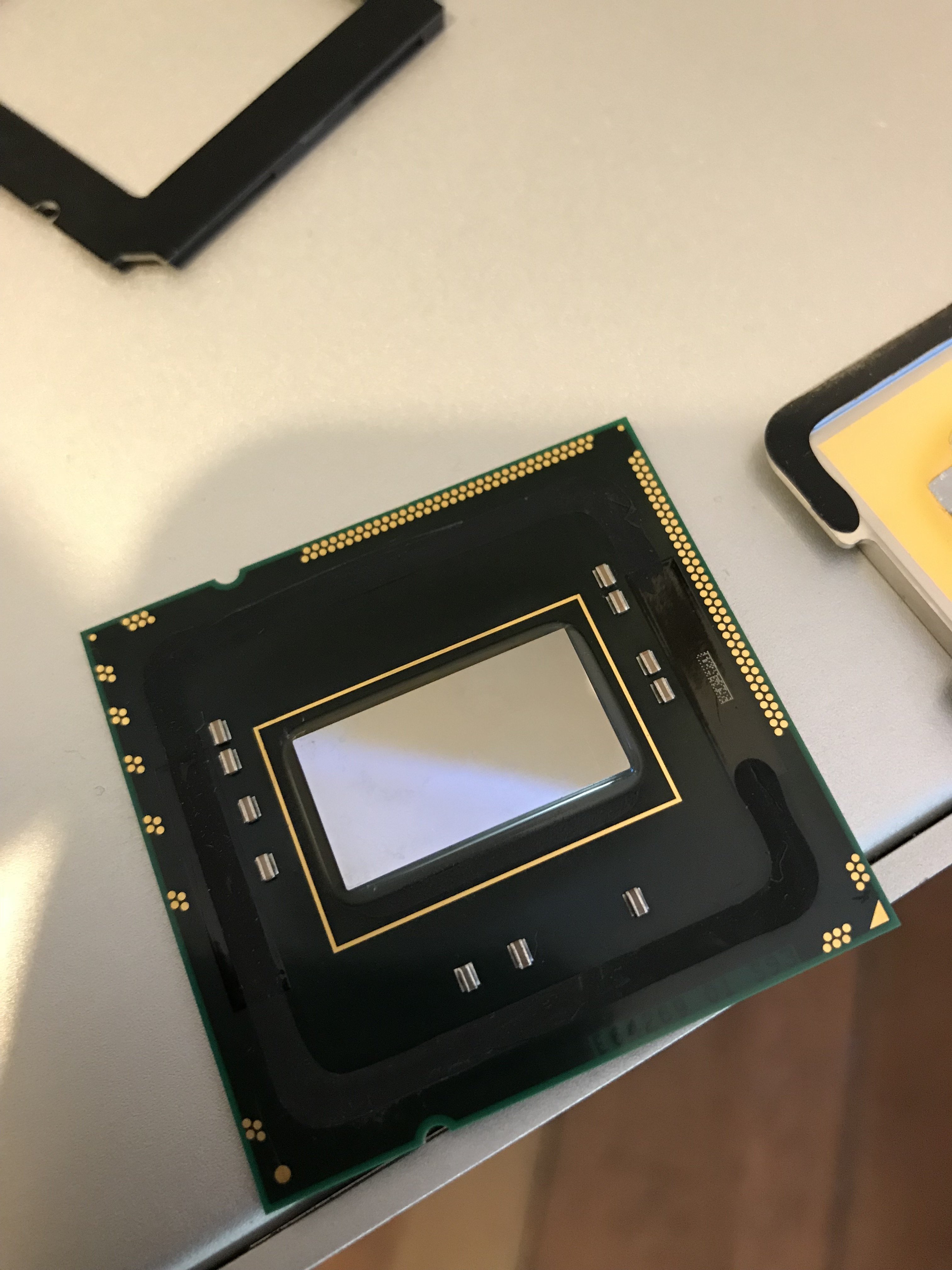

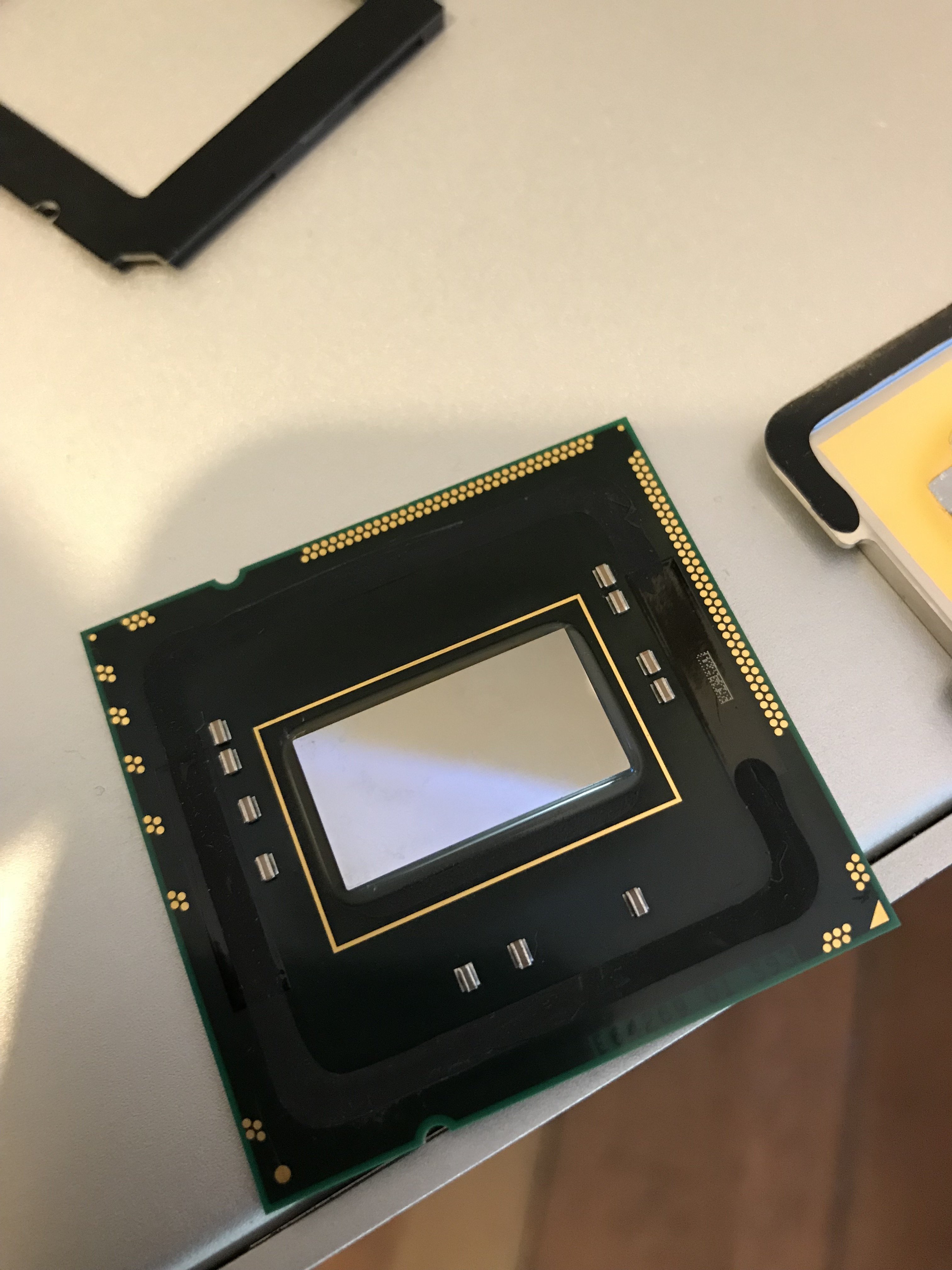

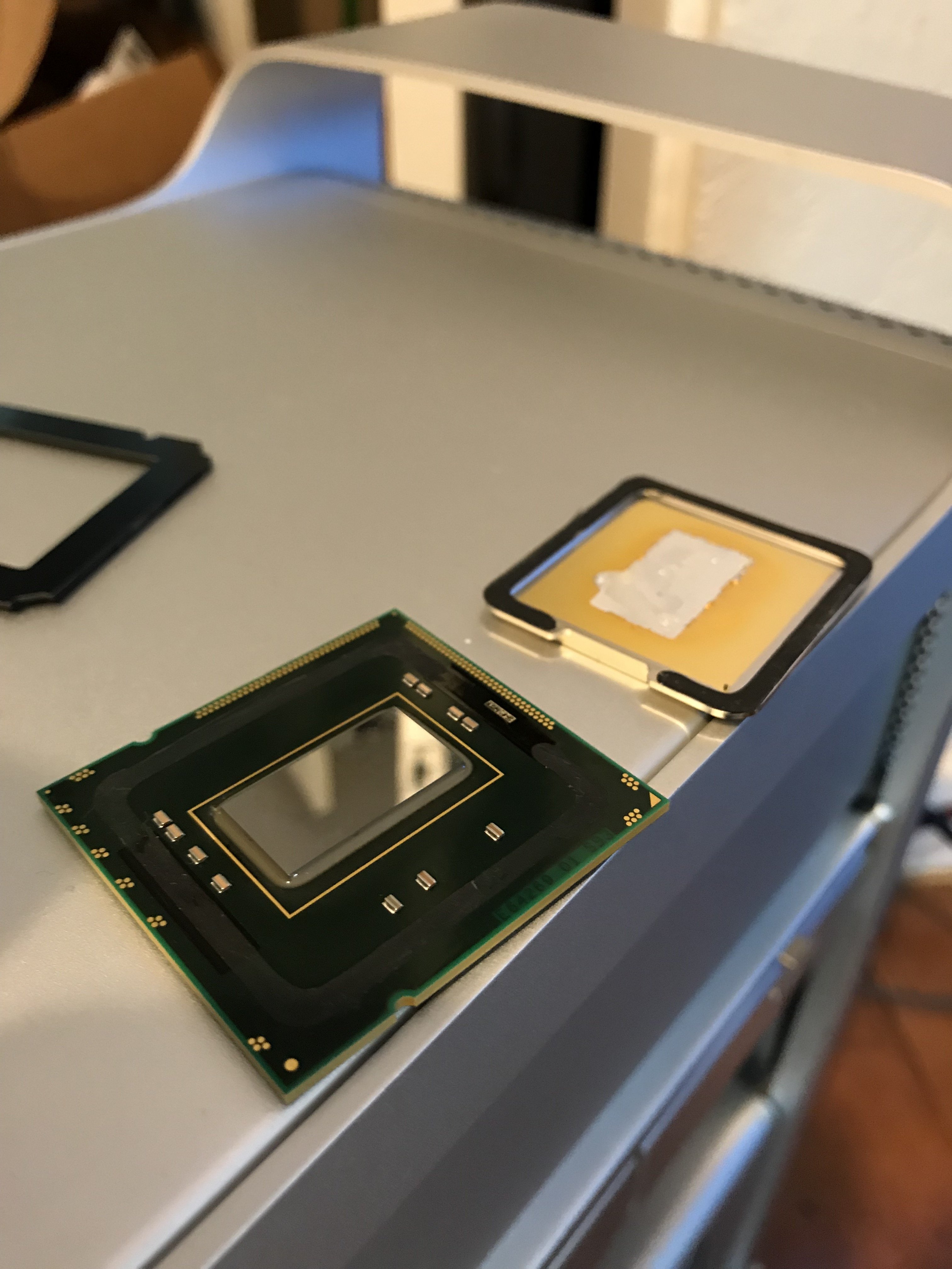

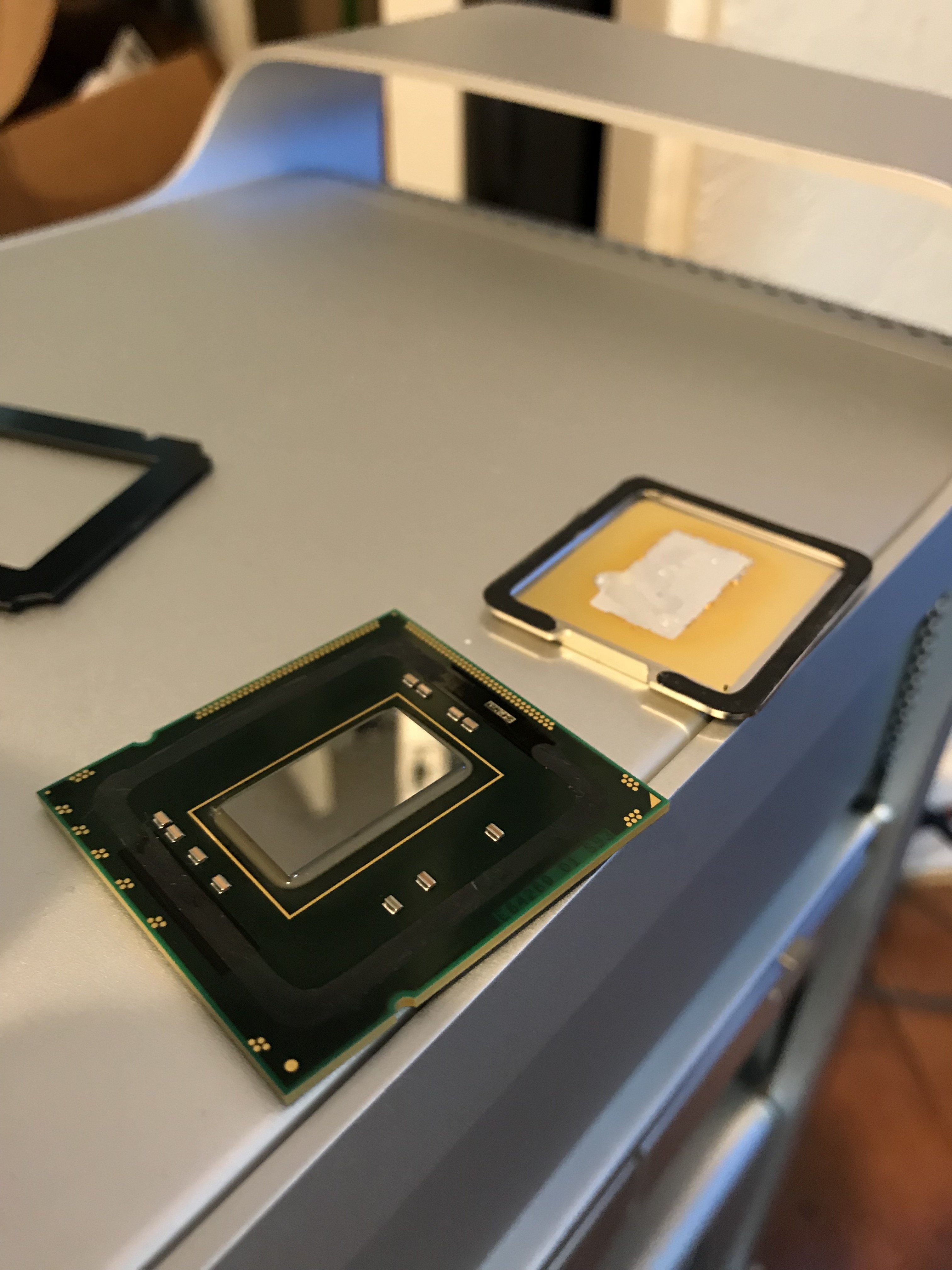

I'm all for the heat method; putting that amount of force on a chip that's fixed with solder scares me and I've seen busted up dies. It looks like you have the heat part down, you just were a little forceful with the initial glue cutting. I used a new DE shaving razor to cut the silicon on the outer edge and it worked really well. It's much thinner than a box cutter blade so it slides right in with no force and flimsy enough that you can feel if you hit something inside. I did a few passes around the IHS to make sure it was all cut then pushed a few box cutter blades along the edges to create some tension before using a heat gun to soften the solder.
You never have to go past the point where the IHS gets taller so thats a good indicator if you're cutting too far in. Could even mark the blade for extra peace of mind. Gently scraped the bulk of the solder with the DE razor again (it comes off like foil) and cleaned the last of the solder off with a quick rub of Mothers polish and got what you see here. Steady hands... those blades are sharp and everything is crazy hot so when it pops off, don't go chasing it with bare hands. Worth it but the opinions of what's best are all over the place.
Oh yeah, and keep in mind the side without the capacitors: that's a good place to start so that you get a feel for how much force you need to use and what cutting the glue feels like with less risk of ruining something.
