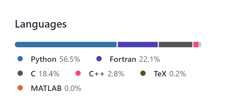

At least there's finally an open-source Fortran compiler available for AS (it seems it's still experimental, but stable)--that wasn't the case 6 months ago. Because of its speed, Fortran is still used extensively in scientific computing.
Having an open source Fortran compiler is pretty basic (think of how many R and Scipy users there are). If I were running Apple, which I'm not, a few years ago I would have assigned a team to identify all the essential, widely-used open source projects, and assigned Apple developers to assist in getting them ported to AS. That way they would all have been up and running soon after the first AS Macs hit the market.
Unofficially patched GCC has been available since November… the problem is that GCC devs couldn’t care less about Apple platforms, so they are pretty much ignoring this. And there is Fortran project within LLVM but it will be at least a year before it’s ready to be used. I am eagerly looking to the time where I can purge my machine of GCC entirely ?

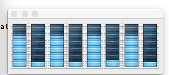

Hm, are you sure about this? Wolfram’s documentation doesn’t seem to mention anything… I’ll have to investigate later
When I run the benchmark, it looks like this (see screenshot below).
But I just looked at the code, and there is *no* parallelization in the benchmark (no function containing "Parallel" is used). [There must be an averaging function in the Activity Monitor such that, while it looks like multiple cores are being used simultaneously, only one is being used at a time.]
Thus while it distributes the workload across multiple cores, it's only using one core at a time. Thus the benchmark itself is assessing single-core speed only. I'll add an edit to my original post.
This of course supports my point that there is something severly limiting Mathematica's native performance on the M1. Its single-core speed shouldn't be (4.5–3.15)/((4.5+3.15)/2)*100 = 35% slower (% diff in quadrature) than a 2019 3.6 GHz i9 desktop, nor should it be only (3.15–3)/((3+3.15)/2)*100 = 5% faster than the CPU on a mid-2014 MBP.
