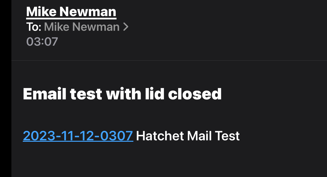

Turns out launchd will run scripts when the lid is closed in the middle of the night. Oddly, it will run this command:

But not this:
Code:
echo $now "Hatchet Mail Test" | /usr/bin/mail -s \
"Email test with lid closed" $email >> $outfile 2>&1

So, the final answer is: ีYes, launchd will run a script when the laptop lid is closed."
