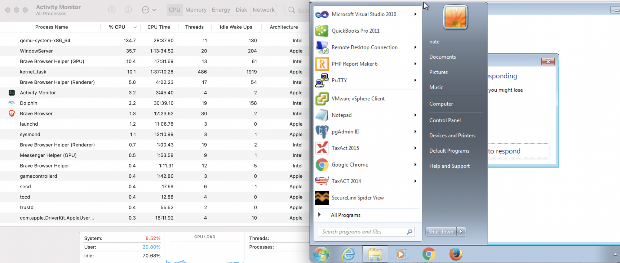

can I see any pictures of windows working in an emulator under m1?
Here is a copy of Win 7 running under straight qemu under Rosetta. The UTM image of 8.1 is sitting on the NAS. It isn't worth my time using for now. I figured I'd save the test in case they get qemu to use more than 1 host cpu core.

Possibly Drivers would help. Win7 was from QEMU/KVM setup has most of those. The key issue UTM helps it has some JIT translation optimizations also it is ARM native QEMU. Windows was much better on it. Still super painful. The keys observation is the qemu process no matter what uses more or less one core. So no only is it slow. I can't spread it as a 4 core VM on 4 cores of hte host which would help a lot. You tell qemu to do smp and 4 cpus or cores. You just divided them on one m1 core. Ubuntu was slow booting too. Unfortunately I have not tried a new setup. Maybe a Lubuntu might be ok.
The screenshot there was terrible on performance. Like 8 min to login/desktop slow. qemu for x86-64 on rosetta then emulating x86-64. My solution was to move my 2 VMs win8.1 and Ubuntu onto a VMWare workstation player on my HP probook Ryzen. I just occasionally use them esp. since going to mac Quickbooks and Moneyspire. I did it to see if it would work and someone posted the link to UTM and I tried it.
