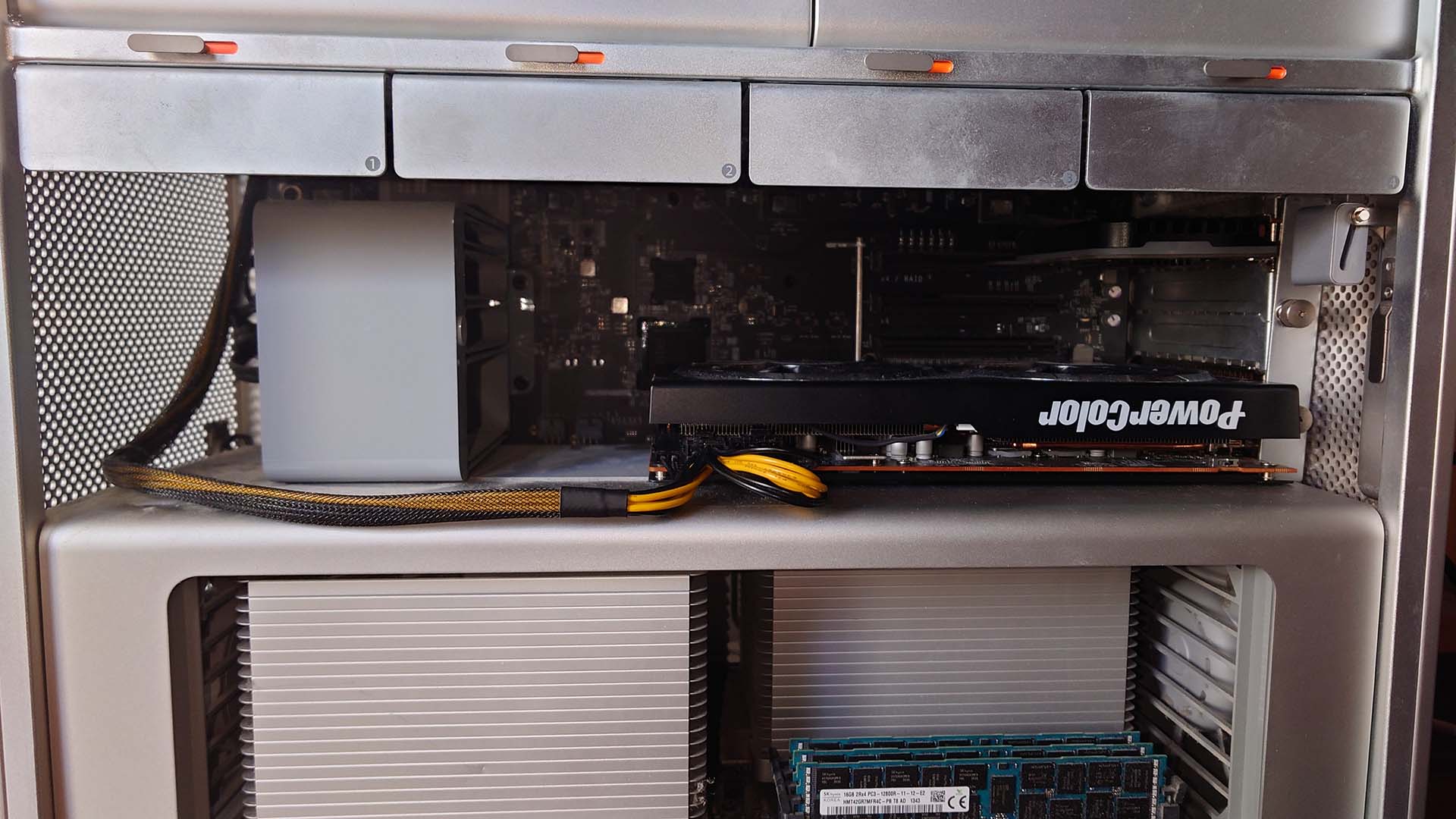

Hello,
at first a few informations about my system. i've a Mac Pro 4,1 flashed to 5,1 running macOS 12.4. I installed OpenCore with the help of the "OpenCore on the Mac Pro" thread https://forums.macrumors.com/threads/opencore-on-the-mac-pro.2207814/ . Currently i have OpenCore 0.7.8, FeatureUnloack 1.0.8, Lilu 1.6.0 and WhateverGreen 1.5.8 installed. My current config.plist is attached.
In the past i used an AMD RX580 (with pixlas mod to get enough power), but this card is going to die. So i decided to use the next generation and bought a PowerColor Red Dragon RX 5700 XT. But after installing the graphic card the graphic card didn't output anything. Even macOS is fully booted up i - nothing. I can connect through SSH to see, the graphic card is not detected at all! By using the command system_profiler SPDisplaysDataType i simply got no ouput.
So i thought maybe it is the specific graphic card model and i bought Saphire Nitro+ RX 5700 XT. But with this card i have exactly the same issues. Both cards, the Saphirre as well as the PowerColer, works great and without issues in a PC.
I hope some here can help me, why my RX 5700 XT are not detected. In the config.plist i specified in the DeviceProperties part the PCI-Path to the NVMe SSD and the RX 580. Can this be a problem?
Thank you very much for help!

i used pixlas mod to add enough power. I also tested the voltage on each pin. All 12V Pins are connected. (And the ground of course too.)

Meteorus
macrumors newbie
Dec 29, 2021
8
I upgraded to the last OC Version and still had the issue. But after powering the GPU with a PC powersupply it works just fine! So i measured again all my pins from my pixlas mod cable and detected, that at least 1 mass cable is not connected and the gpu was not (fully) powered.
So @startergo thank you very, very much for your help and time! I didn't exptected a problem like this.
