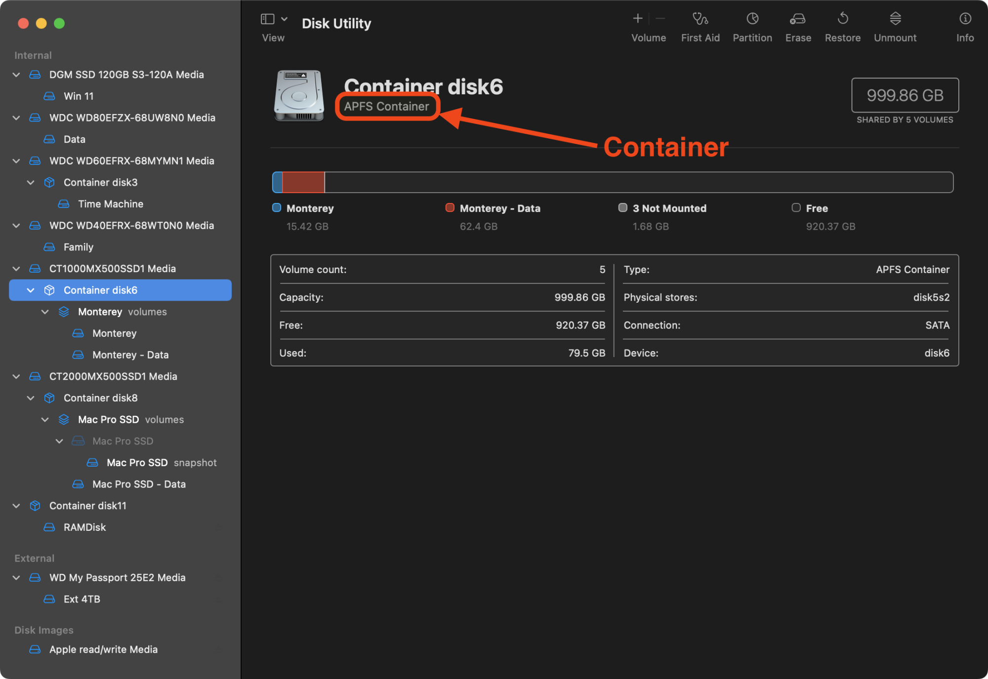

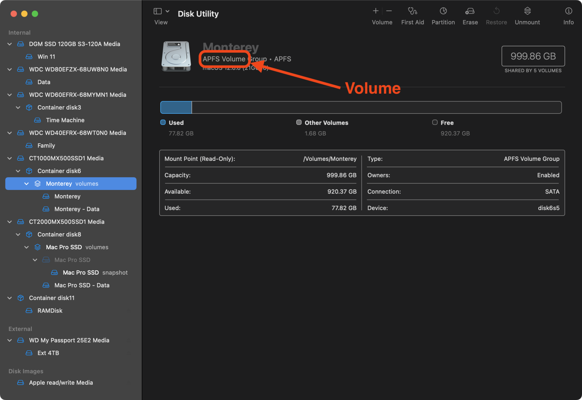

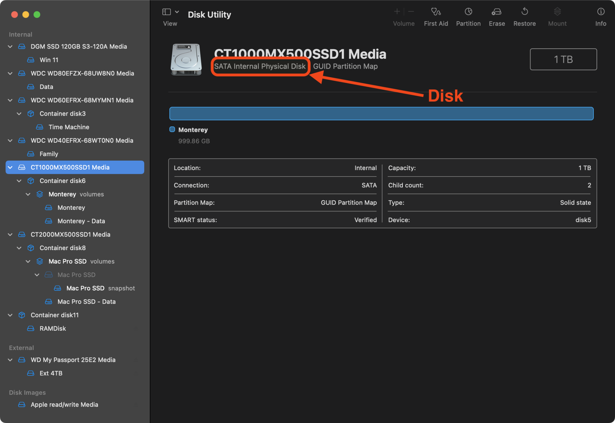

Depends, Disk Utility default to erase "partition" (Physical Volume / Container) only, but not erase the entire "drive" (Physical Disk). In that case, the EFI partition won't be formatted, and all OpenCore (no matter good or bad) stuff will still be there.
However, if you click the "Show All Devices" first, then select the "Physical Disk" to erase. Then yes, the ESP will be erased.

As you can see from the above screen captures. All Disk, Container, Volume are erasable. Therefore, if you pick the wrong one, the ESP won't be touched.

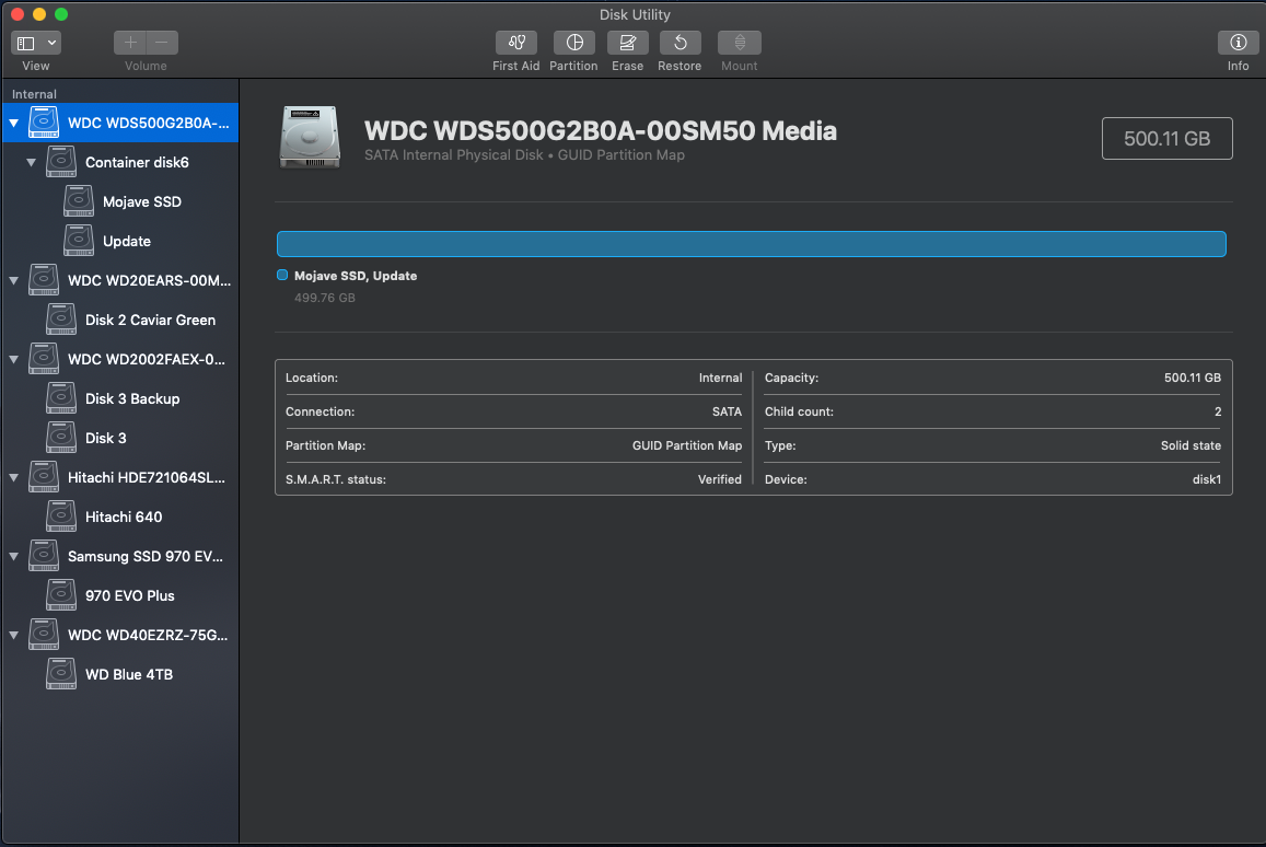

Currently only the WD500 has an OS, the others are just storage. I can erase the entire disk from the top (highlighted) and that should clear out any traces of OC including the post-install patches, right?
Correct

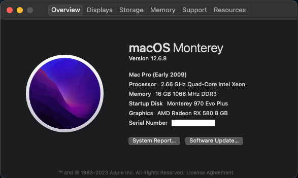

Finally back on the Monterey train with new RX 580 and MLOC question withdrawn for now - but I have 1 more question. I'm running MLOC 0.9.4 but there is no BlueToolFixUp or BlueTooth-Spoof in config.plist. I have legacy bluetooth.
