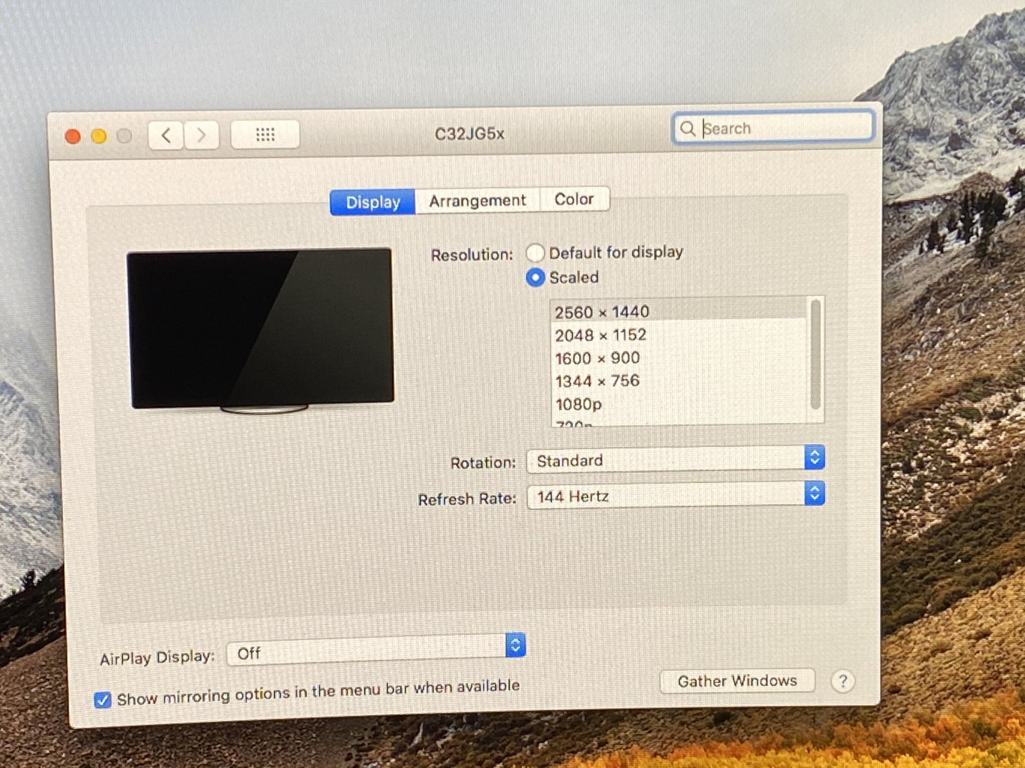

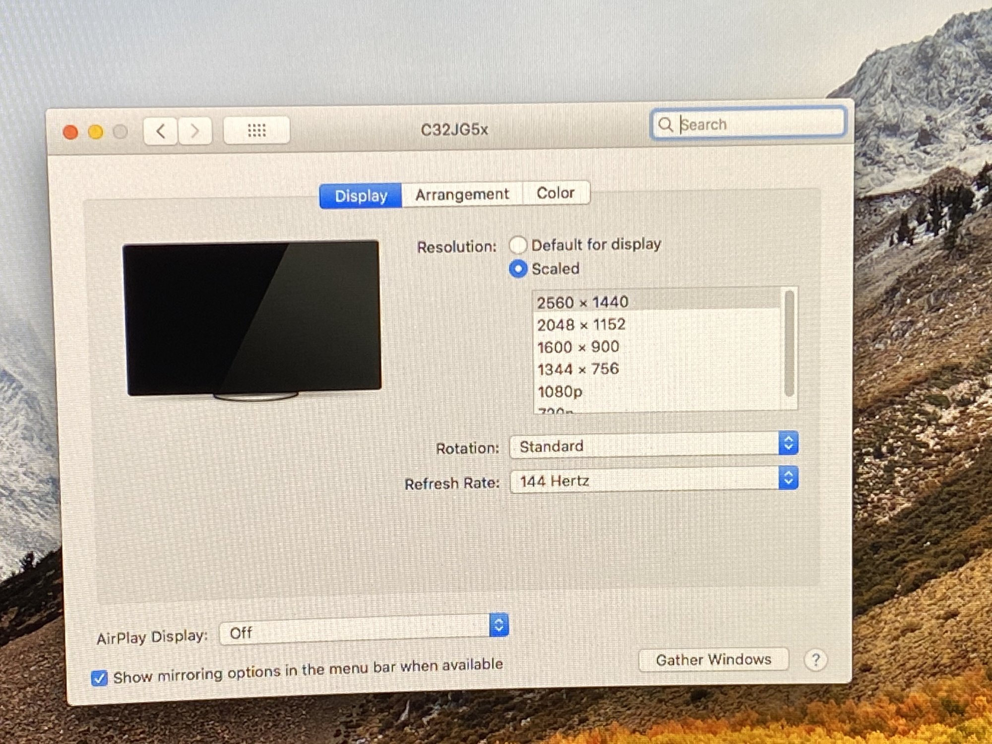

You are absolutely correct. Get this lol, so remember i put it in the windows pc and it didnt display then i plugged in both monitors and it did? Well i thought i wonder if i plug both monitors in on mac would the same happen. So i put it back in the mac, ensured all my commections were secure and swapped the 2 mini 6 pins round and plugged them into the opposite ones even tho i dont think it matters. Plugged in both monitors at the same time which i hadnt been doing on mac and as soon as i pressed the power button the fans spun up immediately and then the chime and a few seconds later the password screen. And bang were in. Im not sure if it was the 2 monitors, the swapping of the plugs or if being in the windows pc first kicked it into life. Ill try booting up with 1 display just to double check that and maybe swap the cable plugs back just to check that in case someone has the same issue and finds this View attachment 918455
