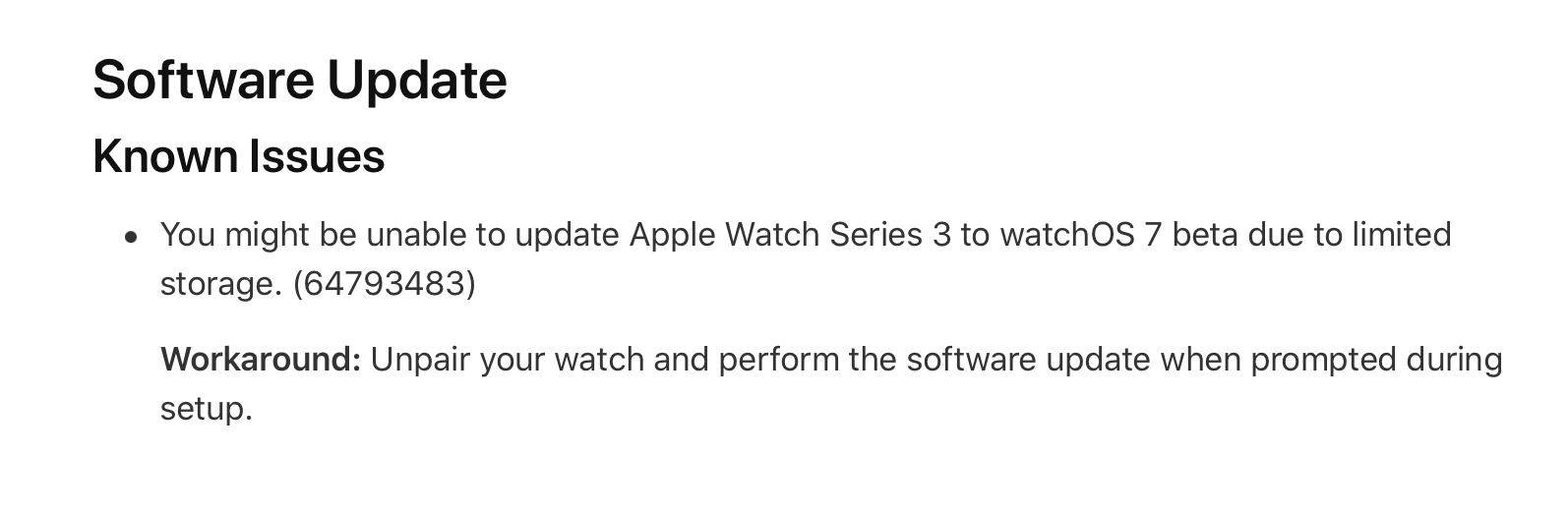

Im glad they are owning up to it. I hope its just a simple software bug that needs to be fixed. Im still stuck on beta 1 on my watch and we are on Beta 3 but can't update unless I unpair.Went back to the Apple Store today and because they were so busy a Genius met me outside to tell me that Apple had admitted to the issue 2-3 weeks ago and are actively working to fix it. While they could send it away for repair/replacement, because it’s out of warranty there would likely be a charge. So my watch will sit on my table until Apple releases a fix, which considering they just acknowledged this problem a few weeks ago after people have been having an issue for over a year according to these Forums, is probably the single most frustrating thing I’ve encountered in my years of owning Apple products. So to all - don’t continue to waste your time with Support or the Genius Bar. We all have to “hold tight” for a fix from Cupertino.
- Addresses an issue where unneeded system data files might not be automatically deleted when available storage is low

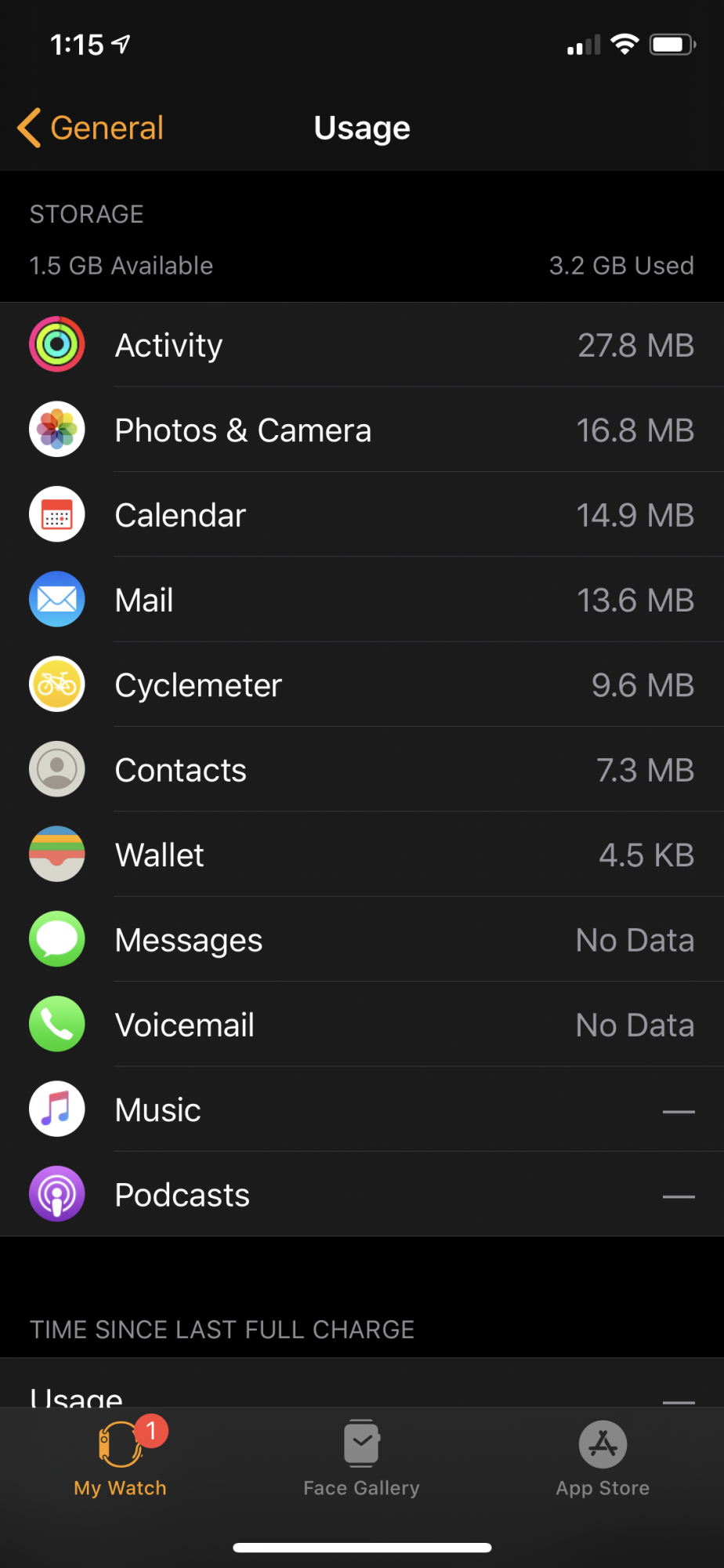

Well looks like it’s impossible to install WatchOS 7 without doing a repair as new watch. Ugh!
Same, I didn't have enough room to install so I had to unpair, repair, then download Watch OS7. Right before I unpaired, I had 2.0GB being used, down to 729MB with 2.6GB displayed separately as Software Update after repairing, then back up to 1.8GB used after installed Watch OS7.Yeah, I had to set mine up as a new watch in order to get Watch OS 7. What a nuisance.
It's infuriating to know they're still selling Series 3 (with improvements) and that they're aware of this issue.
After unpairing and repairing to update, I got the Sotrage Full message again on OS 7 and had to fully reset. I’m curious to see if anyone who may get an SE or 6 will continue to have an issue after it persisting with their 3. I may be that person if it keeps up, ha! So so frustrated.So I spent half of my day resetting up my watch to get WatchOS 7. This is completely an unacceptable user experience.![]()
I really want to know what percentage of 3s this is affecting. Wonder if it’s happening with any of the newly purchased ones.Mine also filled up the other day and I had to do a hard reboot. Still not fixed with WatchOS 7.![]()
