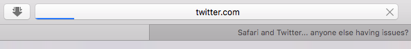

Intermittently, yes. Such as right now, it has been like this for a minute:
I get the same thing with Twitter. It hangs, then an error page, but if I refresh the page it loads. With the latest update didn't help. It sometimes loads right away and other times it hangs. Website that embed tweets also seem to hang as well.

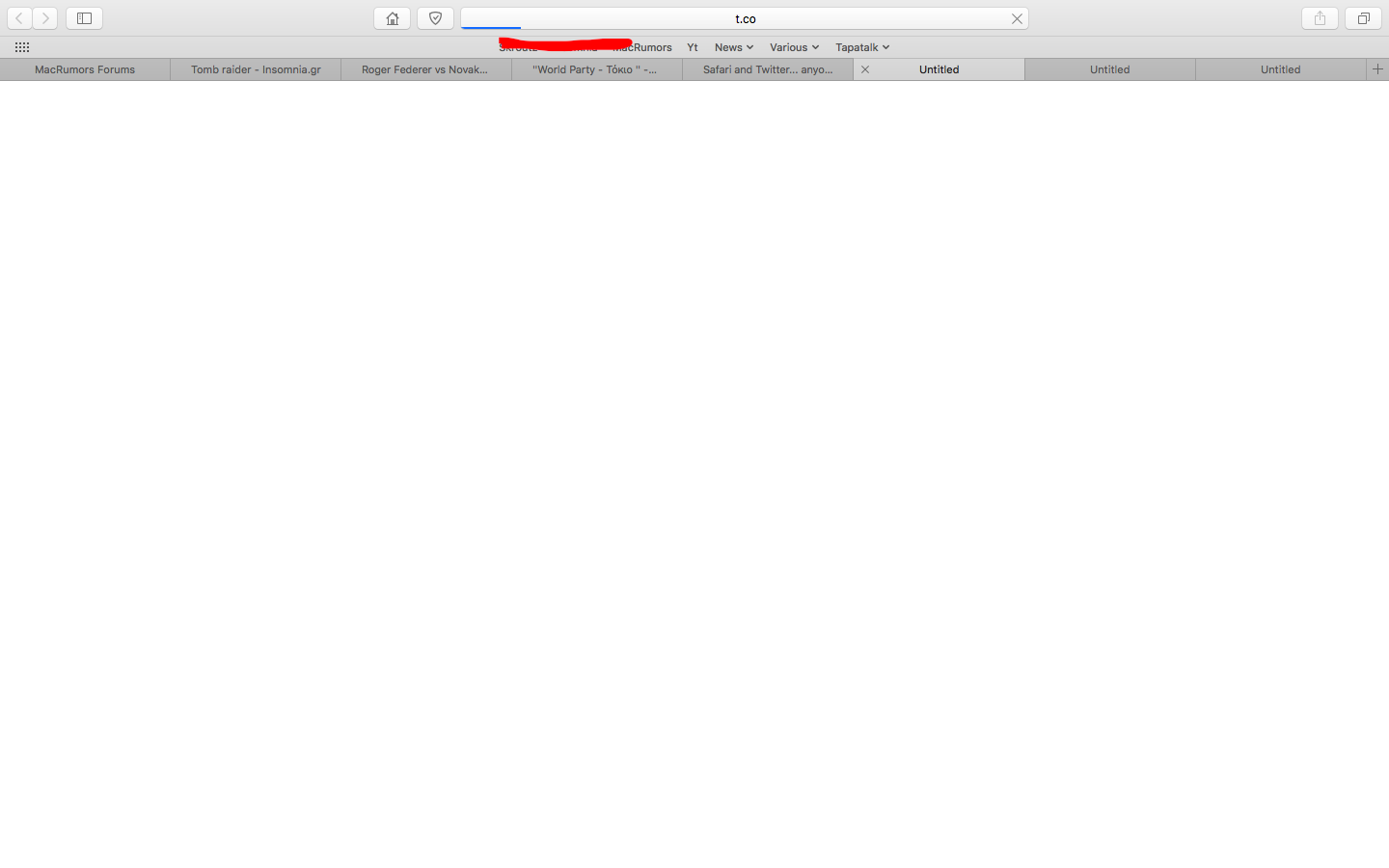

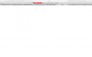

Every day the same thing with tweetbot links....
