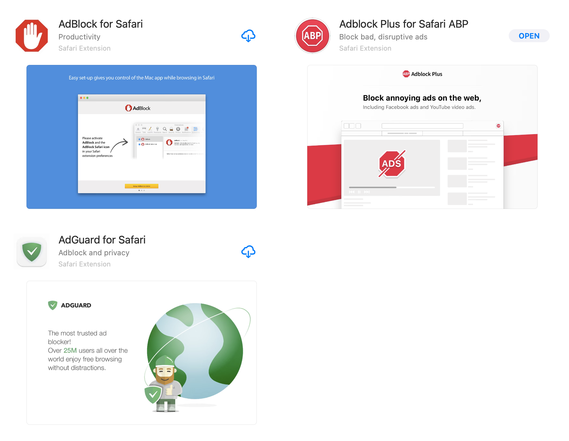

Extensions I have tried: AdBlock for Safari, Adblock Plus for Safari ABP, AdGuard for Safari, 1Blocker for Safari

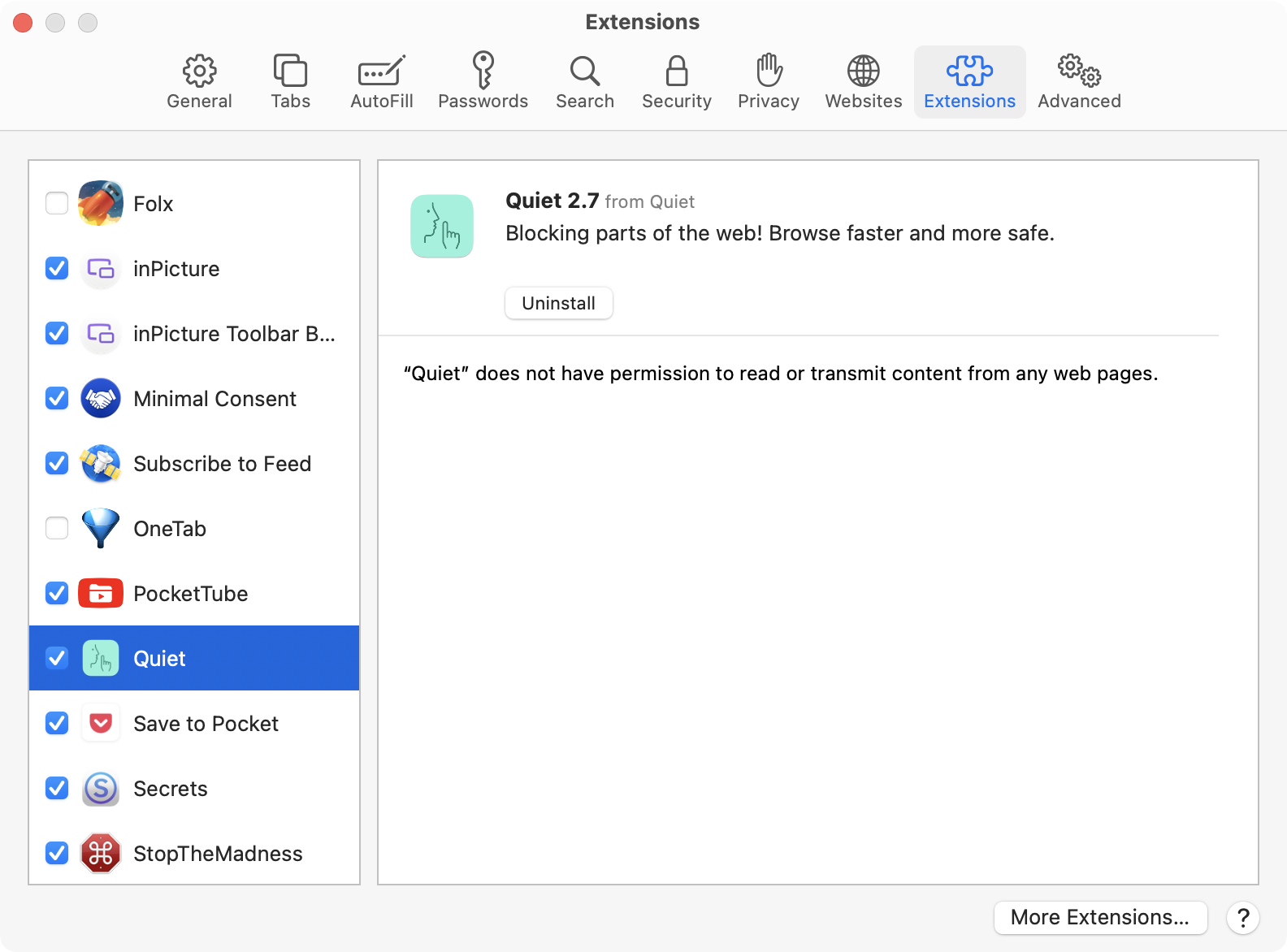

Could you show us Safari's Preferences / Extensions page
I've attached my own for reference.

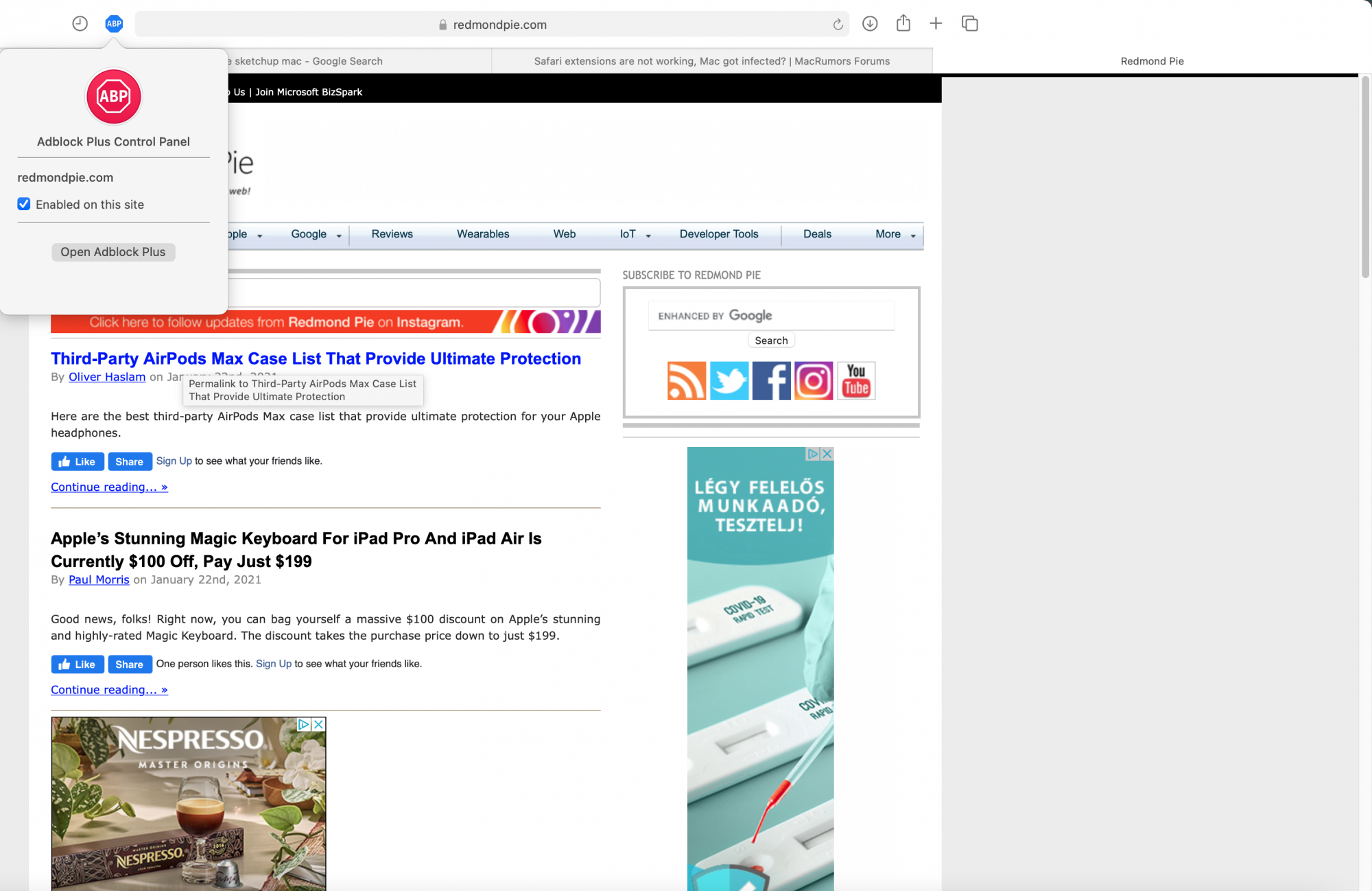

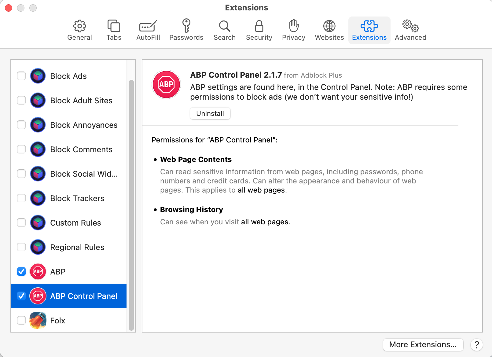

So the extension is installed, enabled and is running, but it has no effect/it does not work. The same extension with the same settings in the same safari browser works in an other account on my laptop.
