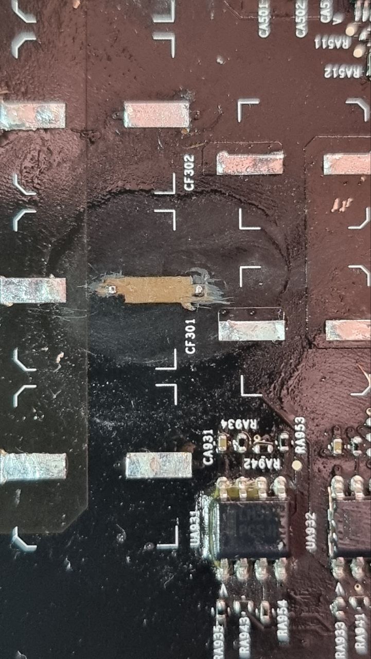

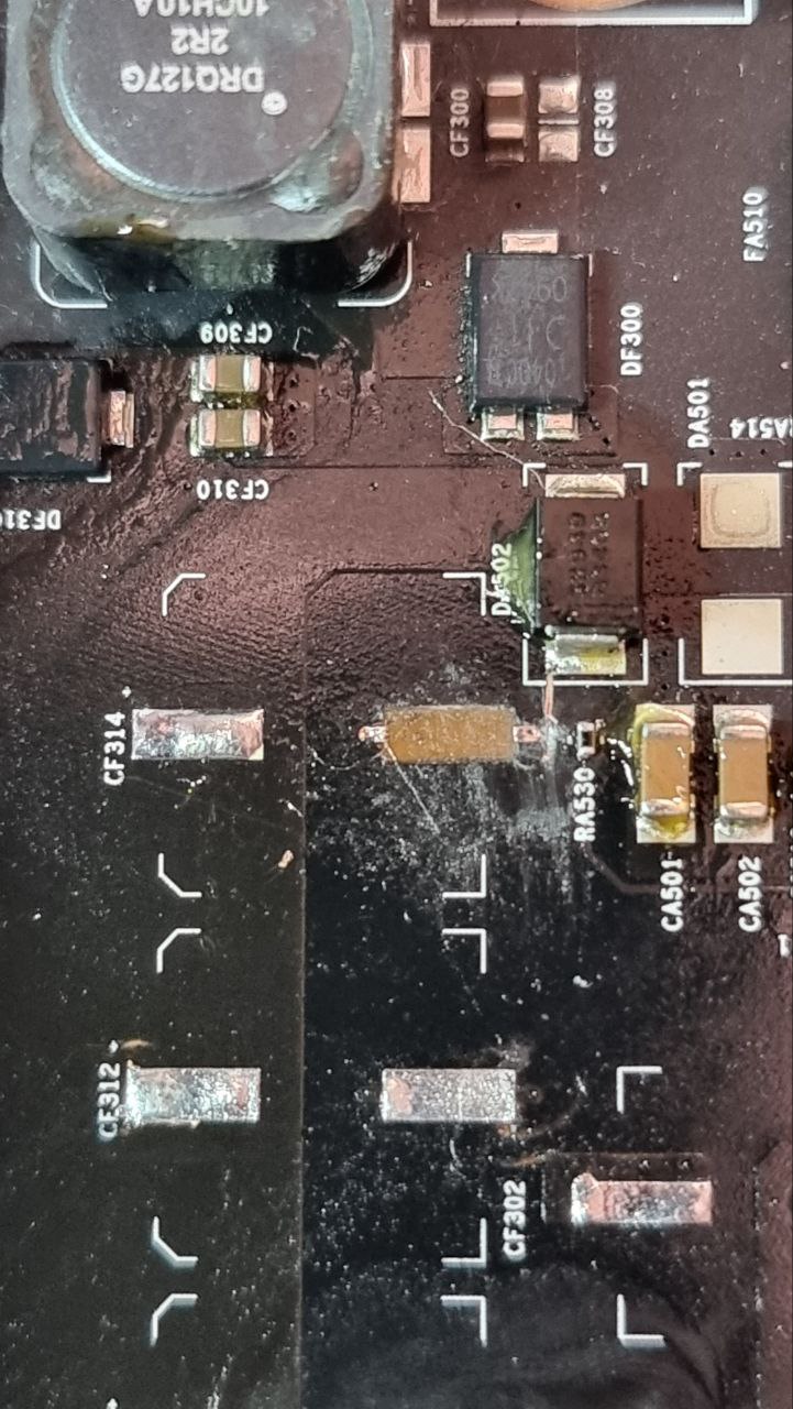

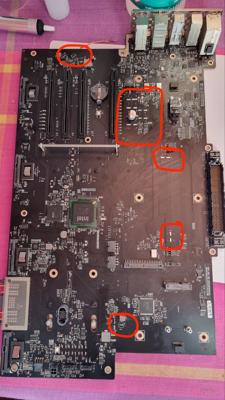

I tackled the task desoldering all the board capacitors, specifically:
I managed to desolder all of these 11 bad boys, 8 of which are SMD ones --> desoldering them is kind of a challenge and breaking the traces is very easy. And I mean very
very
easy. Luckily I just stripped off 2 out of 16 total traces, which is a good % given that I'm almost a newbie in microsoldering. With the help of some new copper traces, using those super tiny shiny copper points I was blessed to have, I rebuilt the traces as good as I could and changed all of the capacitors, even if I apparently didn't find any issue while testing those I removed.
My guess btw is that the issue is related to the biggest ones, as one of them literally blew up during my first test after reassembling the computer, probably due to the new traces not being reliable as I thought they would be.
Disassembled again, changed the exploded capacitor with more attention to the damaged trace, reassembled the Mac and it turned itself on as I inserted the power plug (no GPU was installed during these first tests).
