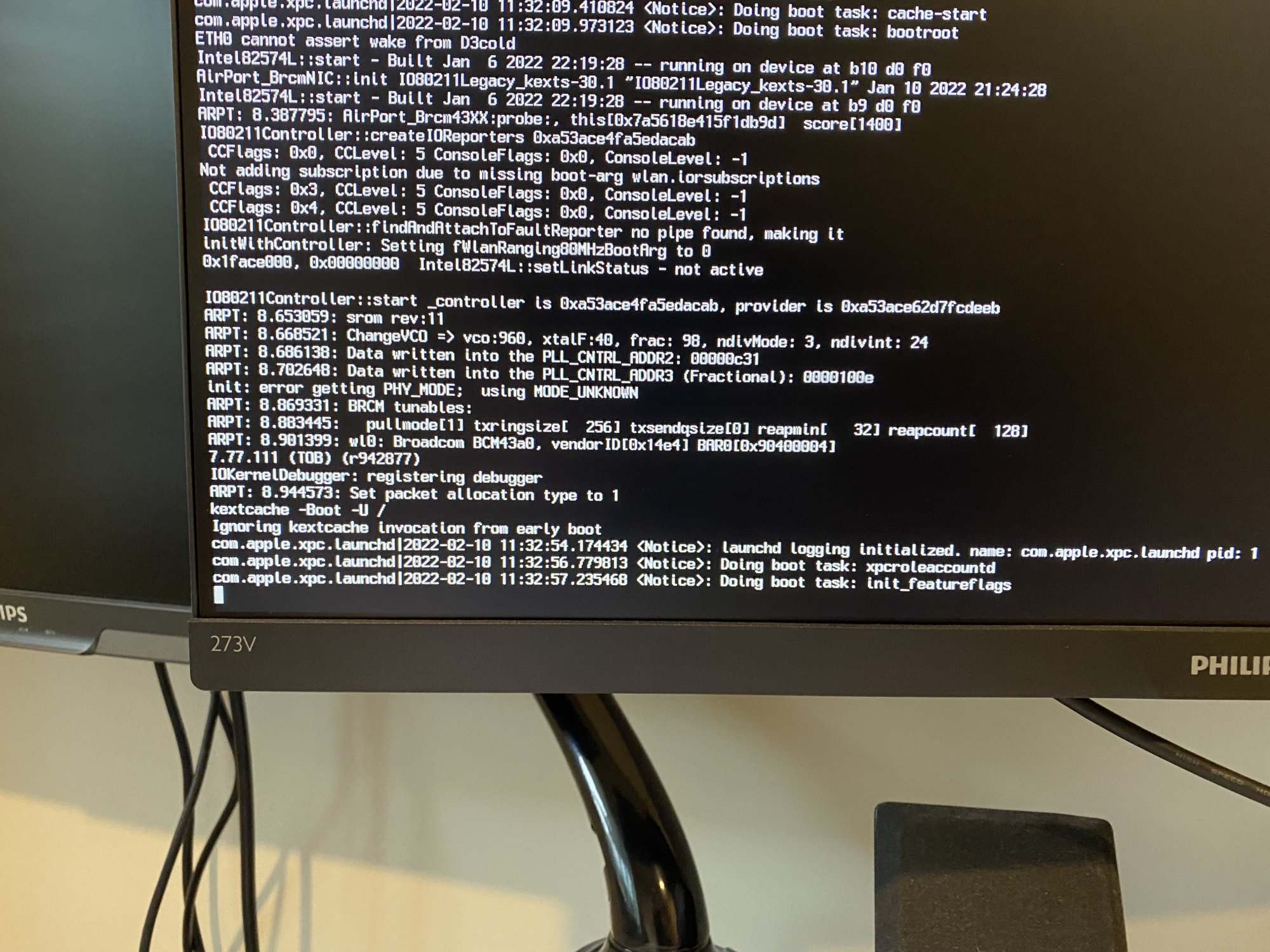

BTW I have very slow boots as well, gets stuck here.

I solved issue with setting SetApfsTrimTimeout to 0 in opencore config.plist.
New boot time is 20 seconds.
Setting SetApfsTrimTimeout to 0 actually prevents macOS from running TRIM. This is why boot times are shorter under that setting.
OK, that's not very good. Would it be possible to lower the SetApfsTrimTimeout value from the value set as default and get both faster boot time and TRIM enabled? :) 🤔
My understanding is that you either disable it to get normal boot times or enable it and experience much slower times. The bug seems to be in the TRIM implementation by Samsung, so whenever it's on Monterey will take a long time to boot.
Why does that happen only on Monterey? That I don't know.
