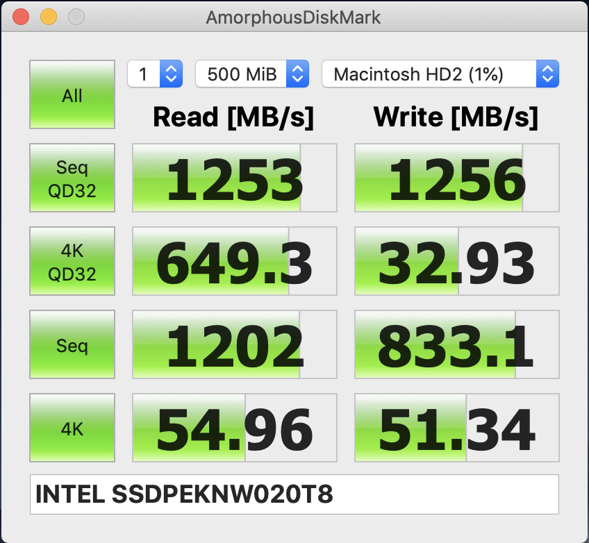

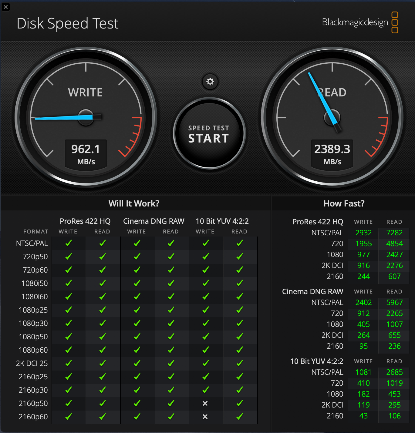

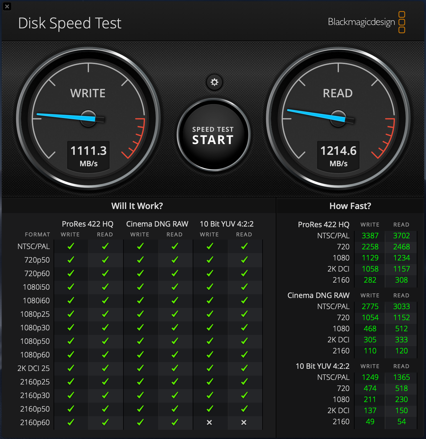

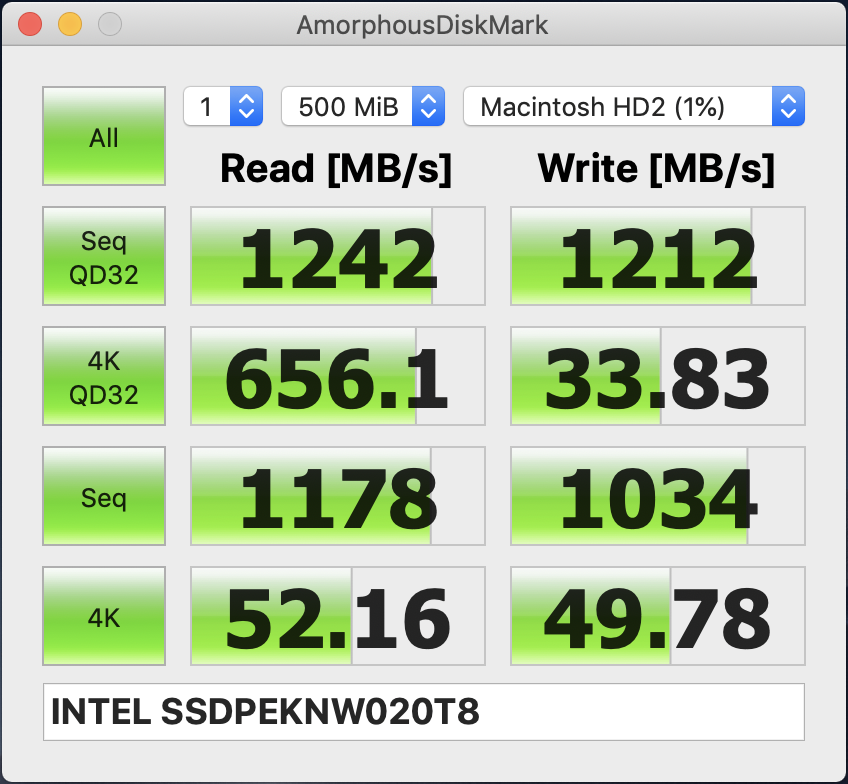

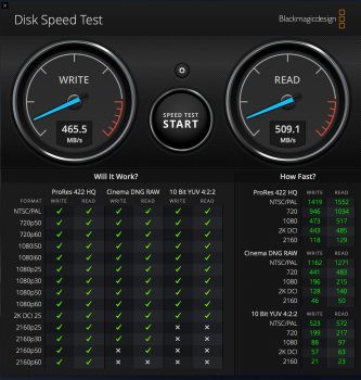

TEKQ Thunderbolt 3 enclosure with 2TB Intel 660p NVMe drive Benchmarks in left-sided Thunderbolt 3 ports on MacBook Pro.

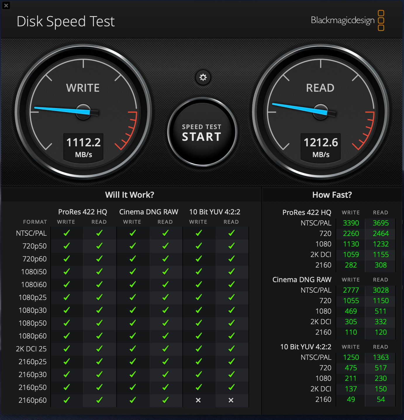

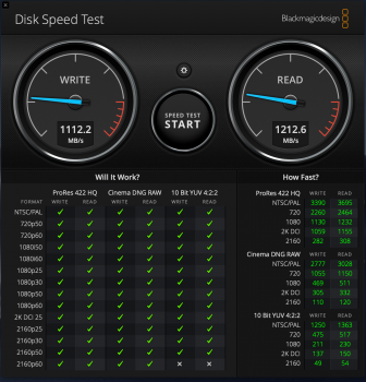

Samsung X5 thunderbolt 3 enclosure with 2TB Intel 660p NVMe drive Benchmarks in left-sided Thunderbolt 3 ports on MacBook Pro.

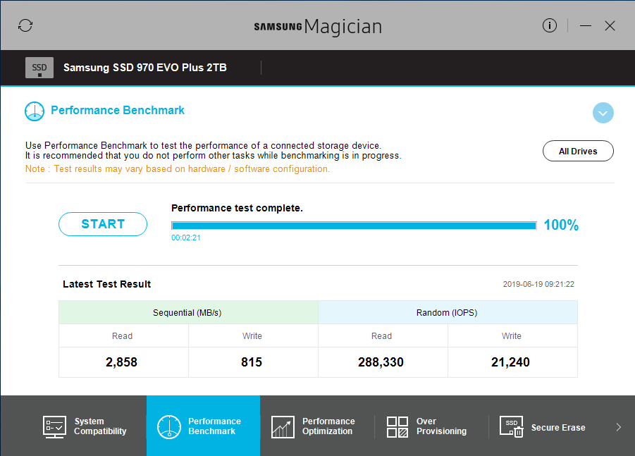

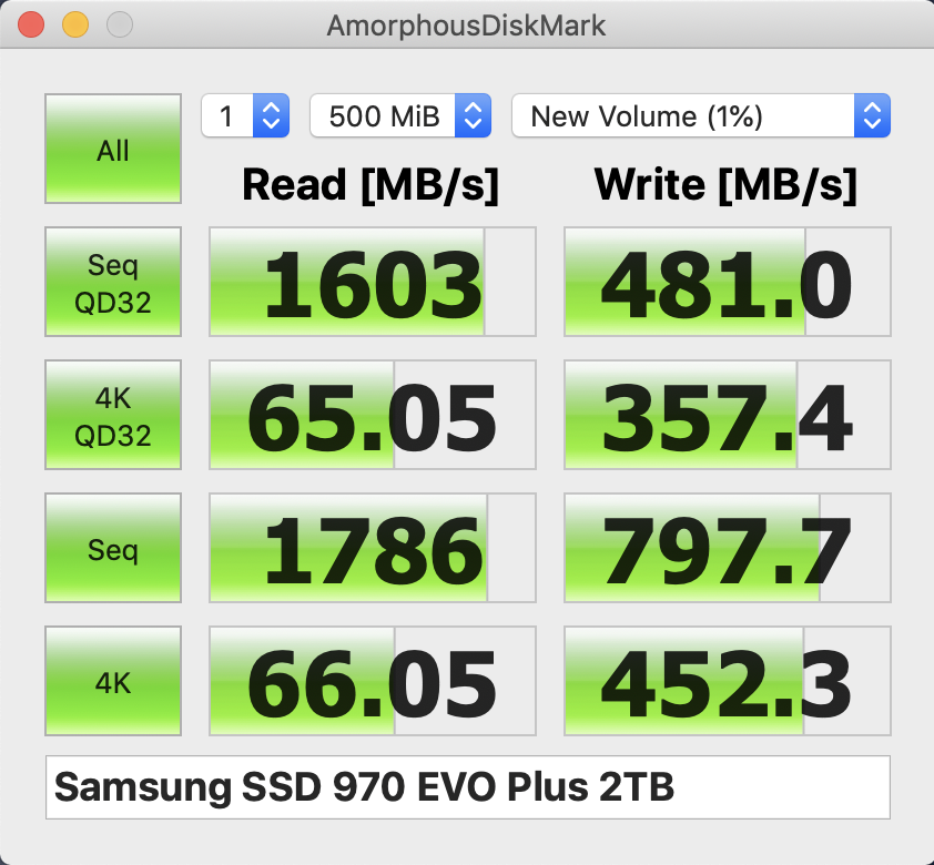

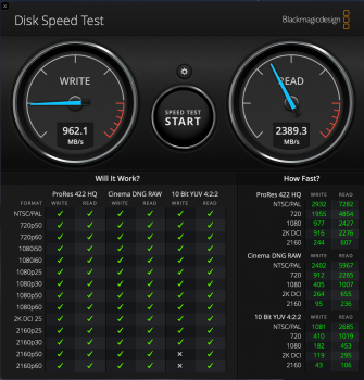

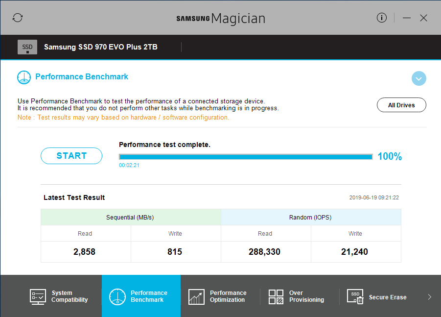

Samsung X5 Thunderbolt 3 enclosure with 2TB Samsung 2TB 970 EVO Plus NVMe drive (with new firmware 2B2QEXM7 released May 20, 2019) Benchmarks in left-sided Thunderbolt 3 ports on MacBook Pro. The Samsung X5 is my fastest Thunderbolt 3 enclosure. I am using the included Thunderbolt 3 cable which came with the Samsung X5 drive.
Although this drive is now stable with macOS, I am getting mediocre write speeds of 977 MB/Sec with multiple Mac and Windows benchmarks, compared to the Samsung EVO 970's write speeds of 1881 MB/Sec. The results are similar with macOS and Windows filesystems.
https://forums.macrumors.com/thread...rade-pitfalls-and-tips.2177812/#post-27283795
https://forums.macrumors.com/threads/samsung-x5.2181056/#post-27386594 - for comparison purposes.

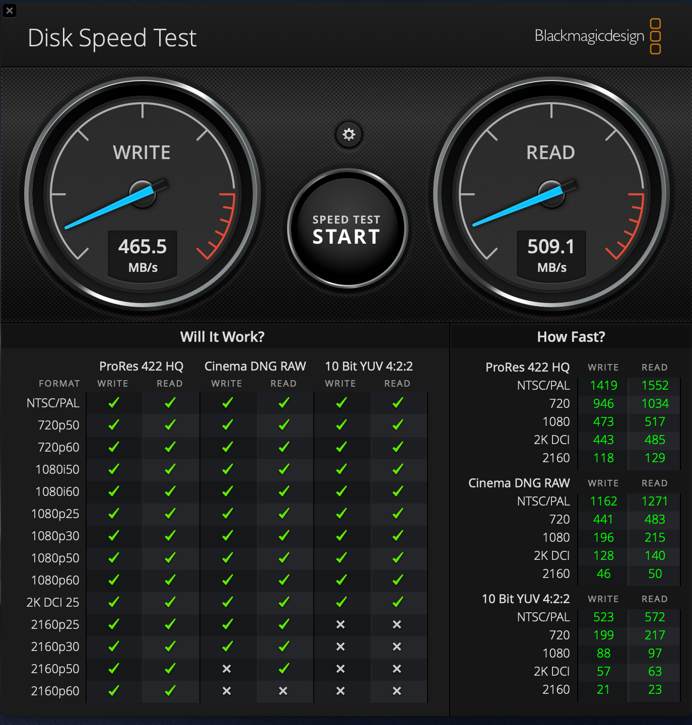

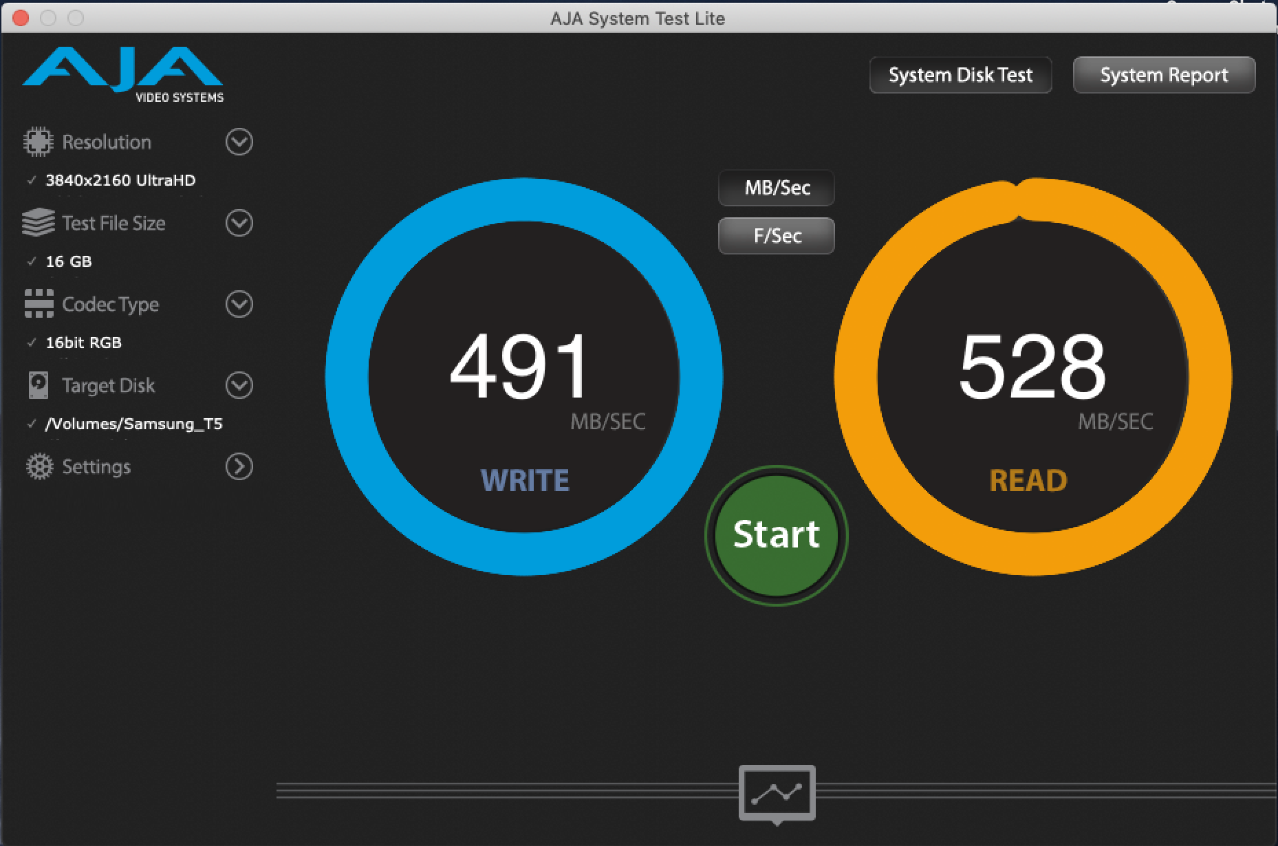

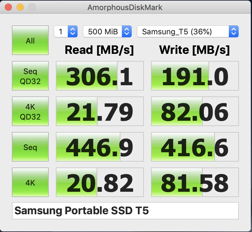

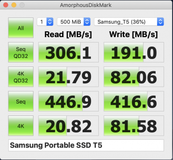

Samsung T5 1TB drive benchmarks in left-sided Thunderbolt 3 ports on MacBook Pro.
