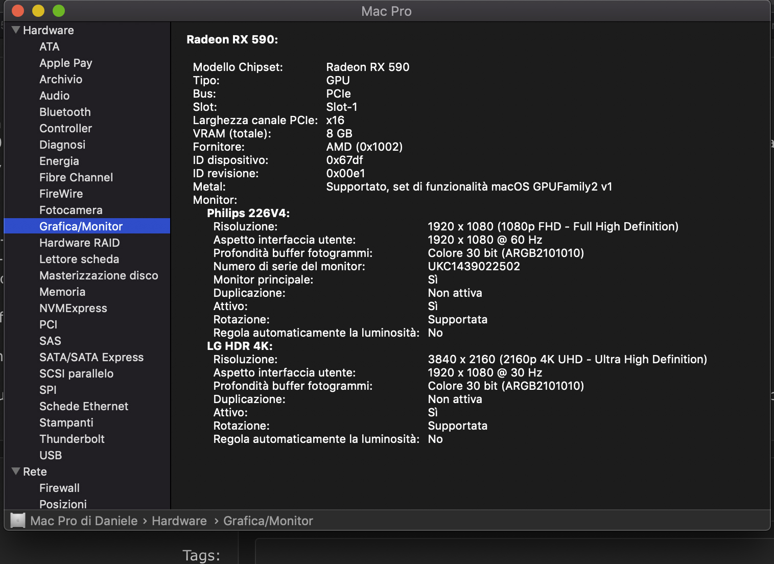

I've a mid 2010 running Mojave 10.14.6 with a single w3530 still (x5690 is coming), 32gb 1333mhz ram, 1tb hdd and a pulse rx 590. I've also a 4k monitor, lg27uk850, which I would use as my main (and only) monitor.
So, shortly:
hdmi output ---> hdmi input lg = 4k@30hz
dp output. ---> dp input= NO SIGNAL
hdmi output on LG + dp output on another fhd monitor= 4k@30hz on LG and 1080p@60hz on secondary monitor

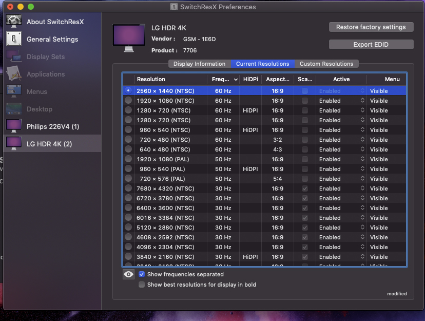

I've tried to use SwitchResX, searching for a 60hz useful resolution... NO WAY. the only useful res is 1920x1080@60hz but it makes desktop blurry.

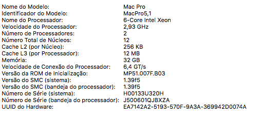

Hello. Need some help. I have a mac pro 2009 flashed to 5.1 and i bought a sapphire pulse radeon RX590 to use in it. My boot ROM version is MP51.007F.B03. I tried to use the card in Sierra, it didnt recognized. Then i upgraded to Mojave, and it didn´t work too. I put my original Nvidia GT120 card and checked the status. The system did not recognize my 590 card. My question is: does it works in my machine? Is there anything i should/could do to use it, or is it better to change to a RX580? Can i update my boot ROM version, and should i do it?
Thanks a lot.

The Pulse RX590 works beautifully in my cMP so should work in yours.
Upgrade to the latest Boot Rom 144.0.0.0.0 first anyway as a starter. Before you upgrade, use RomTool to back up your Rom.
