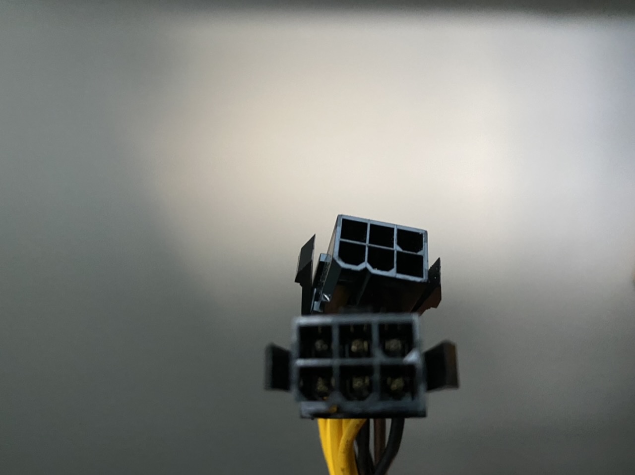

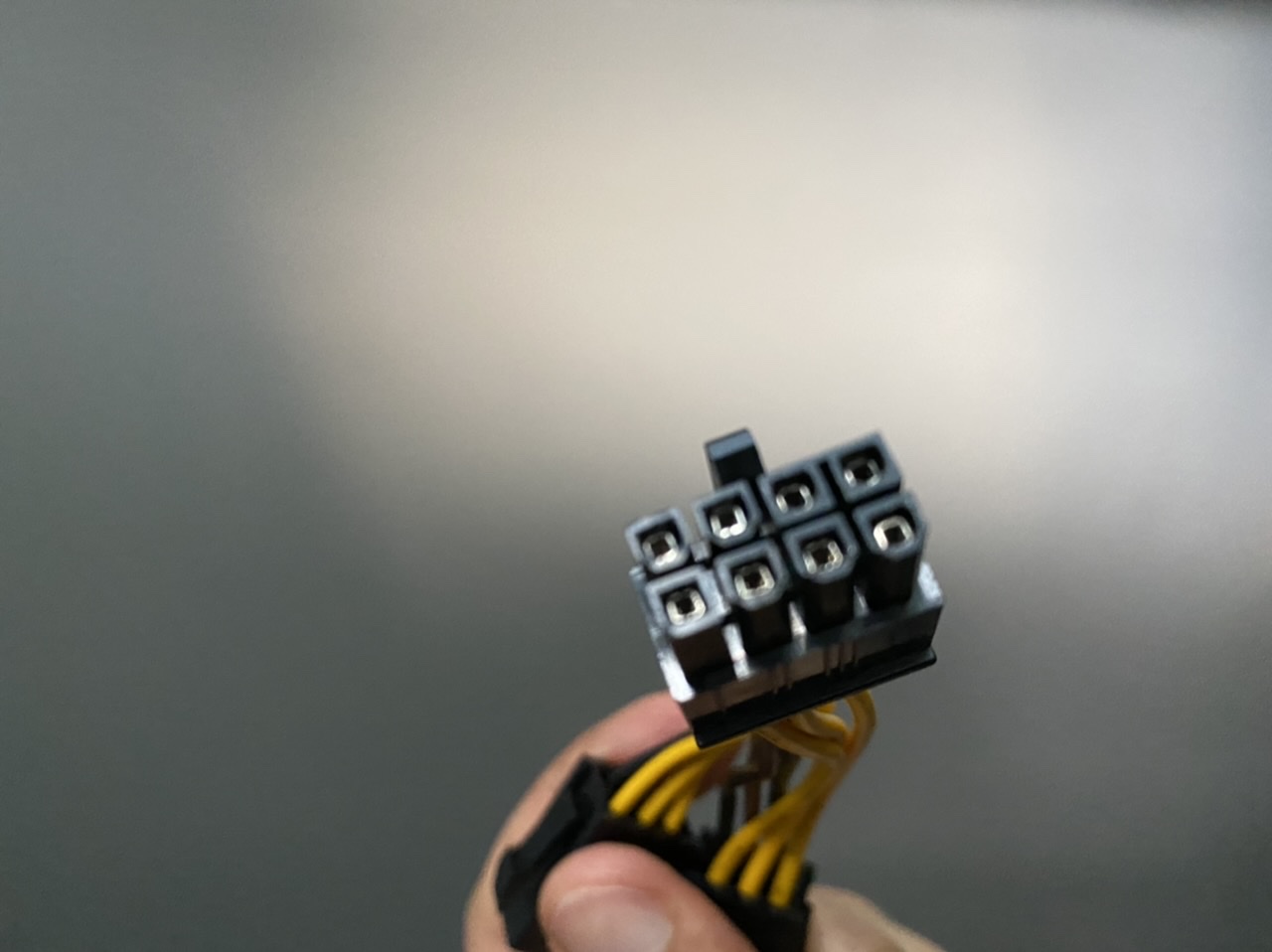

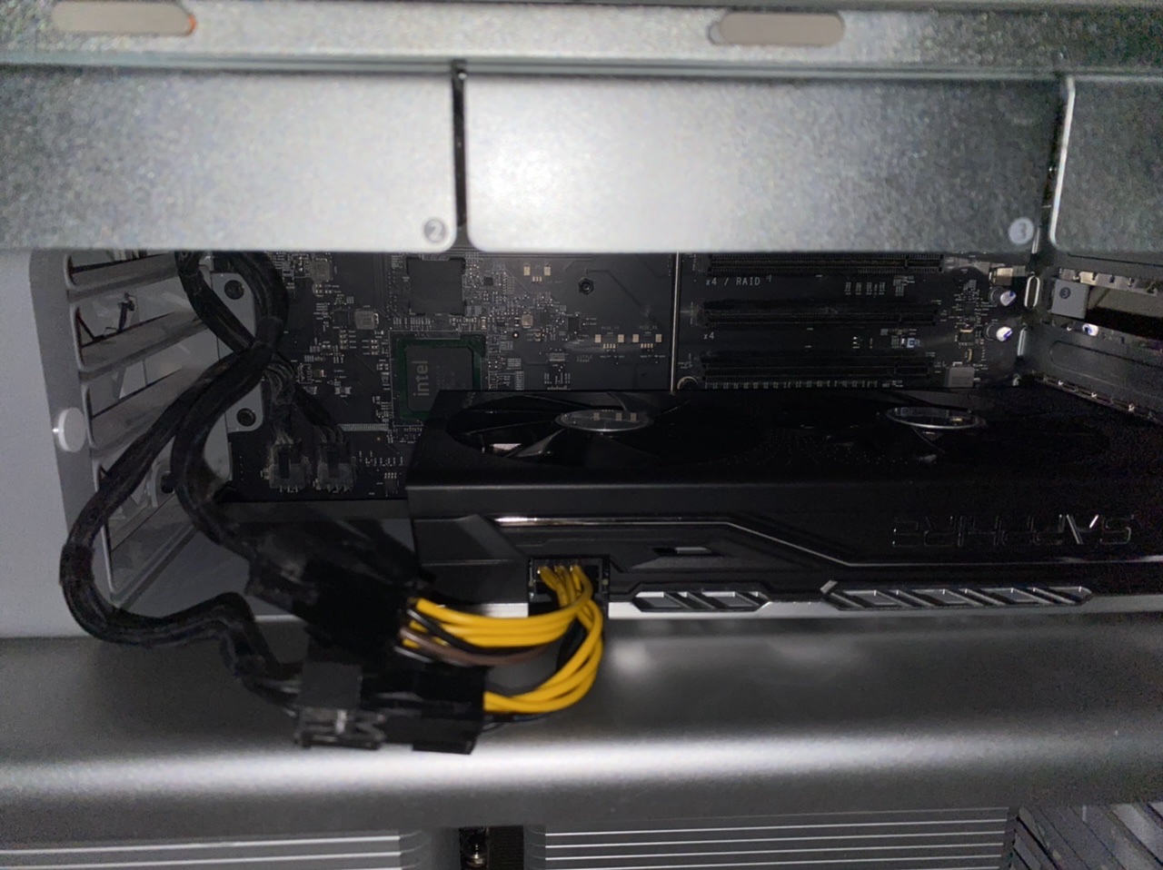

I have a Mac Pro 5.1 2010 currently running macOS El Capitan 10.11.6 and I wanted to update the GPU and after I checked Apple’s recommendations for GPU upgrades I just bought a Sapphire Radeon RX 580. So I removed the two old GPUs (ATI and Nvidia) and plugged in the two 6pin into an 8pin adaptor as shown below and put the new Sapphire as shown in the below photos. But seems that it’s not working as I tried multiple screens but they are not detecting any signal. Is it a macOS EL Capitan problem and do I need to update to Sierra or High Sierra first Before being able to use it?

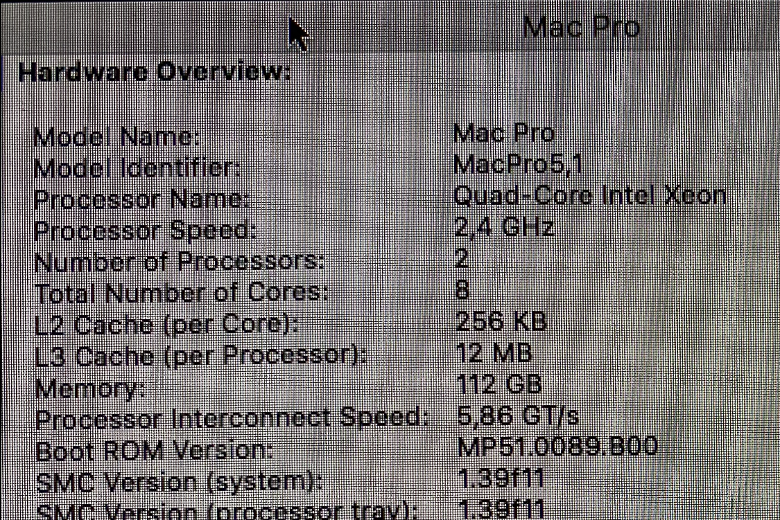

2. What is your Bootrom version ?

2- Here is my bootrom version:
1. Have you checked that your GPU power cables are 100% plugged in ? Happened to me once.

It looks like 2x Pixlas in the picture, I thought that too.
But I think the cables are connected to the mini 6pin.

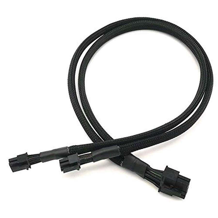

You definitely DON'T need the Pixlas mod to power the Sapphire RX 580.

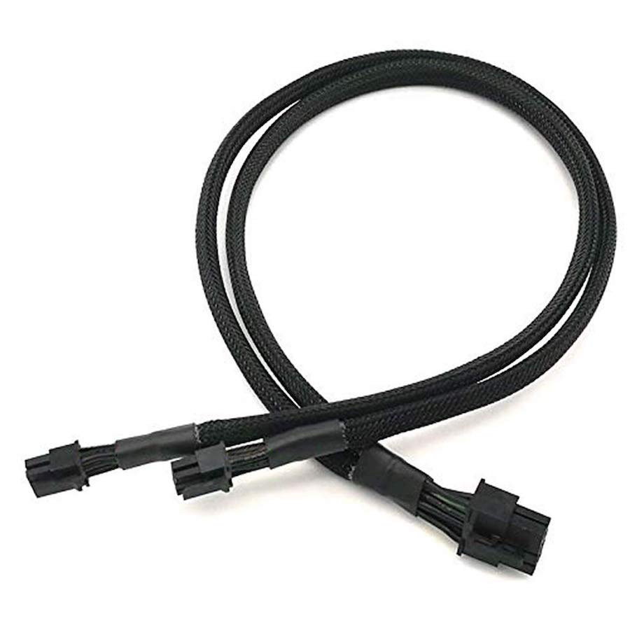

You could try just powering it with the TWO x Mini 6pin to ONE by 8 pin.
My MSI Armor RX 580 8gb works fine with this cable.
Amazon https://www.amazon.com/Express-Video-Power-Adapter-Compatible/dp/B082ZD28VR

2- You mean that I am using the wrong cable? If so, I have searched from where here in Sweden I can get two mini-6pin to 1 8pin but I cannot find it, could you advise me if it has another name I can look for or search with it? Thank you
1-as has been said: you need to install Sierra or High Sierra first ( with one "old" GPU installed). This card will not work in El Capitan.
2-the link @MIKX sent doesn't work (here), but it's the correct cable .
For Europe look here:
Amazon
I live in Japan so Firefox . . or. . Amazon often changes my search results to a Japanese site or some other.
Just Google this ..
" amazon.com Dual Mini 6 pin to 8 pin Mac Pro "
Will those work also?
iHaospace Dual Mini 6 Pin to 8 Pin PCI-e Y Splitter Power Adapter Cable for Mac Pro Video Card Power Cable 30 cm
Ils 16AWG Dual Mini 6 Pin to 8 Pin PCI-e FOR MAC PRO GTX1080 Video Card Power Cable
To the OP - If all connections with your cables are good, your cabling looks OK. But, as others have said, you need to run a later OS to get the drivers for the card. It also would be a good idea to update your boot ROM to 140.0.0.0.0. there are instructions on this site for the install.

Updating to 10.14 is recommended, though you may have your reasons for not doing so. In any event, upgrading to 10.14.6 will also update your BootROM to 144. There are several benefits to this, including enabling full speed on slot 1, which presumably is where your GPU will live. You can update the BootRom without updating the OS.
