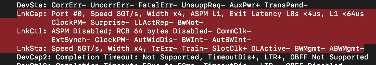

I have the Apple SSUBX which I believe is an SM951 with Apples custom connector. APFS works just fine here.
Good catch. Looking at the hardware details, the SSUBX is a PCIe 3.0 device, like the sm951. Both should be capable of 2000 MB/s reads in a PCIe 3.0 slot.
