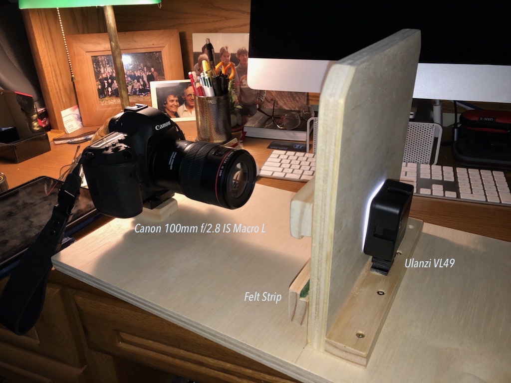

Self portrait on Extachrome, 1960's. iPhone 12Pro on cheap stand in post #22.
