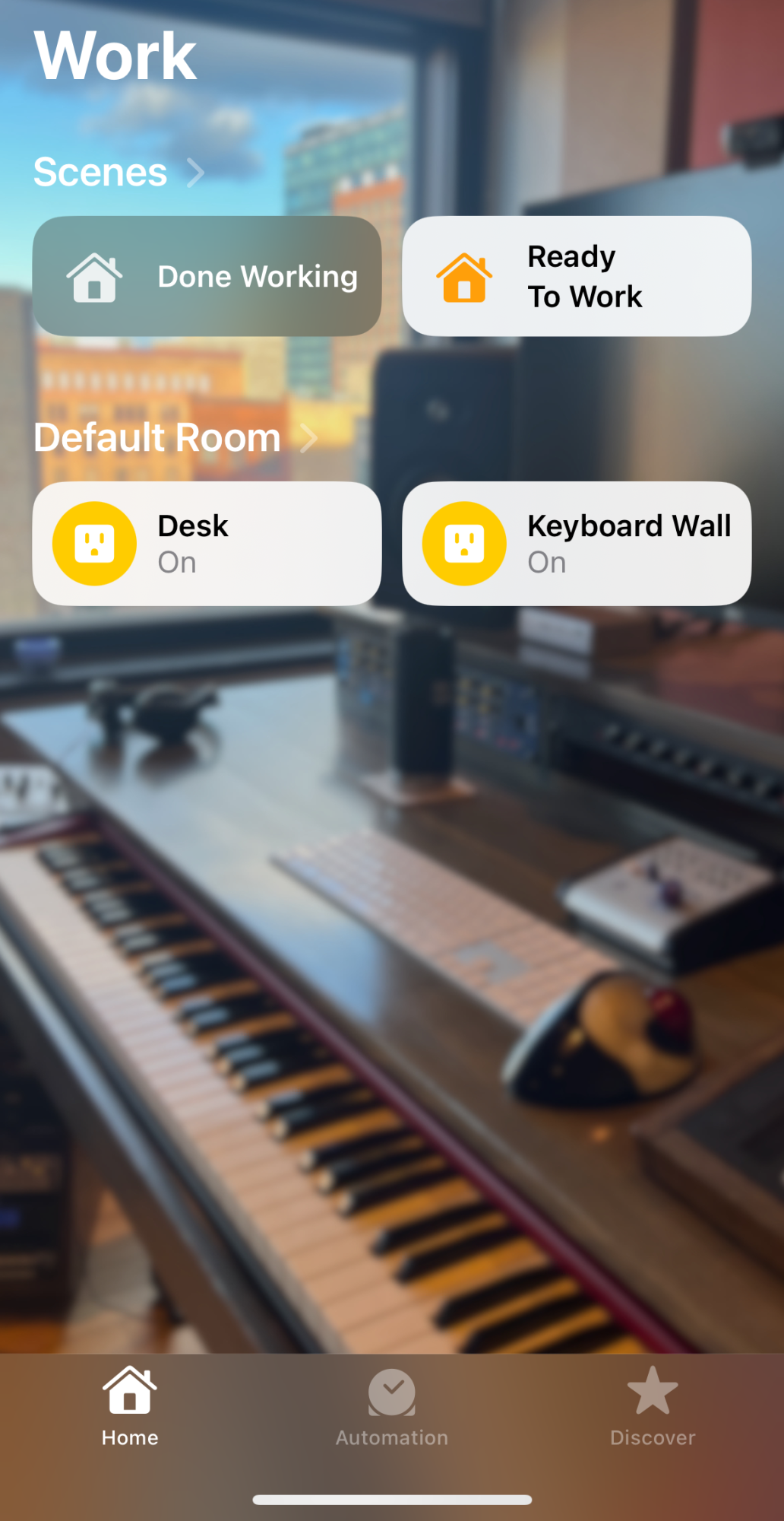

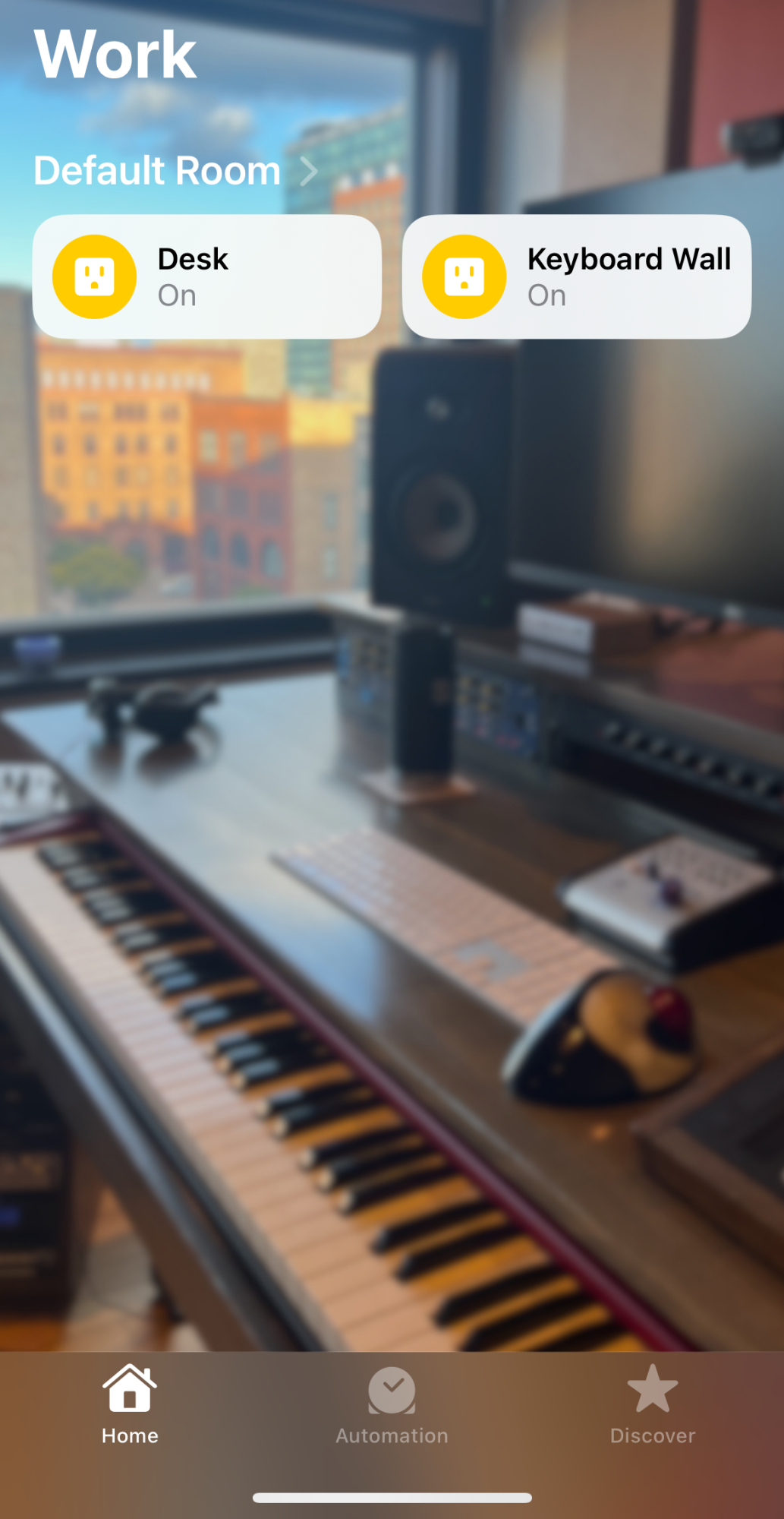

I have a couple Kasa outlets at my work that I turn on and off simultaneously using scenes. However, every few weeks, those scenes disappear, as if they never existed in the first place. This has probably happened a half dozen times. It seems to be totally random, and not related to any way I'm triggering or interacting with them. The only devices that interact with these scenes are my iPhone 13 Pro, Apple Watch, and M3 MBP, all on the latest OS versions.
Anyone know of a way to get things to the point where this no longer happens?

The way I read the screenshots, "Work" is already a separate home since that's the name at the top, with Default Room listed below. I agree I think it needs its own hub.
