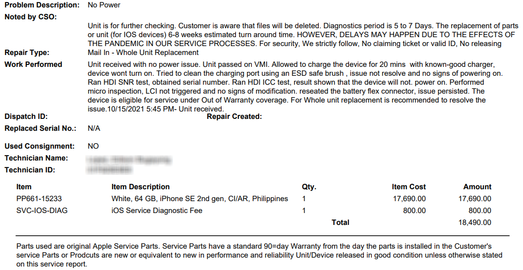

Update:
So, it costs me around $364.63 (converted from php).
Damn...

Update:
Paid the Apple Service Center here in my country around $16 to retrieve my phone.
IP Adhesive was completely removed (according to the guy in the story below).
I googled "iphone logic board repair" and saw some Reddit posts that recommends local reputable repair shops.
I messaged around 3 shops and went to a mall for my appointment.
Findings: shorted logic board (because of wireless charging?! [not Apple-certified wireless powerbank] oh damn, I'll never wireless charge anymore!)
Cost: Just a mere $63 with IP adhesive!
