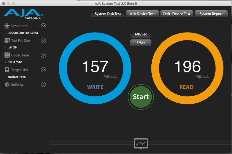

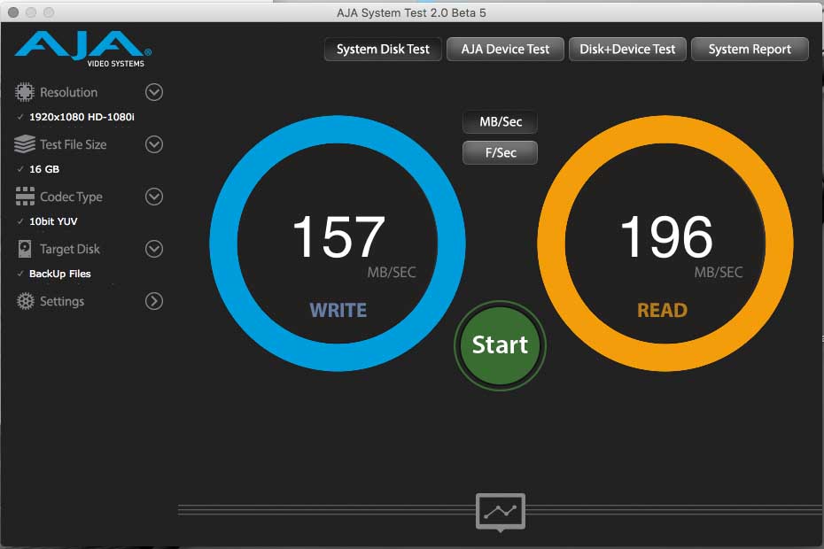

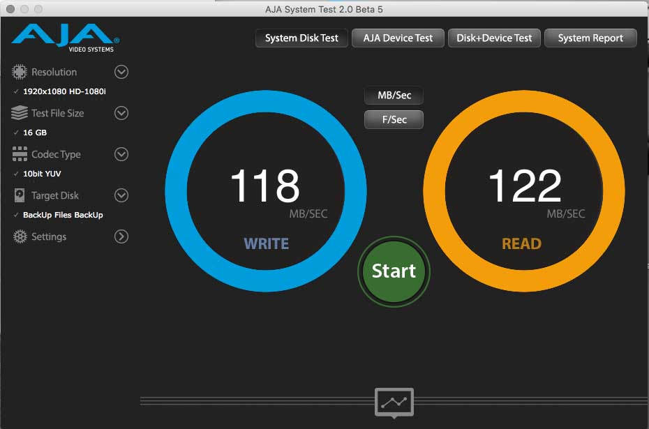

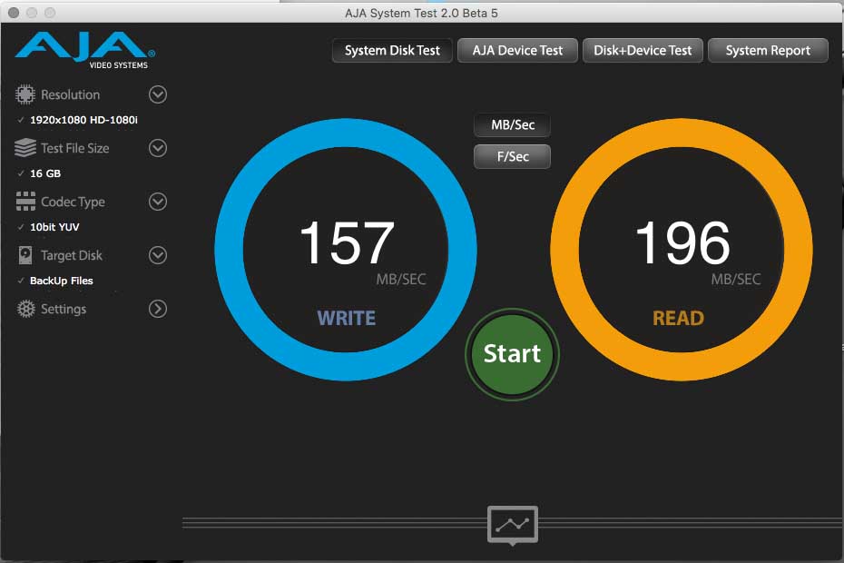

I have no experience with Enterprise drives, but I do have 2 spinners amongst my 7 drives (5 are SSDs). My spinners are a WD Black and a Seagate SSHD. The SSHD is faster than the HDD.
WD Black HDD
Seagate SSHD
