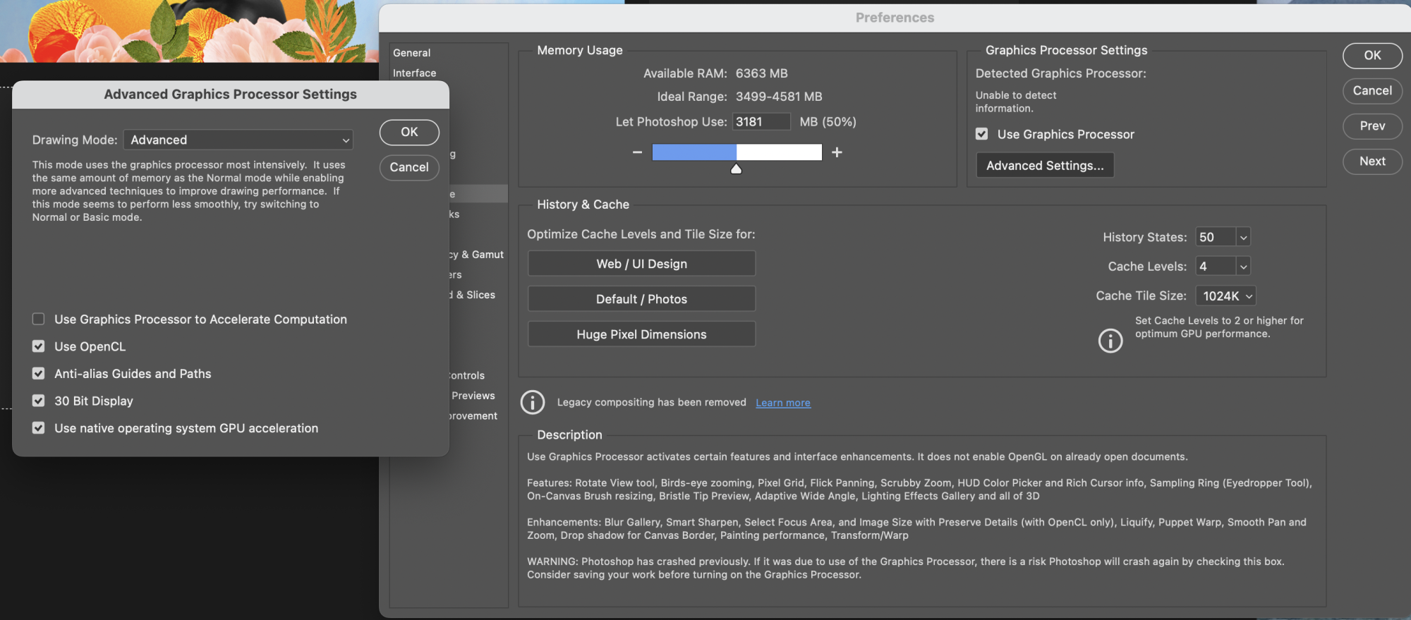

You could disable Hardware/GPU-acceleration in Photoshop to see if that makes a difference (no fun using it without on a daily basis).
Photoshop > Settings > Performance > use GPU [deselect] (or whatever it's in English)

I'll then try Photoshop again by disabling the Hardware/GPU-acceleration and see how that works out.

I then tried the disabling the Hardware/GPU-acceleration.
And it crashed as soon as I opened Photoshop.
Crash code:

I have attached an image of the Photoshop settings before I disabled it, just incase that highlights something.
I am starting to think that it might be a lost cause but I'll ask some mates if I can borrow one of their monitors so I don't have to fork out any money to see if it works or not. I can report back the results.
Based on what I've seen it seems to be an unresolved software issue with Photoshop.
Have you tried opening Photoshop without the second monitor attached and then connecting the monitor after PS is open?

Update and unfortunately no good news.
I have used my mates second monitor, a Phillips 272P7VPTKEB which I was hopeful of when it said in the specifications that it was plug and play with Mac OSX.
I used HDMi to USB-C cable from curry's - brand Sandstrom
I used Photoshop on off last week with no problems. I thought the problem was solved and then it crashed last night.
I'll attach the crash code at the bottom.
So I can only think it is an Apple IOS issue that might get solved if they were aware of the problem.
As it stands, I'll just be disconnecting the second monitor to use Photoshop. But it is just a shame we couldn't get to the route problem.
Thanks for your help
Mark
