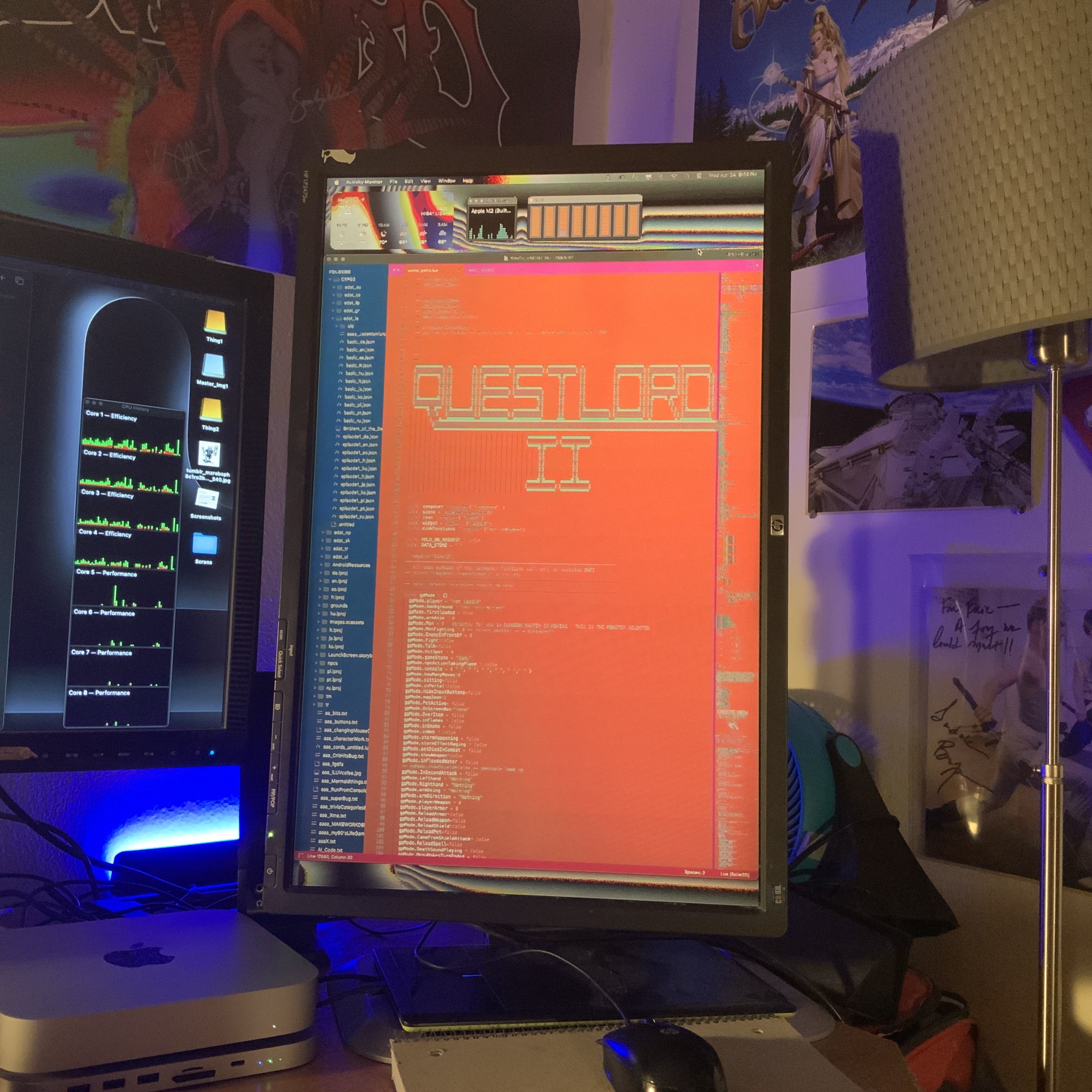

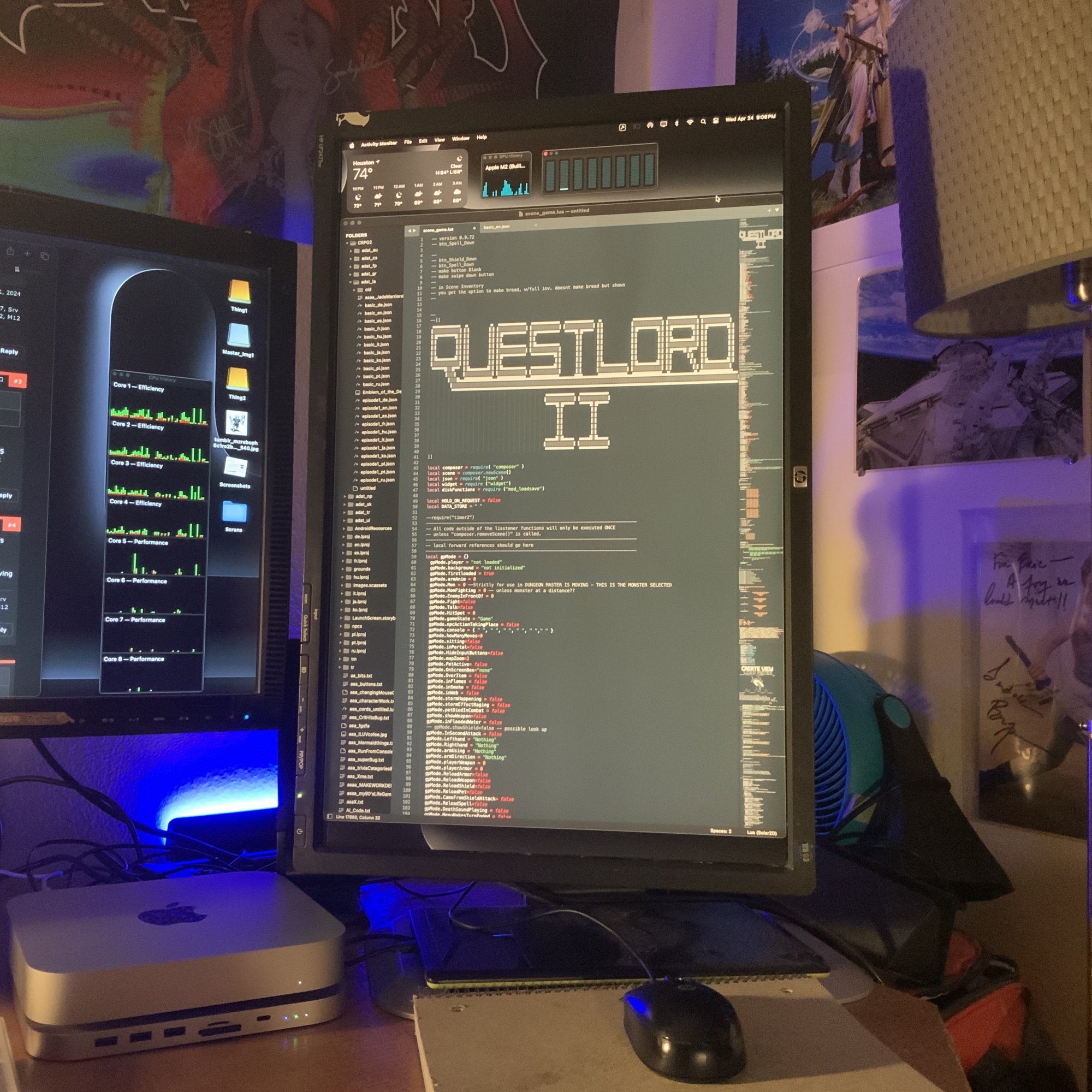

My Secondary HP LP2475w Monitor is rather old. 2009ish? But for 2009 it was top of the line monitor, with all types of connectors. 2 DVI, 1 HDMI, 1 DisplayPort, 1 S-Video, 1 Composite video, 1 Component (Y Pb Pr) oh and 1 Spdif (explained in manual as extra audio cable for HDMI) & 1 USB-A and 6(!) USB-B ports I've never used. Coming in just over 20 lbs. LOL. Only 1920x1200 & rotated vertically on its awesome stand, for code. It's a Beast. I love it. 🥰
Currently I have a DVI - HDMI cable plugged into a Qicai-H Adapter's HDMI going into the Mac mini via USB-C. (and into the monitor with the female DVI) Works great! Until I put it to sleep. Then, when it comes out of sleep the screen is super scrambled. Unworkable (Almost like it forces it into a 16 color palette.) 🤔
If I reseat the Qicai-H's USB-c adapter into the Mac Mini M2, it's all good!

If anyone wants to look at this 2009 state of the art bad boy, fun workstation pics attached.

It looks like it could be an hdmi handshake issue. Apple’s implementation of hdmi can be quirky. I have an adapter from work that has similar issues using hdmi with most of our projectors and won’t resolve itself. When determining the best way to connect my LG 32 UL500 to my M1 mini, I had some wierd quirks with hdmi as well. I now use DisplayPort plugged into a thunderbolt hub.
First I would skip the adapter and use the mini’s hdmi port to see if there is any improvement.
Next try skipping the conversion to dvi and use an hdmi to hdmi cable.
If that doesn’t do it, usb c to DisplayPort seems to very reliable on the M series Macs. You can either use a single cable or a hub for the connection.

Post is tl;dr but... if you're getting a "Static" display on waking from sleep on a HDMI display, Apple menu > Sleep on the working display & wake it up again should cure it.
My best guess is it's a cable issue but it's all routed & just as easy for me to sleep/wake again as to try to actually fix it.

Using a combination of meson's HDMI ideas and the guy eating his keyboard ideas to fix it!
I used my primary ASUS monitor (HDMI) into the Qicai-H Adapter's HDMI female and into the Mac mini-USB-c. That free'd up the Mac Mini's HDMI female take the Hdmi-to-DVI to the HP Monitor and Whaala! Success! Now I don't need to buy anything! I tested sleep, the HP wakes up just fine! No garbled 16 color pixels!
