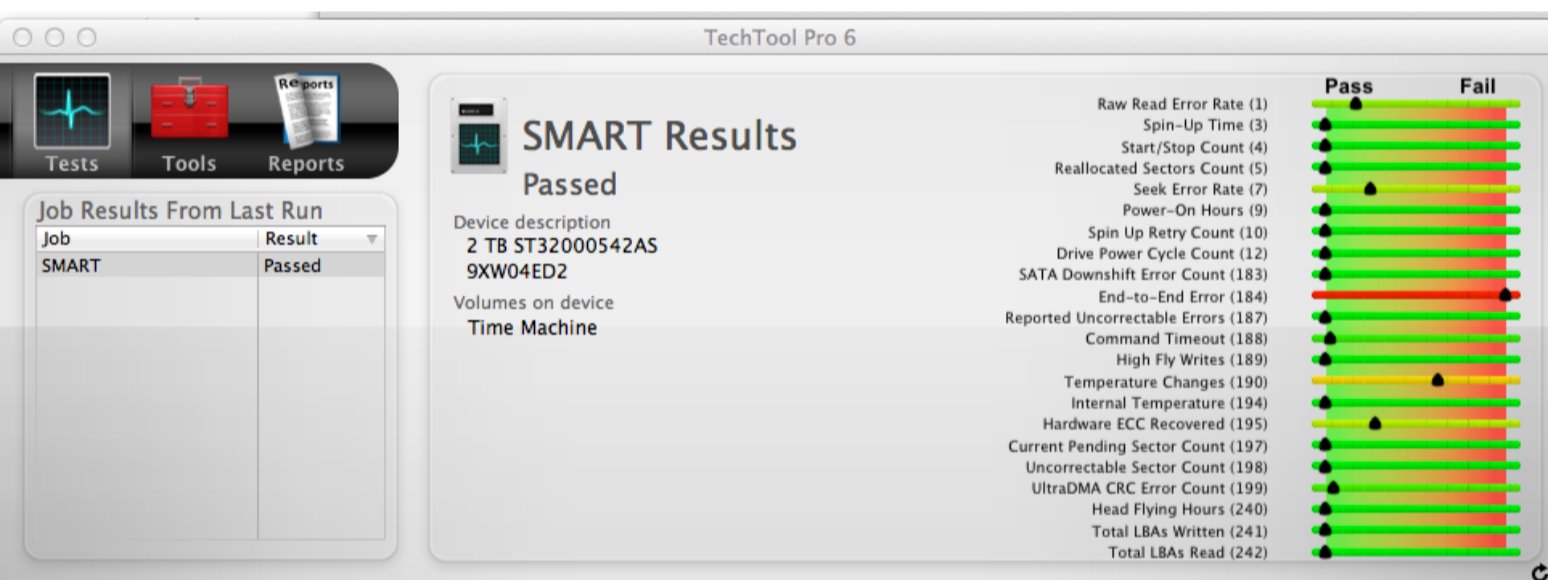

Having serviced hundreds—literally—2009–2012 iMacs, I can state with absolute certainty that the original HDD is in the final throes of its death spiral.
I still maintain most of these for schools but replaced the HHDs and batteries beginning 2015 or when 5 years old, whichever came later. By that time, I had made many service calls over failing/failed HDDs over the previous years. Replacing all the HDDs was done to save money.
Having replaced all those spinning heat pumps and batteries, can you guess how many have suffered GPU issues? Not one.
I tested every one that I pulled in TTP since most did not show symptoms. Most looked something like this after 5 years. BTW, you'll see that this passes a SMART test.
Since I had a 2010, I had gone through all of this: testing, format to 0s to write around bad sectors (that sometimes lasted a week), reinstall the OS dozens of times, had Apple replace the OE 1TB drive under AppleCare. My 2010 has the eSATA mod from OWC so that, when I booted from an external, it was the same as working from the internal (not available on the 2009).
I still have the only drive I ever pulled that was in clean shape. It's a 500GB OE HDD from an early 2009 24" iMac. Only one.
