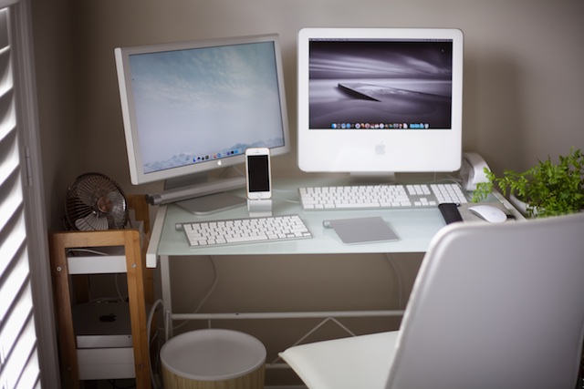

I've tried teleport, which used to work without any problems when I was using Intel Lion and PPC Leopard - not happening now. I've tried Synergy, swapping client and server - not happening. I tried connecting the two computers via ethernet - the systems still don't see each other. I got all excited when I saw that Symless had a "universal" application of Synergy they were maintaining - I paid my money over and (now having access to their help forum) discovered their Mac client was 'universal' to users of 10.9 and up. I got a little bit snarky when I wrote my refund demand. I did try mixing their application on Sierra with the PPC client on Leopard before exercising my snark, but still nothing happening.
I am officially out of ideas, except for rolling my MacMini back to Snow Leopard, getting teleport set up and rebuilding from there, but what a job! Please help?
[doublepost=1488336289][/doublepost]I should have added, I am open to the idea of a KVM physical switch, but I'd like a recommended one for PPC macs before shelling out. My desk is driving me nuts - I keep reaching for the wrong keyboard 🙁

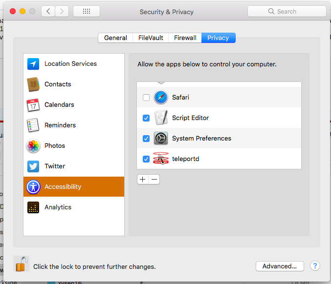

Ok. Found it on macintoshgarden.org. Not getting to to enable assistive devices on my old iMac running El Cap. Any suggestions?
1.0.2 on El Cap and 1.0.1 on Tiger should work together. Here is the Wayback Machine link: https://web.archive.org/web/2017062...m/software/teleport/downloads/teleport102.zip

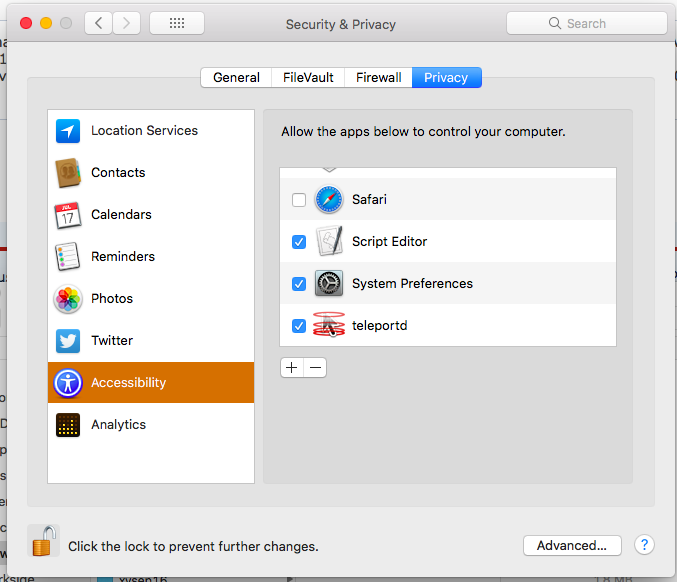

EDIT: Ohh, I see what you're saying. I just tried to reinstall it to see what problem you might be having. First, when the "Disabled access for assistive devices" popup shows up, force quit System Preferences and click Disable. Then, open System Preferences back up and don't enable Teleport yet, but go to the Security pref pane I show here, and enable it there, then go back to the Teleport pane and enable it. They must have changed some System Preference security thing at some point that "breaks" this, without the workaround I mentioned. 🙂
The option is here in System Preferences for enabling Accessibility devices.
Reactions: AphoticD

Hey Slix,
Thanks for the reply, but I neglected to mention that I upgraded to El Cap on the old imac. Uninstalled teleport and reinstalled just to see, but it still does not show up in the accessibility window as an option to "tick". I've tried adding it using the "+" symbol and navigating to the preferences pane folder, but it does not allow me to select it.
Any other ideas? It installs fine under sierra on my macbook pro. Do I need to upgrade the iMac to Sierra?

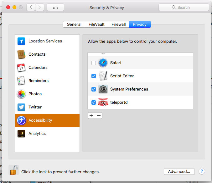

Ah figured it out. Had to enable accessibility for "system preferences" then teleport shows up after trying to enable it from the preference pane. Click "Disable" return to the accessibility setting and enable it there now that its shown up.
Thanks for you help tho' Slix! It got me thinking about similarly clicking the disable button.
Reactions: AphoticD and Slix

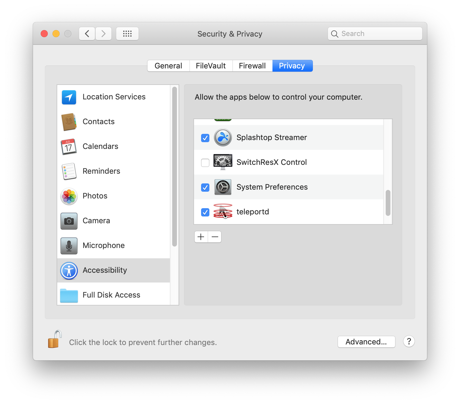

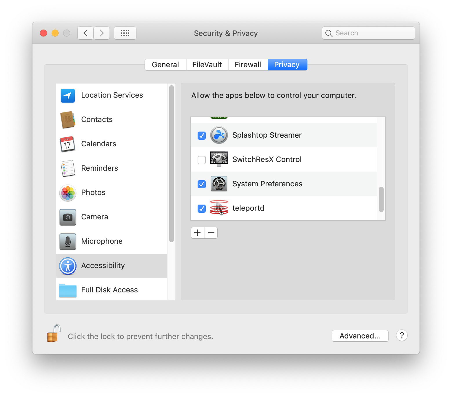

Has anyone gotten this to work in MacOS 10.14 (Mojave)?
I can't seem to get teleport to activate/stay activated. At no point in the process is there a "Disable" button as described above.

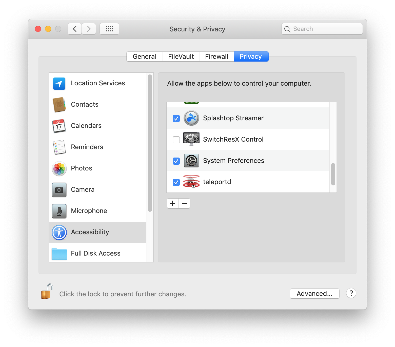

I did manage to add teleportd to the Accessibility security pane manually by opening the folder /Library/PreferencePanes/teleport.prefPane/Contents/Resources in Finder and then dragging teleportd to the preferences window.
The problem I'm having is, whenever I go to the teleport preference pane and check "Activate teleport", it doesn't see any shared devices and the "Activate teleport" option becomes unchecked if I leave the preference pane and reload it.
I do see the same behavior you're describing on Mojave. I hadn't noticed it until now, so I don't know when exactly it broke. Unfortunately it may be broken in Mojave and above now. 🙁
