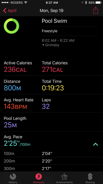

This is my first aw and the reason i bought aw2 because of its swimming proof. Today is the first time i swim wearing apple watch 2. I think its awesome and pretty accurate. It captured distances, laps and stroke accurately.
Please share your experience swimming with apple watch and what do you think about it!

Thanks for this info. I used it for a swim workout today as well. I only checked the Activity App, but not the Health App which you show above.
It's weird that in the Activity App it shows type of stroke (freestyle, butterfly etc.) and number of laps but doesn't show number of strokes. In the Health app it shows number of strokes but not number of laps. I suppose number of laps can easily be calculated by dividing distance by size of pool though.
Is there a way to see per-lap time?
How does it calculate no. of laps? I'm let say occasional swimmer, therefore I really wonder, how it can know, that I finish lap by basic swimming turn under water.

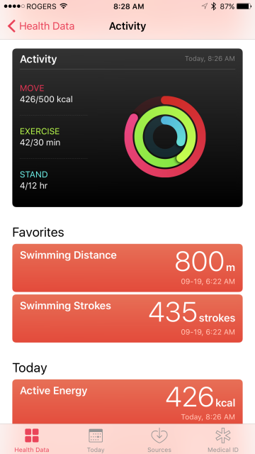

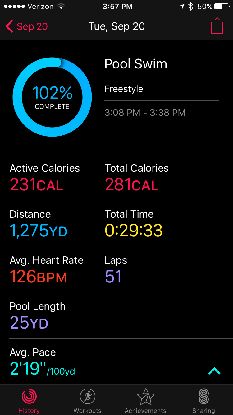

I did my first swim yesterday with the Series 2. Short 800m lane swim. Awesome how the health app shows number of strokes! Didn't know until I saw this thread. I had been swimming in the pool and open water with my original Apple Watch, so happy I can track these swims more accurately now.
I've used older multisport watches for swimming, they basically showed total distance and average pace by knowing the pool length and estimating motion when you've reached the end of the lane and turning. With the Apple Watch it was pretty cool though, I was in a 25m pool and it was slowly increasing the distance metric on the face during the laps.

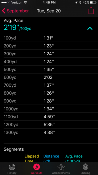

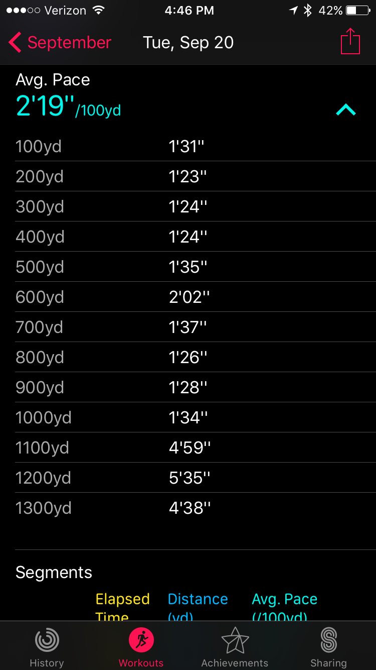

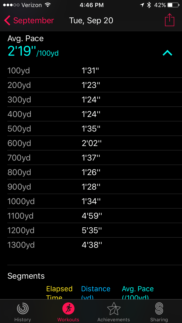

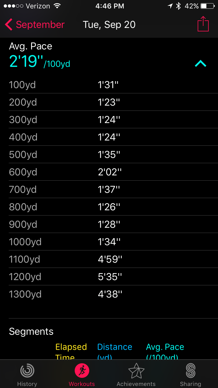

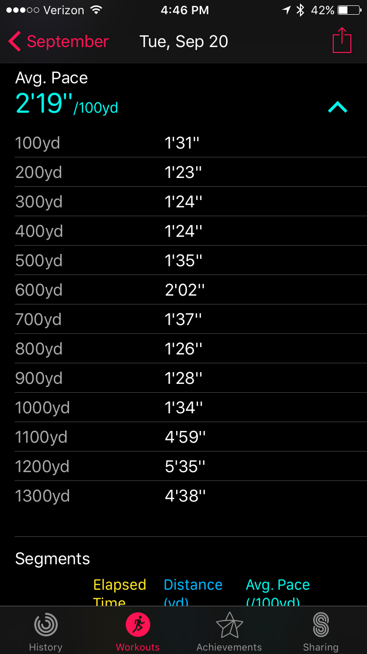

Not exactly, but you can see your pace/100, if you go to your pace on the activity->workout screen and expand it, it will show you your pace each 100yd/m. [see attached]

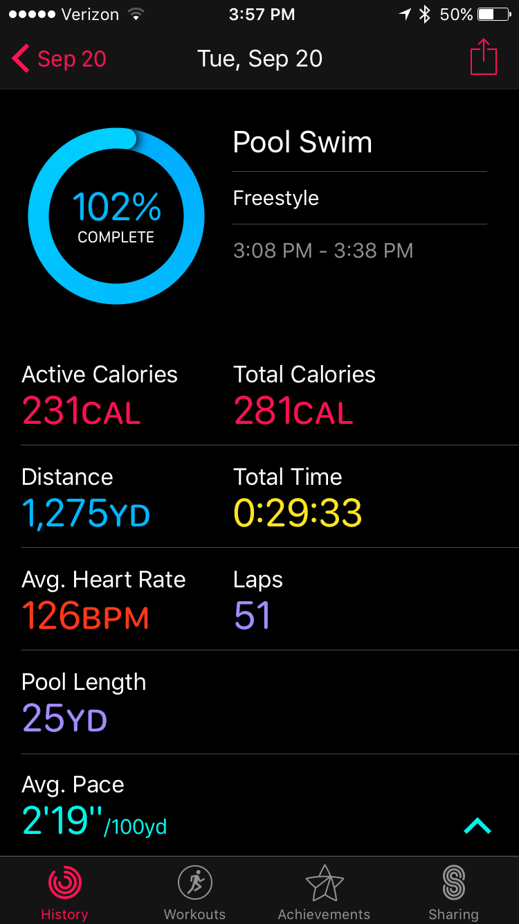

DFFA8853-BD85-4795-A201-A2B5C340FE10.png 5541AA6A-2EBC-4E0C-92F2-64DBAA1A17DF.png
Hi,
original Apple watch shows active calories, total calories and ave heart rate in Workout/Others when swimming, if you use the same option in Series 2, does it have the similar number? this will be a nice test that can help many decide if they have to upgrade to Series 2,

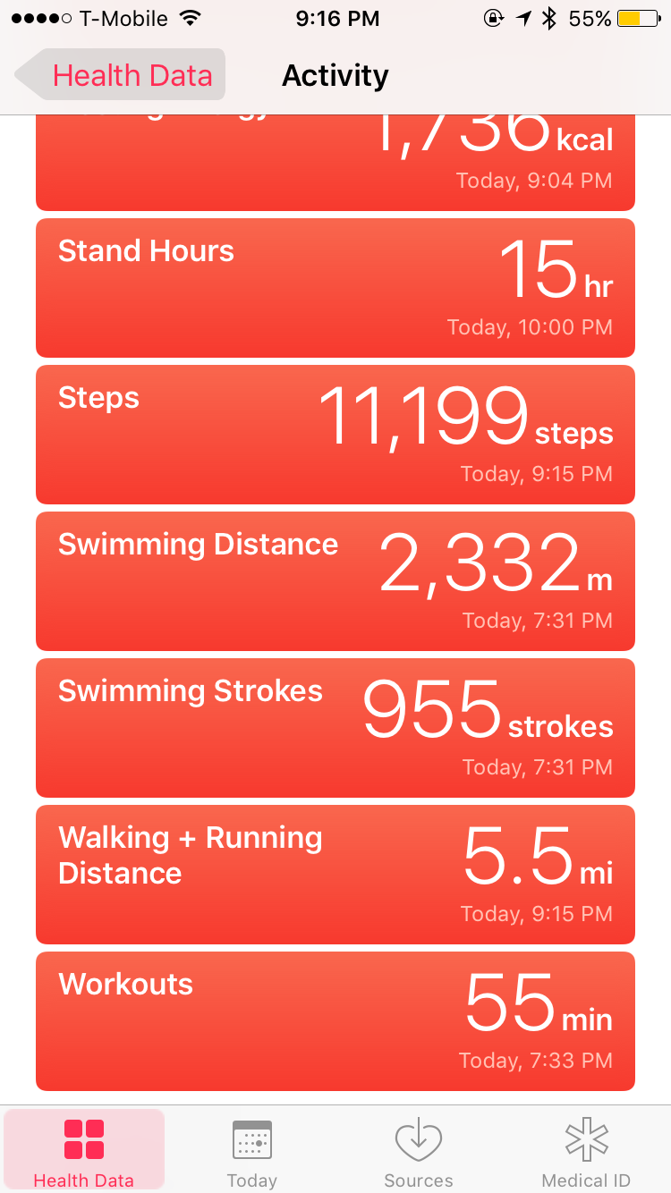

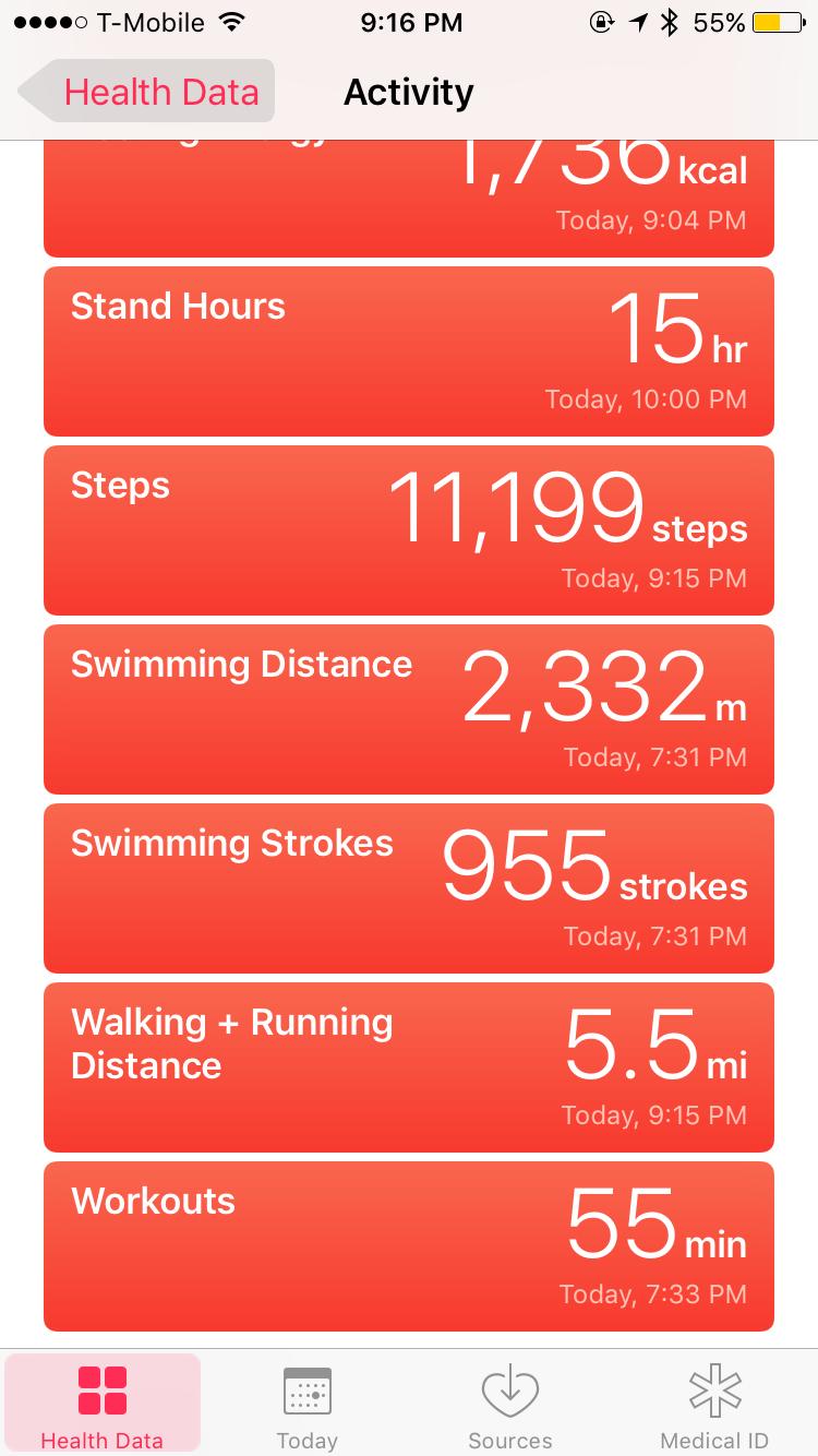

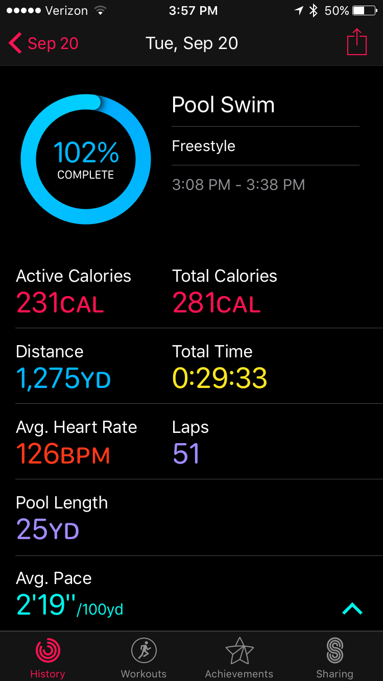

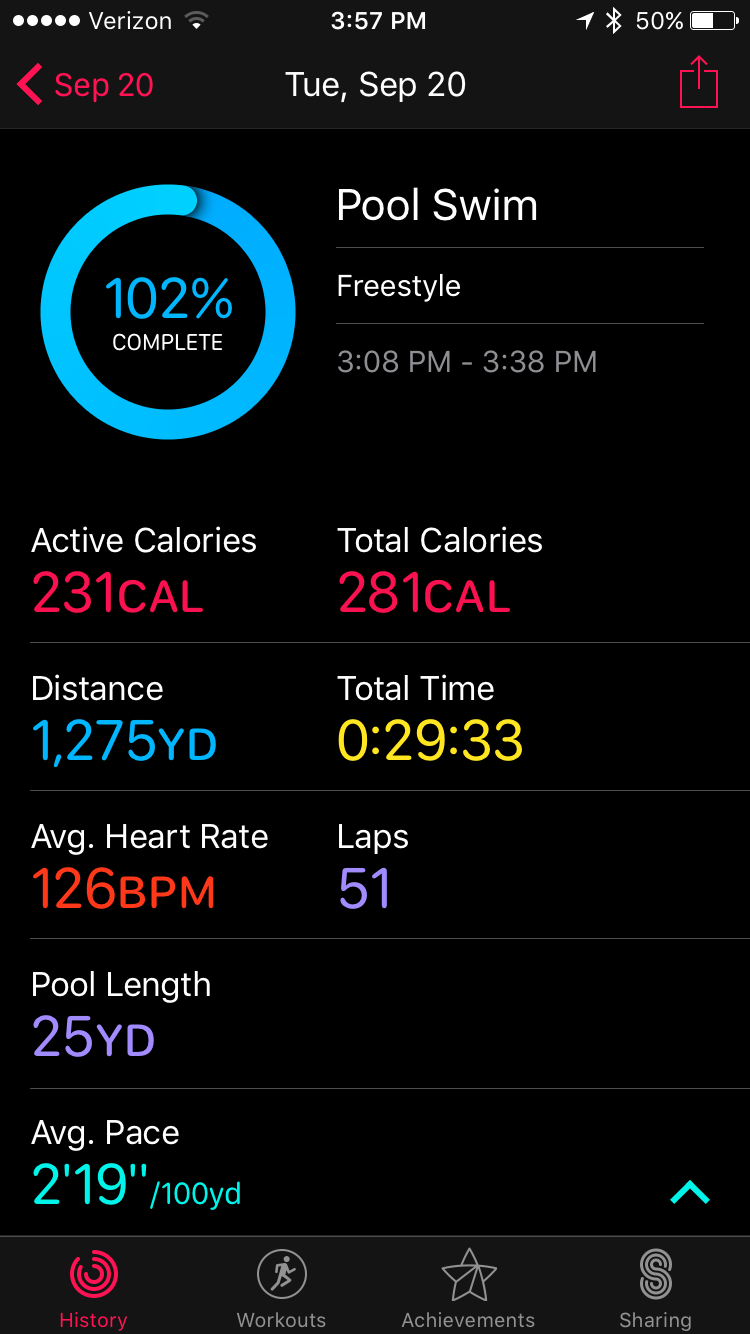

Here's an example of the data you get logged in the Activity and Health apps from a swim workout. Maybe not as much info as you were hoping for, but with OS 3 it could be possible for a developer to make a dedicated swimming app with even more features.

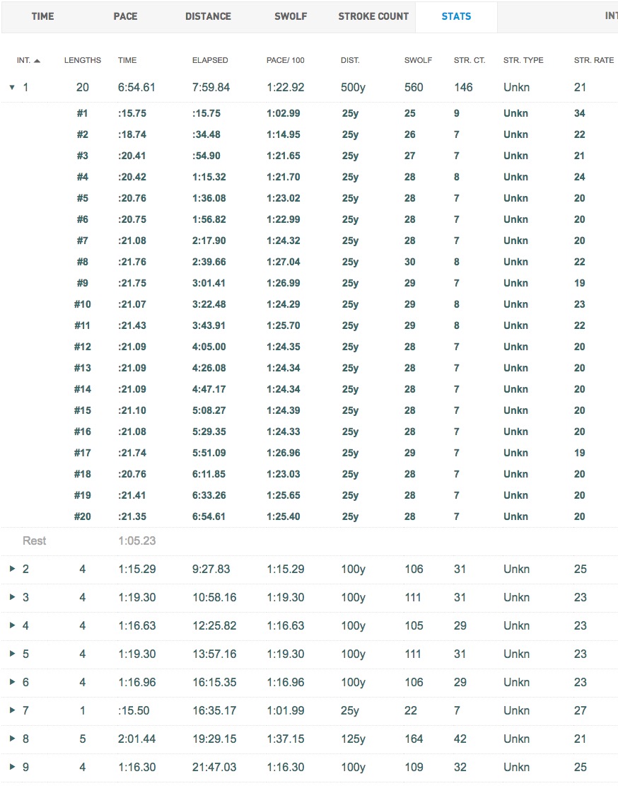

In case you haven't seen it, here is the type of data that it captured swimming with a pebble time.
The Swim.com presentation is excellent. It is pretty much exactly what I look at after every swim workout for every interval, and sometimes down to length when I am curious how I trended within an interval:
  • Interval time
  • Interval distance
  • Pace /100
  • Strokes
  • Stroke Rate
  • SWOLF
