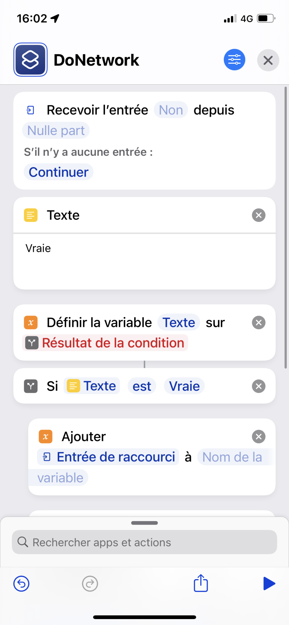

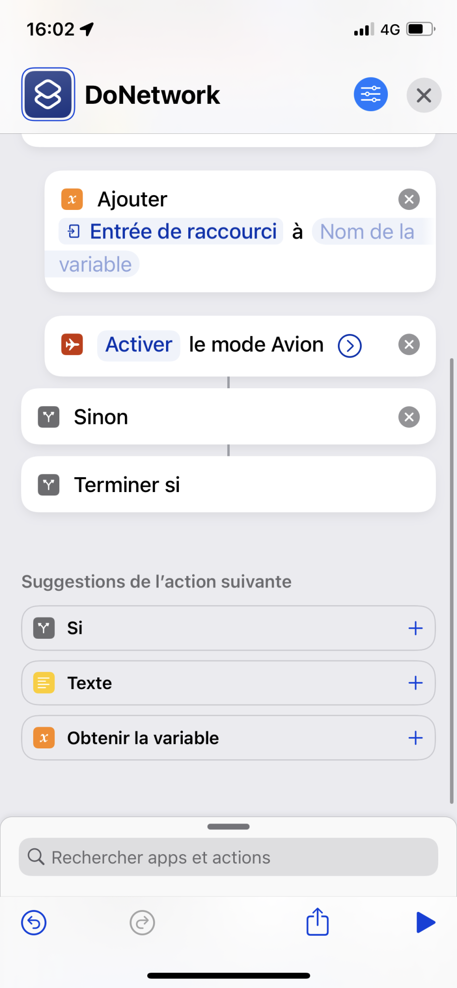

I'm really sorry but I have a French version of shortcuts and I feel like I can't launch a script feature to edit code text, could you show me a concrete example, I can't find much on YouTube to help me

Okay, thank you very much but I don't know how to nest my variables... I don't know how to write my script, the modules to use, the function If... I'm lost in the method to follow could you show me an example?
I would be very grateful
From your post #13 it looks like you were able to create a Shortcuts..
Yes, I know how to create it but then I don't really understand how to nest my functions with each other...
