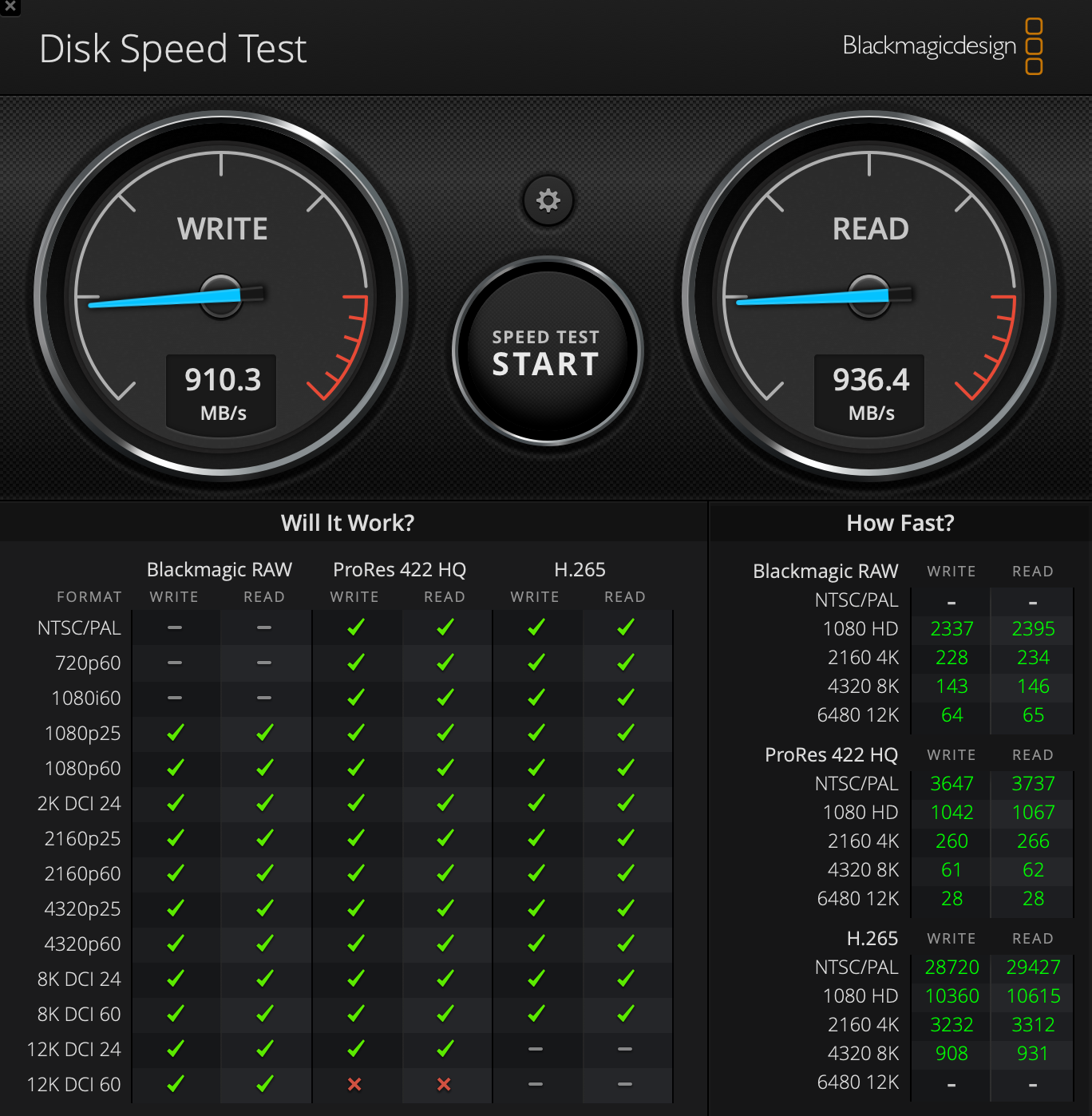

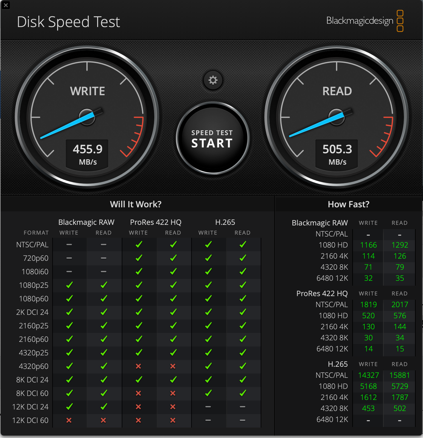

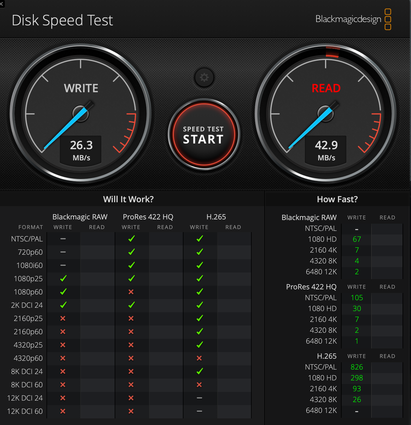

I have done dozens of these upgrades now, but to do the first one, without breaking anything, would be stressful. You can get even more speed by using an external usb 3.1 ssd than an internal one, so thats a viable alternative .....

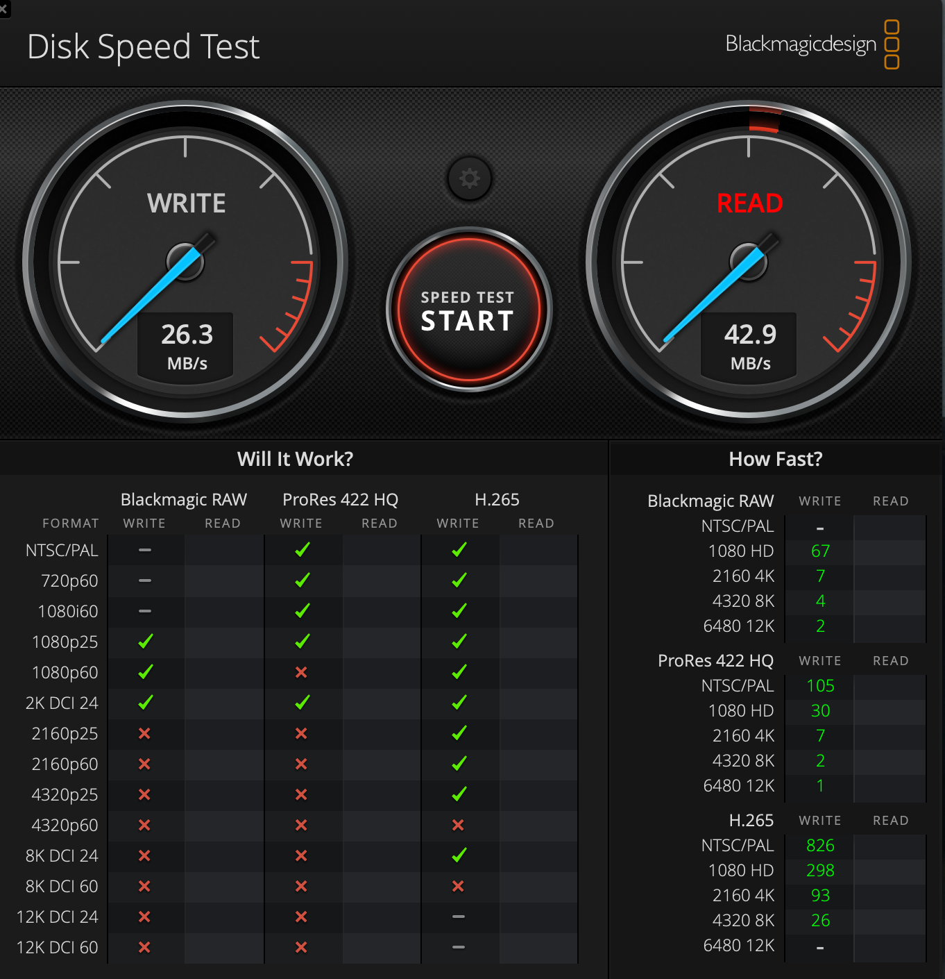

this is the original spinner in a 2017 after 4 years .....

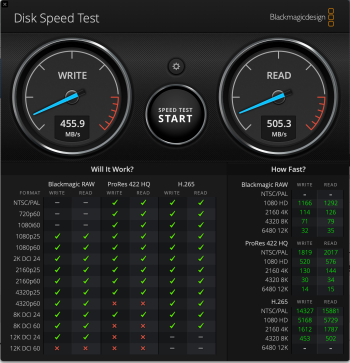

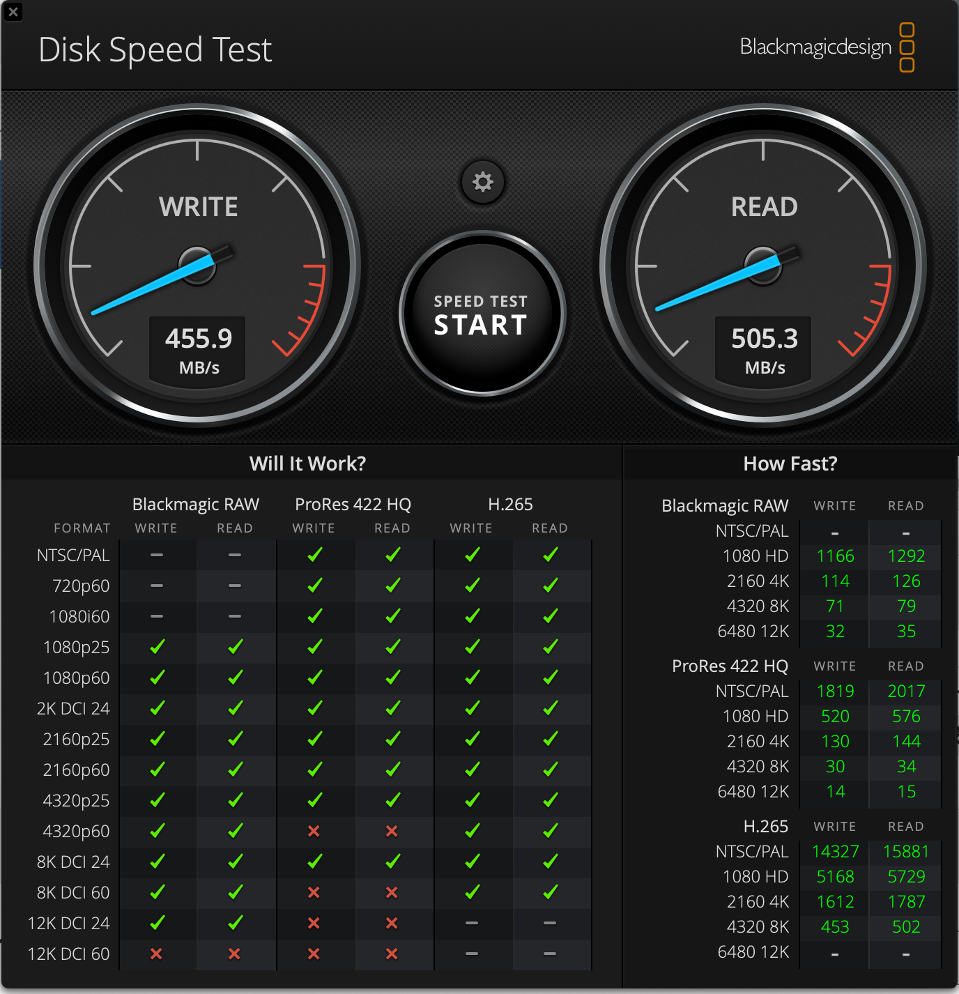

this is an internal 2tb crucial ssd :
and this is an external usb 3.1 blade ssd on the TB3 bus:
